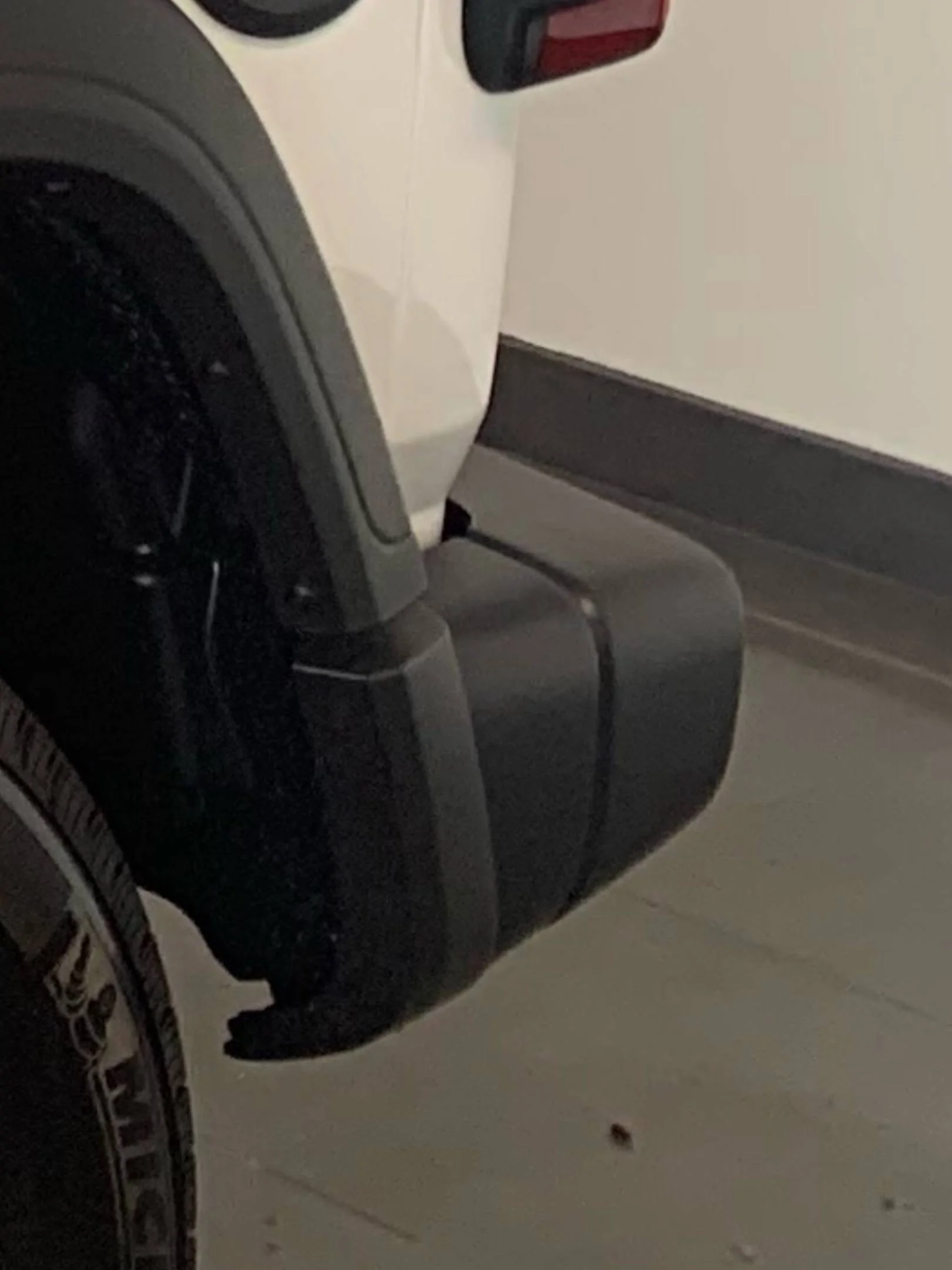

Do your new fenders have ANY clips? You can always swap clips from your existing flares, but you won’t know how many you’ll have available until you see how many you didn’t break off ?. I counted how many I knew I had to replace, then picked up a bag just to be sure I’d have enough before I started pulling off the old flares.
In terms of tips, the process is pretty straightforward, assuming your starting point looks like the image below. Just be prepared for the violent “cracking” sound you’ll encounter when you start pulling. I recall watching a couple YouTube videos which were helpful. Good luck!
