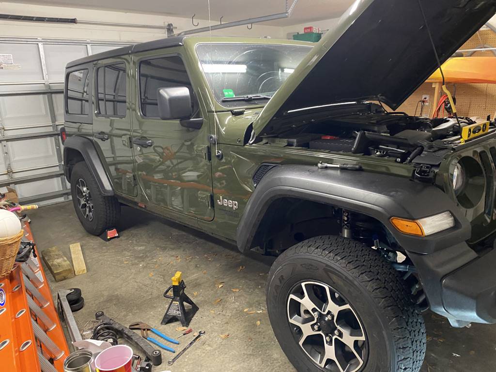

I know that I'm going to get a bit of drama for this post, but here I go. :) Yes I've searched the forums every night for the last 2 weeks.
I've lifted my Tundra for weeks before by the pumpkin and putting the rear axle on my old school Sears Craftsman 4 ton stands that go to 17 5/16". Toyota utilizes a 3rd member design and recommend lifting it by the pumpkin (in the rear).
Jeep seems to not recommend lifting by the pumpkin and in the front it is off-center, so I figure that I'll frame lift it by each side and place the jack stands where the pictures indicate on the install instructions.
My questions are:
1) is 17 5/16" high enough of a jack stand to install the Mopar lift? I am getting a second pair of stands to support the axles from a friend.
2) where would you lift up each side of the Jeep to place on stand behind the LCA as indicated in the install instructions?
3) any helpful hints from those who have installed this lift before?

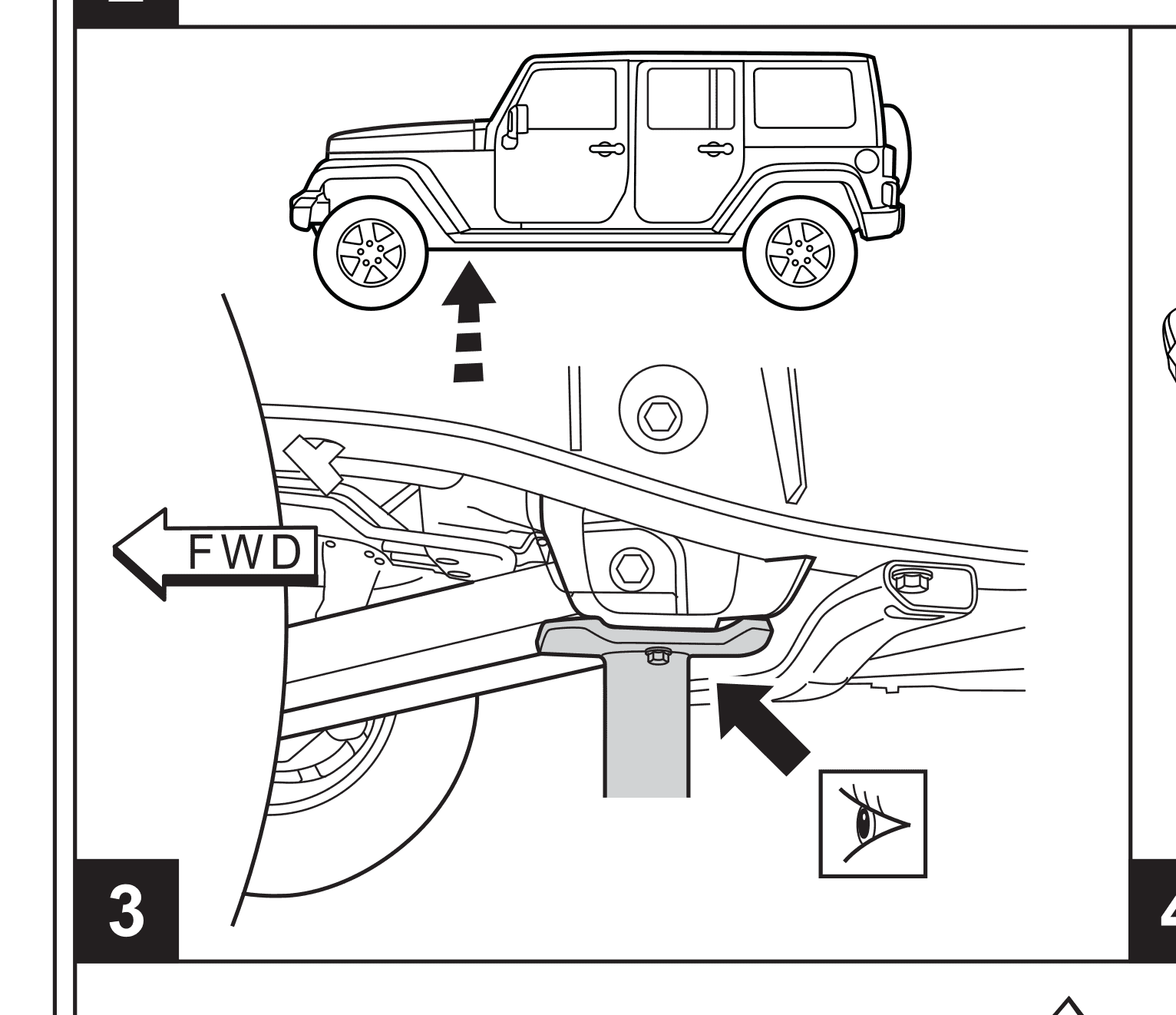

This has to be the worst picture ever. It appears that Mopar is indicating to place the jackstand under the LCA. So if I place it there, how do I remove the LCA? I can't go behind it because that bar is there. Does anyone have any hints on positioning this jackstand?
Set the jack stand so that it's saddle is cradling the frame rail right behind that crossbar. It'll support the Jeep rock solid, while allowing some elbow room to work.

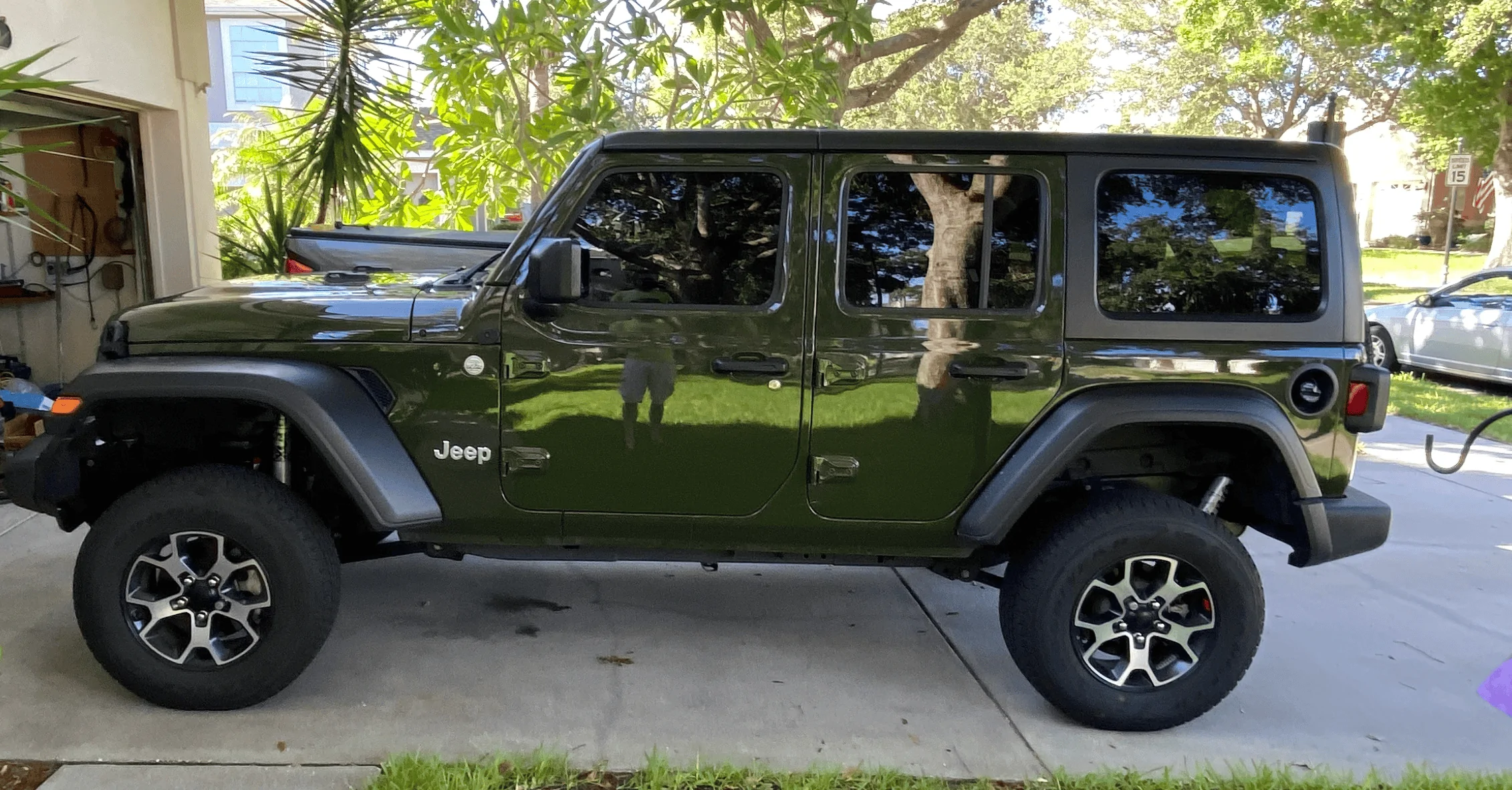

Updated:
I have the only squatted Jeep in Melbourne, FL. :)

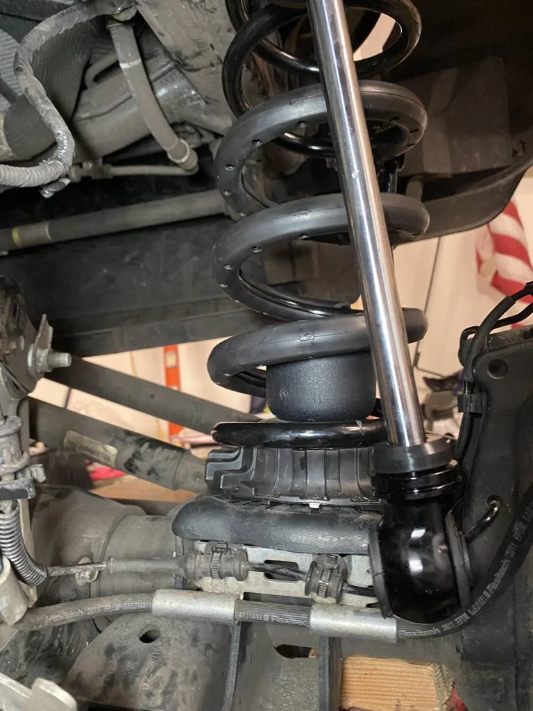

I learned a lot, my only real major setback was on the passenger side I noticed that the spring sat on top of the correction pad as opposed to around it in the back (right before putting the tire on). I had to redrop the axle enough to properly locate the spring. Below is a picture of the correction pad after dropping the axle and before fixing it.
