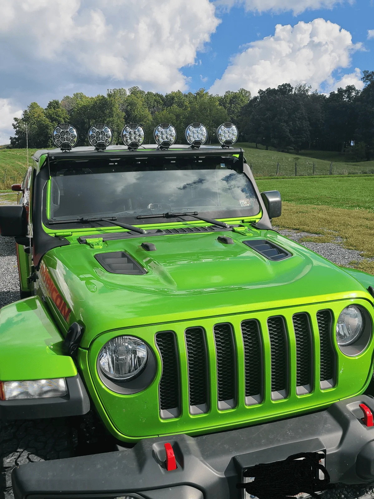

Has anyone installed this set from KC? I received this from KC, and it is not exactly what it claims. It is supposed to have a wiring harness to "plug and play" all 6 lights, but instead it comes with 3 harnesses that do 2 lights each. the amount of wire is insane, and there is way too much of it to conceal in the xross bar, not to mention that I don't want 3 separate switches for one light bar. I plan on ditching the KC harness and wiring the lights daisy chain and land them on my number 1 aux switch replacing the fuse from a 40 amp to a 30 amp. has anyone had any experience with this?
The lights are 50 watts so I am calculating 25 amp draw with all 6, so I am figuring 12 gauge wire with a 30 amp fuse. Photo of the lights installed with out being wired yet.
Thoughts?
