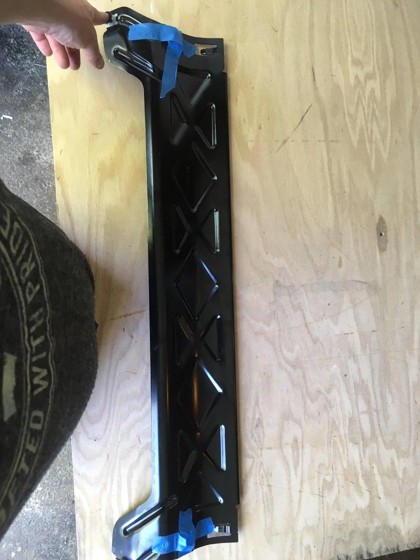

This is a picture of the "steel skid shield" or "front metal air dam." Masking tape keeps its two bolts with the device so I don't lose them. My finger points to where 1 of the 2 metal bolts of the plastic air dam screw in. Its rigidity keeps the air dam from rising or lowering in the back.
Jeep Wrangler JL Installing a Front Hitch on a JL IMG_2239

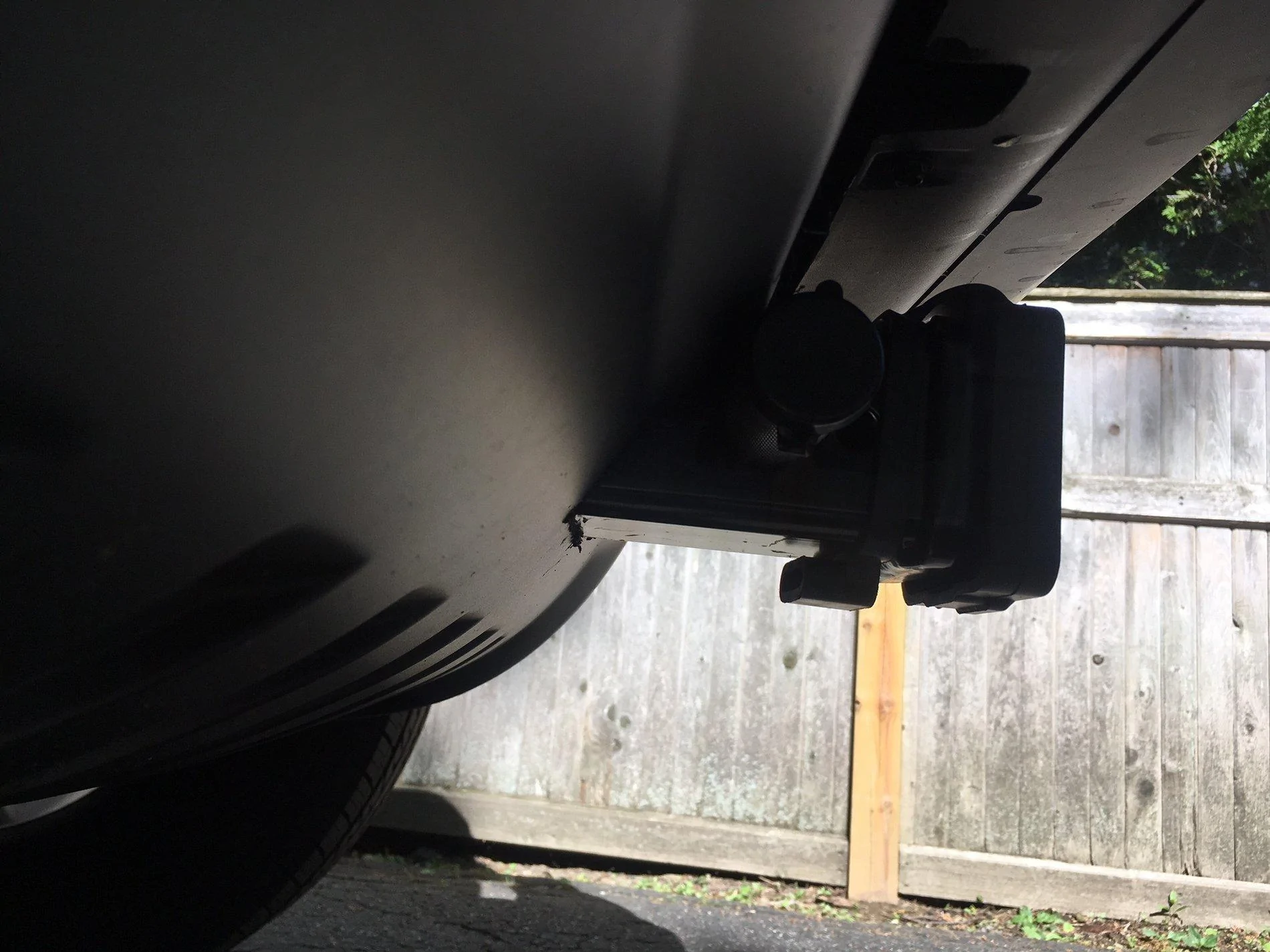

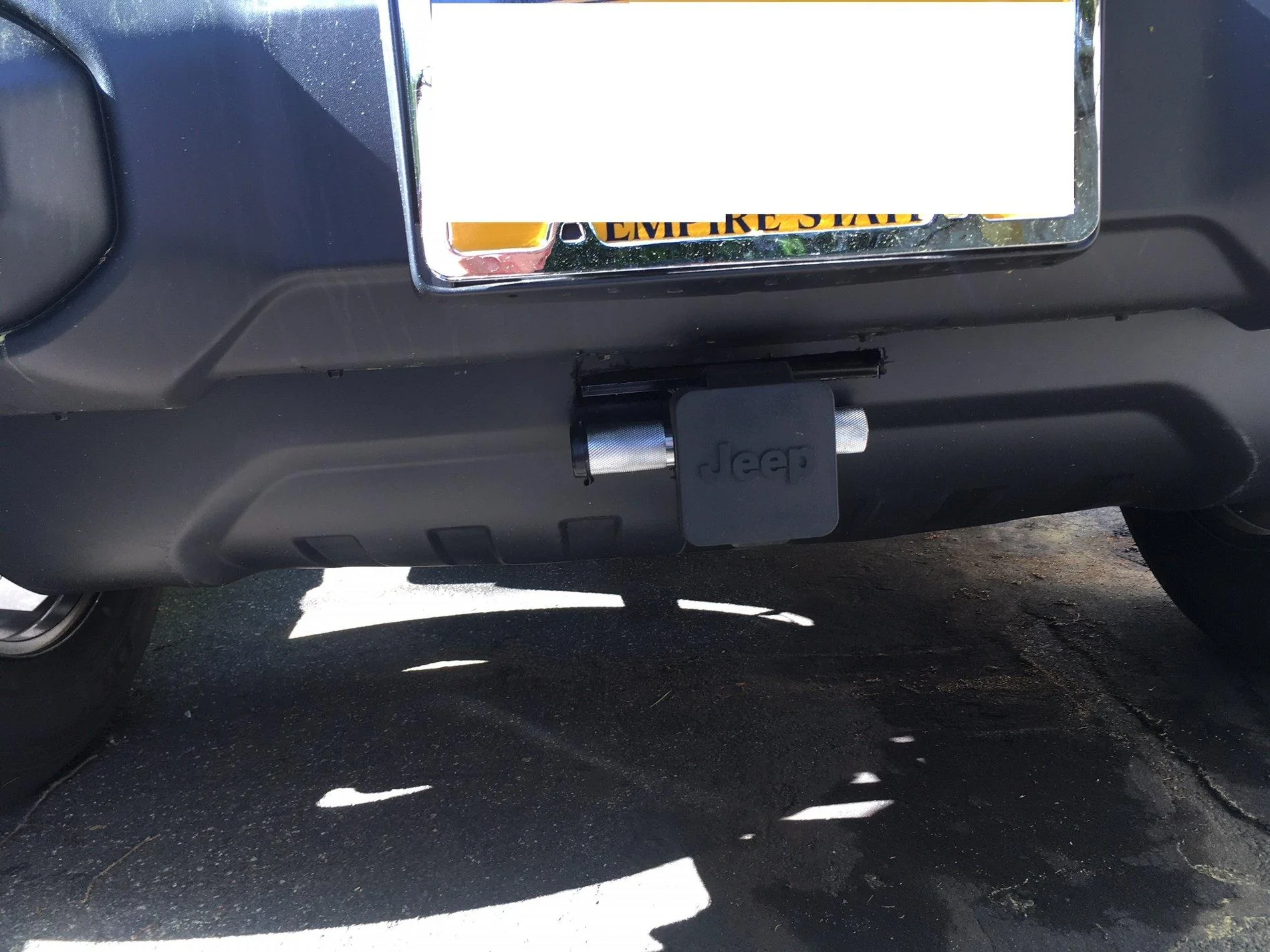

I take portions of a wire hanger and attach it to the hitch cover, looping the hanger behind the hitch pin hole. The locking hitch pin then sits in front of this wrap around portion of wire hanger and makes removing the hitch cover impossible short of destroying it.
For some reason I can't explain, people think its okay to steal hitch covers like they were collector's items or something.
Jeep Wrangler JL Installing a Front Hitch on a JL IMG_2245
Behind the side view of the front hitch lies a fence post that has nothing to do with the image.

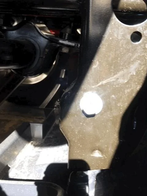

The following isn't a great picture, but it seeks to show how the aforementioned 90 degree bent threaded rod is secured at one end into a hole in the chasis, and at the other end into the passenger's side (one of two holes) hole where the 1 of 2 metal bolts in the back of the plastic air dam use to screw into the "steel skid shield" or "front metal air dam" that's now been removed to accommodate the front hitch
Jeep Wrangler JL Installing a Front Hitch on a JL IMG_2246
