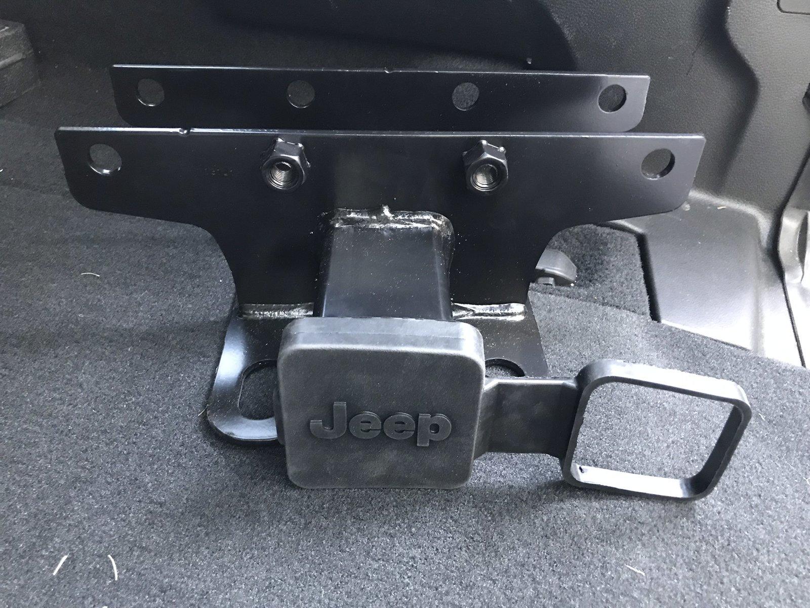

I thought I’d share an installation video for anyone looking to install the wiring harness themselves. I found it on YouTube. It was a life saver. The harness instructions were horrible, but this video was a great step by step.
I also have a spare Mopar hitch receiver with cover if anyone’s interested. Bought for $180, will ship for $120 OBO.

FYI the hitch has been sold.
