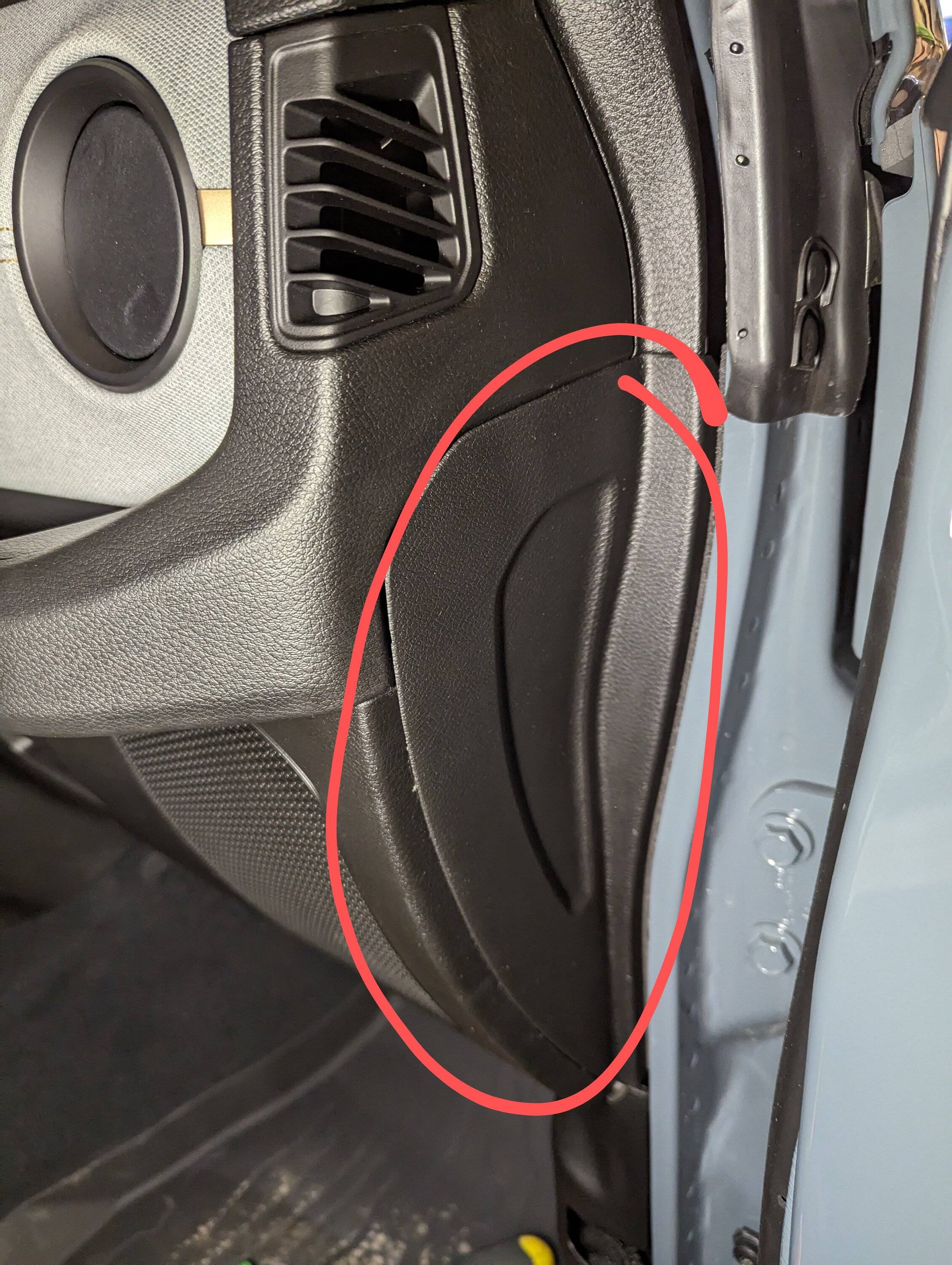

First pop off this side panel:
Jeep Wrangler JL Installed Start-X remote start on 2024 Willys 1000004892

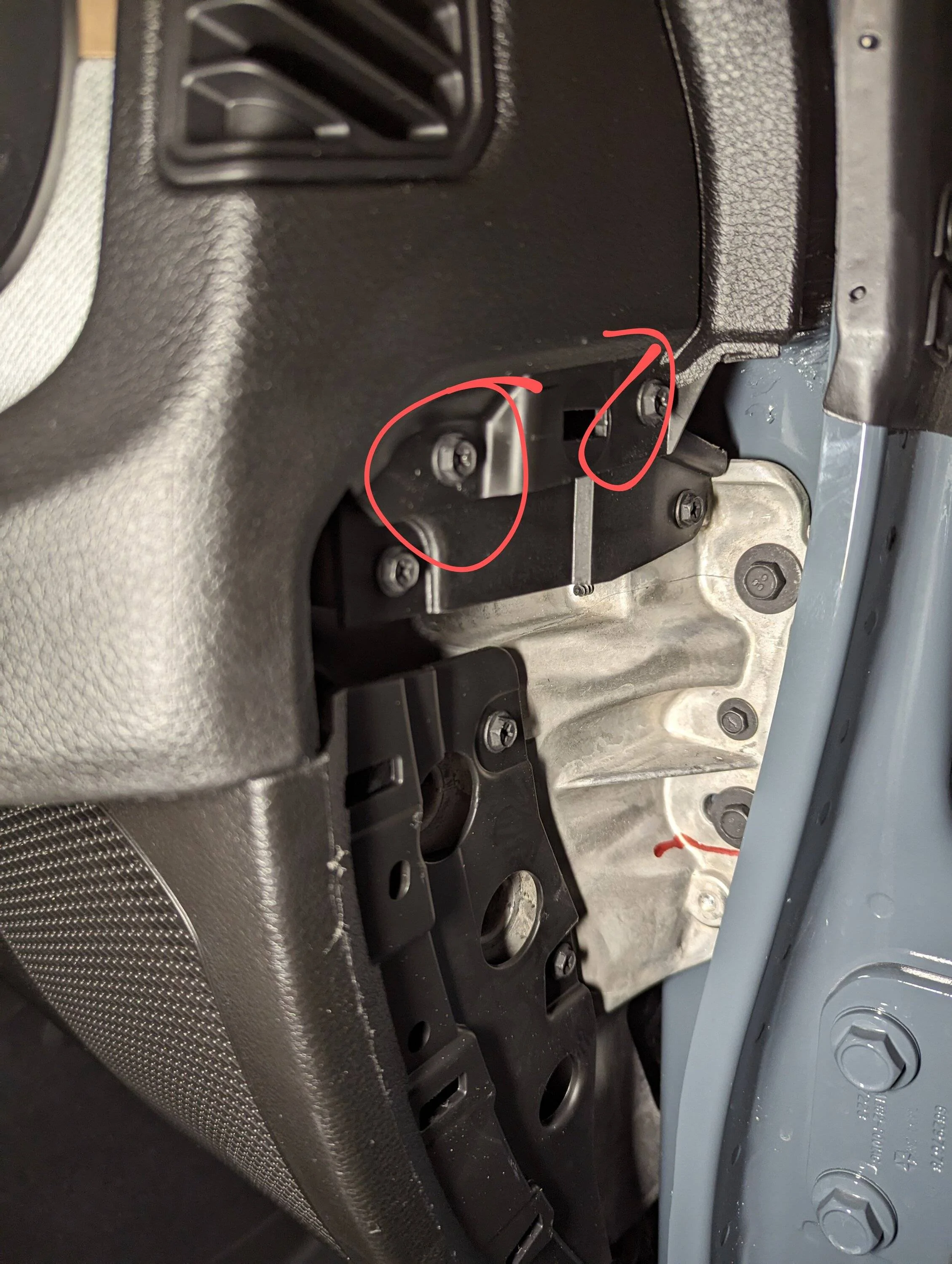

Then remove these two screws:
Jeep Wrangler JL Installed Start-X remote start on 2024 Willys 1000004893

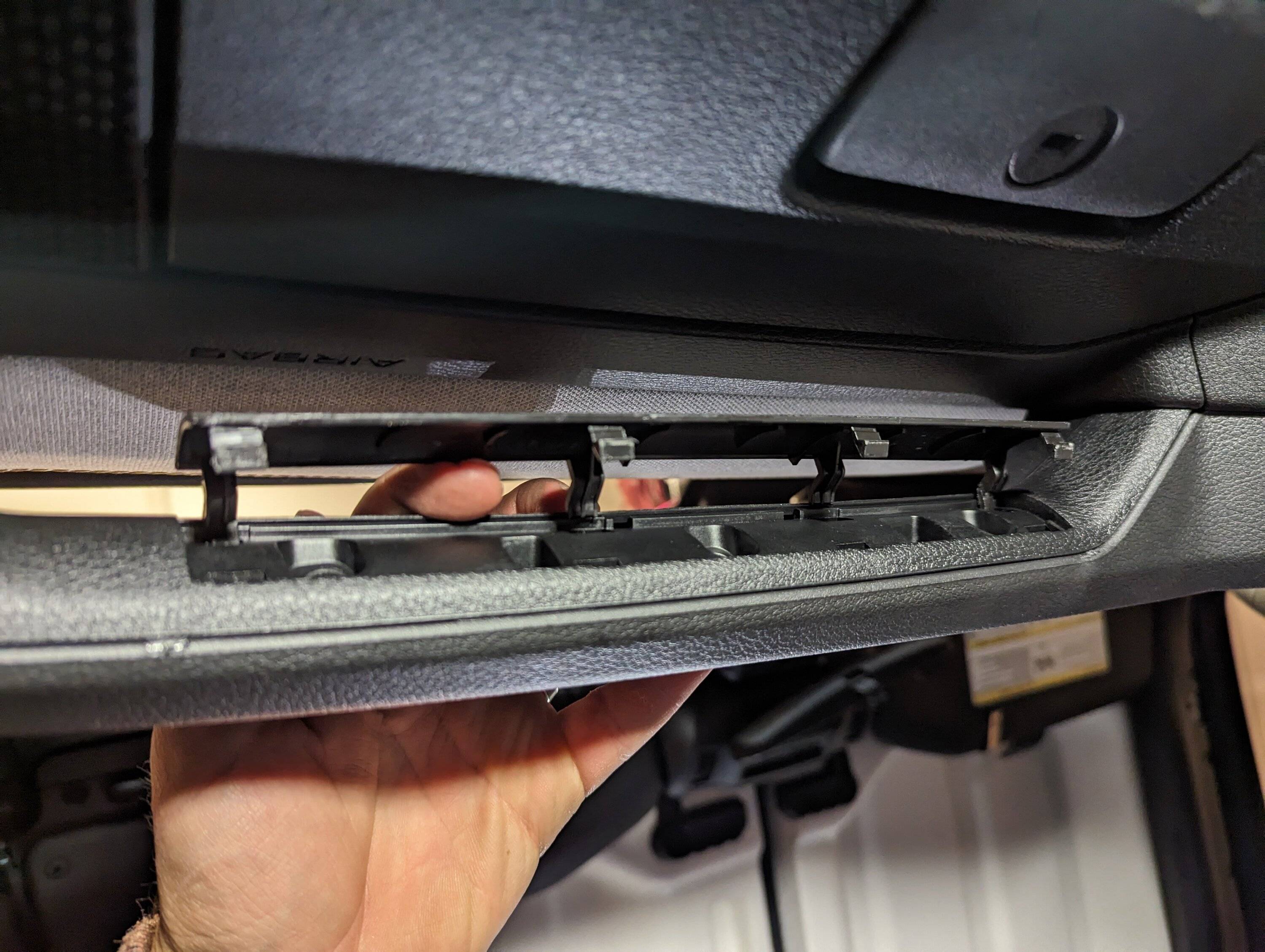

Then pop open the backside panel on the passenger grab bar:
Jeep Wrangler JL Installed Start-X remote start on 2024 Willys 1000004895
