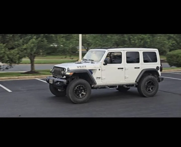

I just had them installed on my 2024 2.0 willys, im very happy with it but only one thing the back is sag giving me uneven look. Gained 3.5" front and 2" back which i expected. Which of these two .5 or 1.5 leveling kit fix the sag?

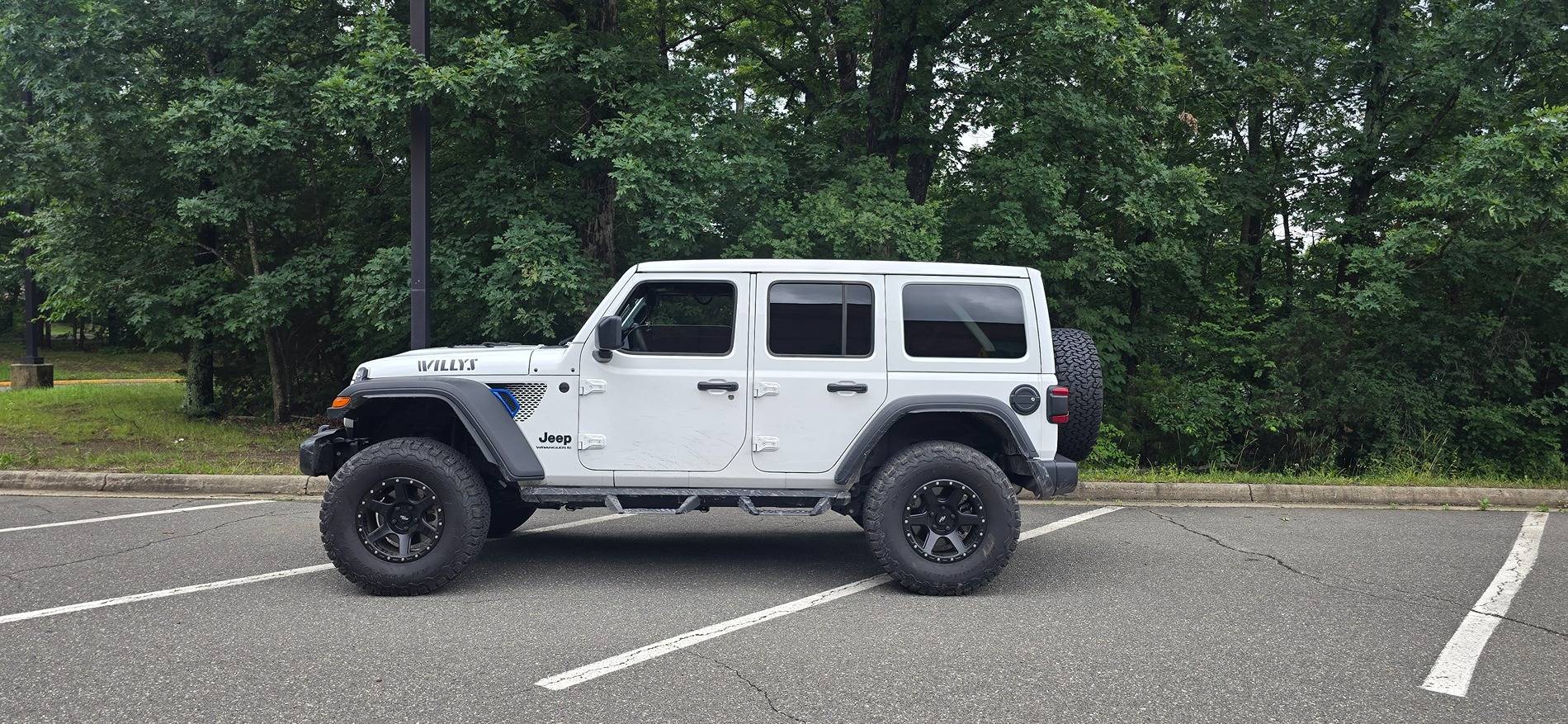

We've got a couple of threads on this already. I have the same springs on my JLUR 2.0. IIRC I gain 2-3" in the front and maybe 1.5-2" in the rear.
The front might come down with some miles, but the second you add a bumper and a winch, you'll be glad you started with some rake.
Remember the high clearance fenders are taller than the rear, this is normal.

My measurements

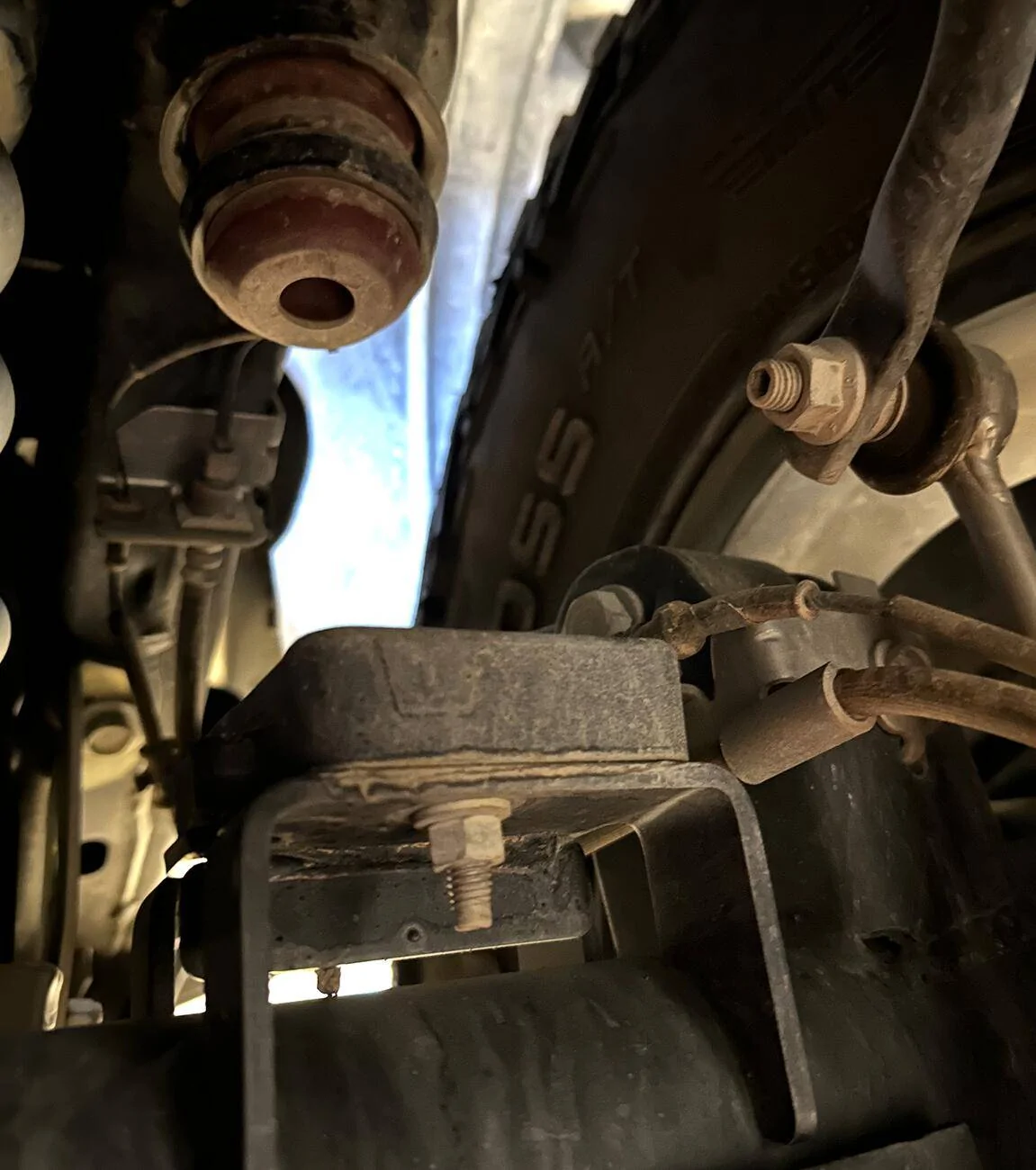

Here are some of the factory spacers:

I put mopar LCA, adjustable front track bar and rear trackbar relocation bracket. My solution for rear sag is leveling kit not but sure if i should go with teraflex .5" or 1.5".

My 2024 392 with winch had:
Springs: 68544179AB, 68540222AB, 68540231AA, and 68540230AA
Shocks: 2x 68602921AA, and 2x 68602920AA
LCAs: Don't know anymore
