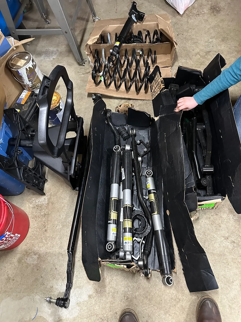

I’ll have to take a picture but I got a ton of stuff. Tried to pay and because I’m a fellow veteran he just gifted it to me. He said if I’d have hit him up a week earlier he’d have given me his 392 take off wheels and 37” nittos for free too. He said I can have his brakes and calipers if they’ll fit my sport. He went to the TeraFlex big brake kit. And Gamechanger 3.5”
