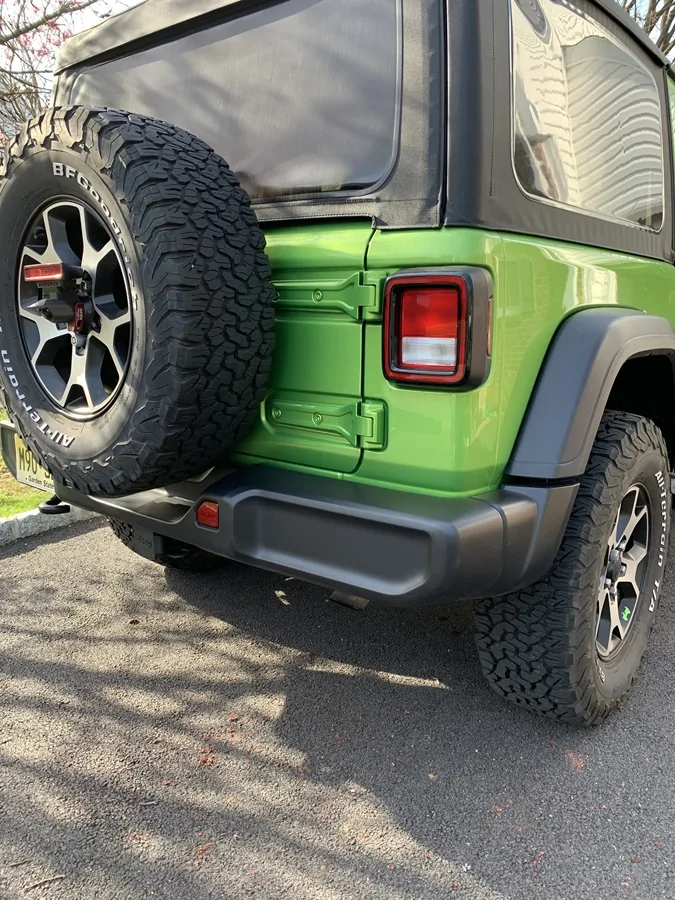

Jeep Wrangler JL Identical rear bumper replacement (non) mod? IMG_2945
Some time in 2024 a landscaping truck dented my original bumper, so I found a guy on Marketplace selling a cheap Sahara bumper. Easy swap. I was looking for one anyway because I knew at some point I would upgrade to the high-top flares and would have to change the endcaps as well. As you mentioned though, I searched for a while before I found one without the parking sensor holes.

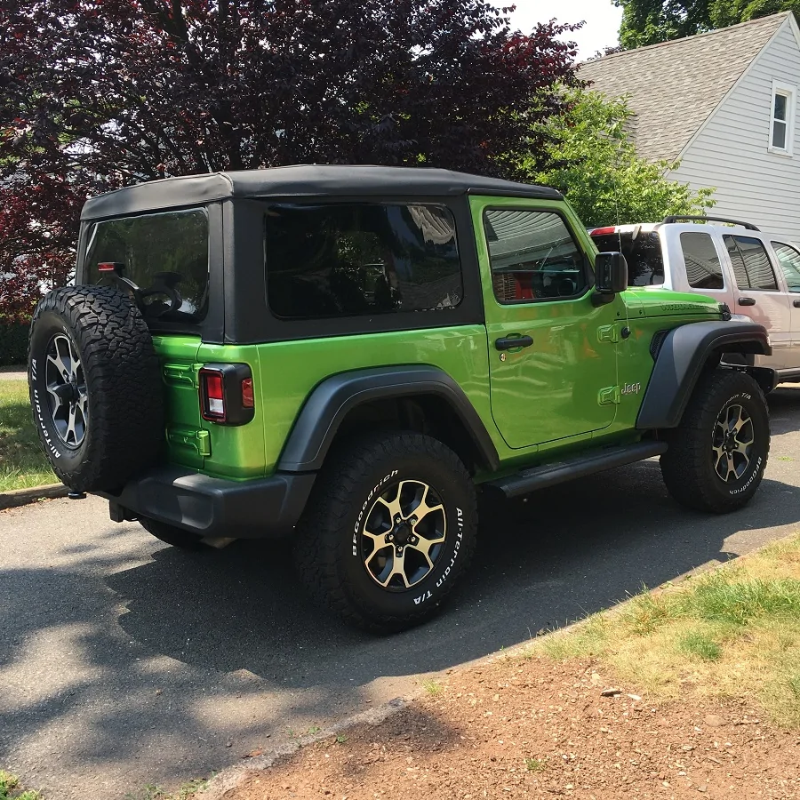

Jeep Wrangler JL Identical rear bumper replacement (non) mod? IMG_7056
After I picked up the high-top flares I struggled for a while to find Rubicon end caps. Note the mismatched corner on the side close to the tire.

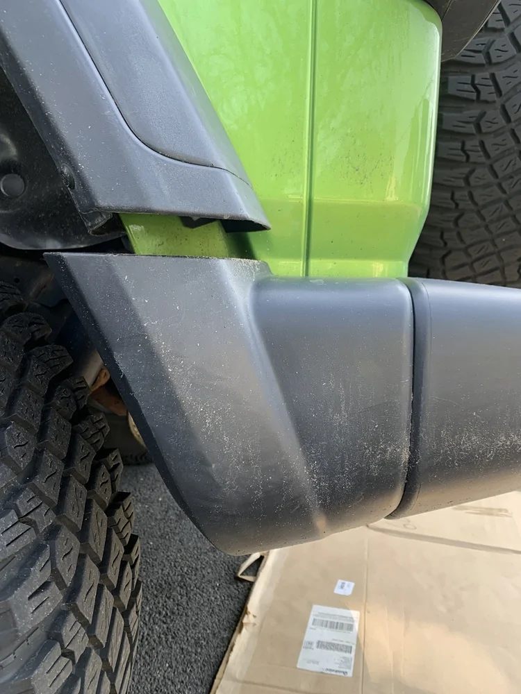

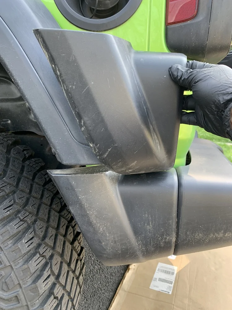

Jeep Wrangler JL Identical rear bumper replacement (non) mod? IMG_8131
Eventually I scored a rear bumper complete with endcaps from a fellow forum member. That one had the holes for the parking sensors, so I reused the bumper that was already on my Jeep and changed the ends. Here's a comparison between the Rubi (top) and Sahara (bottom) end caps.

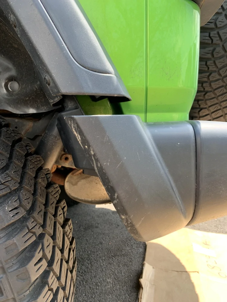

Jeep Wrangler JL Identical rear bumper replacement (non) mod? IMG_8132
After the swap, everything lines up again.
