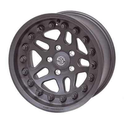

Trying to decide between three very awesome wheels.

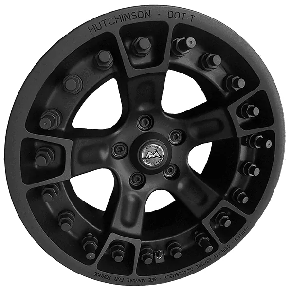

On one hand, there is Hutchinson. An amazing company with tons of history in the off-road world, offering super cool looking and highly funtioning two-piece double beadlock wheels. Specifically looking at WA-0594 or WA-2401.
Jeep Wrangler JL Icon VS. Hutchinson 1649353621822
0594 (Upper) or 2401 (Lower)
Jeep Wrangler JL Icon VS. Hutchinson 1649353761656
~Below is an example of Hutchinson's setup~
Jeep Wrangler JL Icon VS. Hutchinson 1649354520520

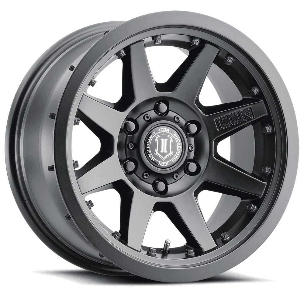

And then on the other hand, Icon Alloys come out with a new concept of innerlock bolts. keeping the outer tire bead fully secure, but with nothing to secure the inner bead. The benefits of going with this wheel though would be less weight, higher load capacity, and less cost. (I only wish they had a few other styles of wheel that had their Innerlock Technology, but for now this is the only wheel design they offer)
Jeep Wrangler JL Icon VS. Hutchinson 1649354075414

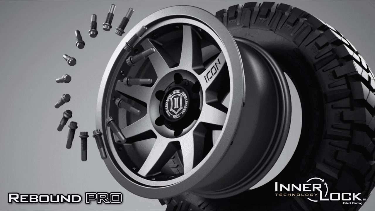

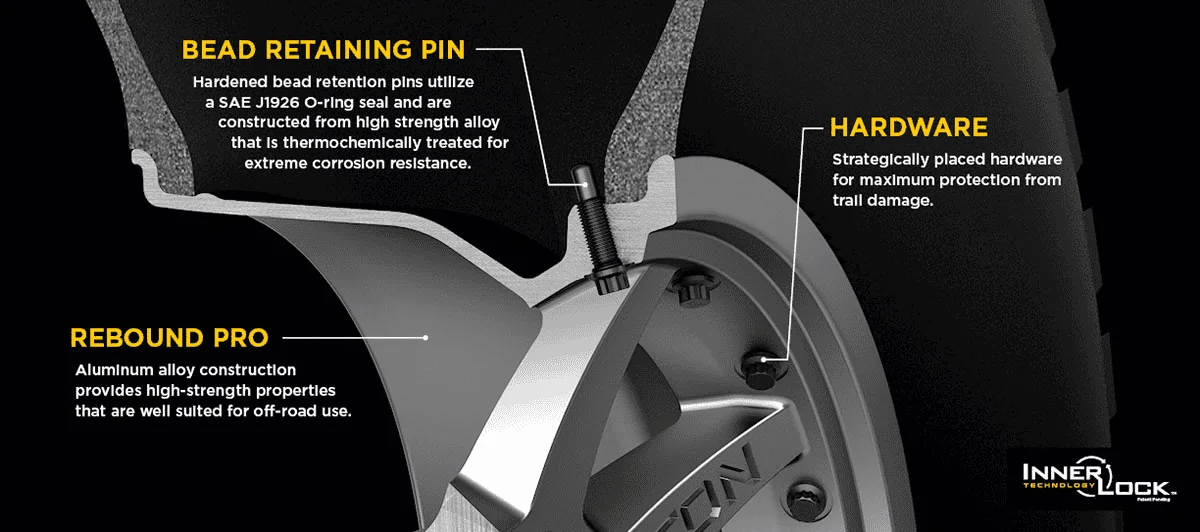

~Below is an example of Icons Innerlock Technology~
Jeep Wrangler JL Icon VS. Hutchinson 1649354019102
Jeep Wrangler JL Icon VS. Hutchinson 1649354031986

Hutchinson 0594 - weight 35.6 lbs - max load 2300 lbs - negative 6.6 mm offset - cost: $580 per
Hutchinson 2401 - weight 45.1 lbs - max load 2500 lbs - negative 13 mm offset - cost $590 per

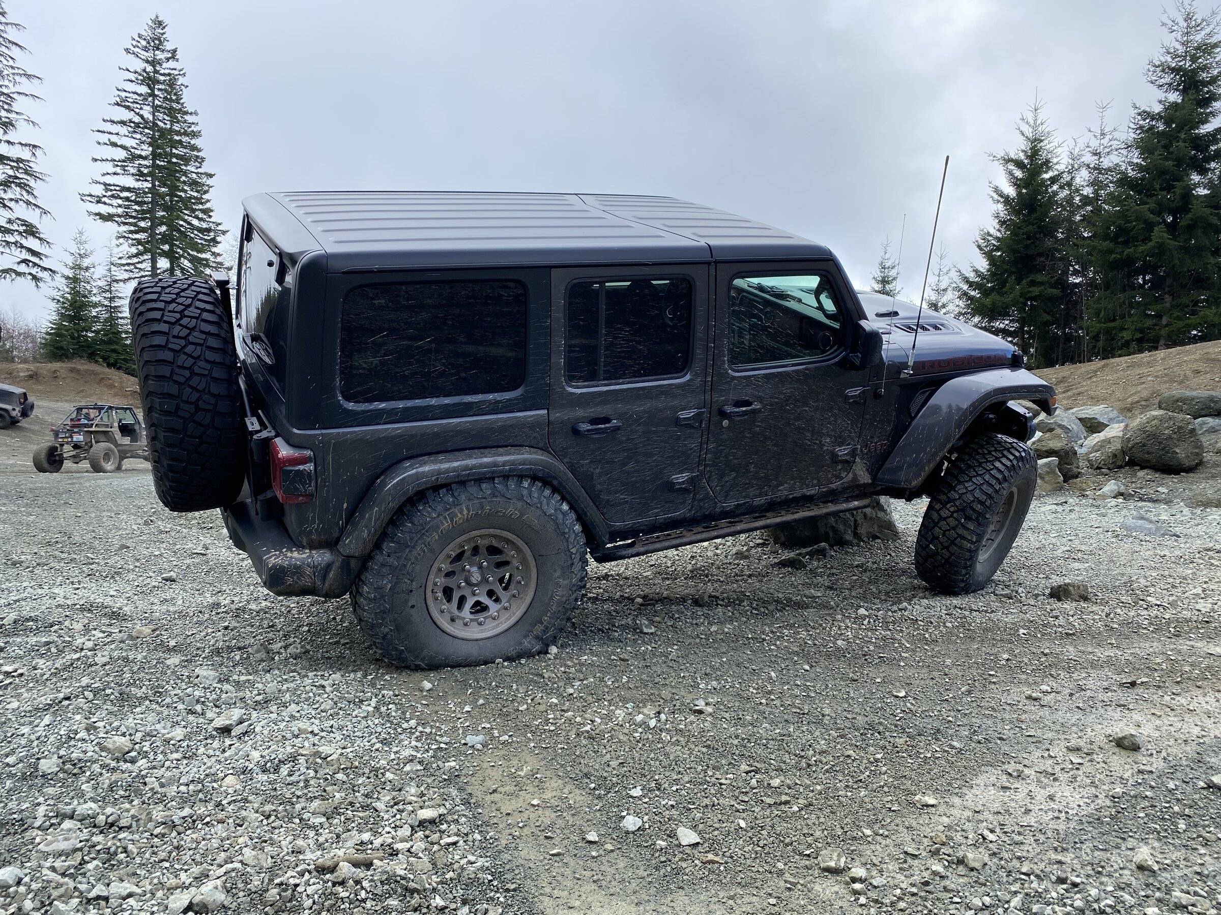

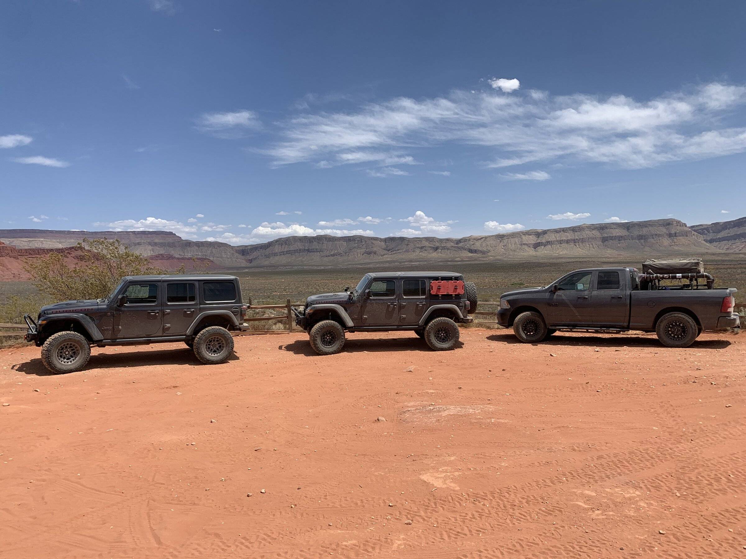

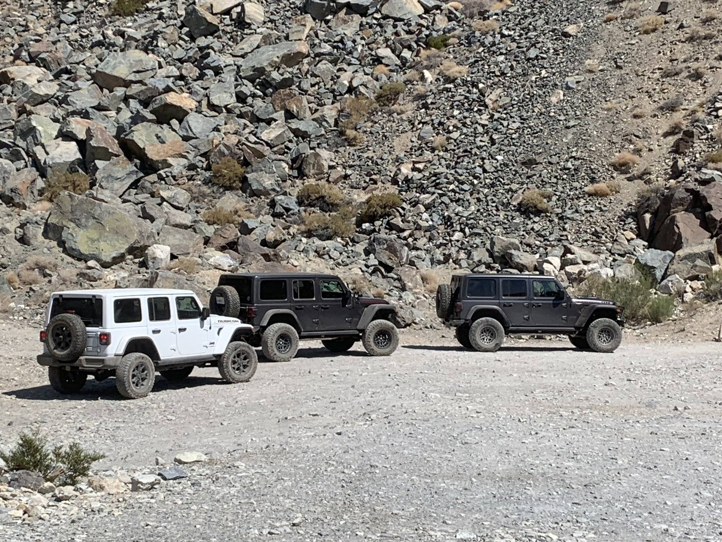

Love my Hutchinsons. Easy to mount and very stout. Installed the black ones on my friends Jeep as well.
Jeep Wrangler JL Icon VS. Hutchinson 042770E4-9DCB-407A-A45B-9138D1294864
Jeep Wrangler JL Icon VS. Hutchinson 90F84489-264D-4081-BDE0-E531AB7EF831
