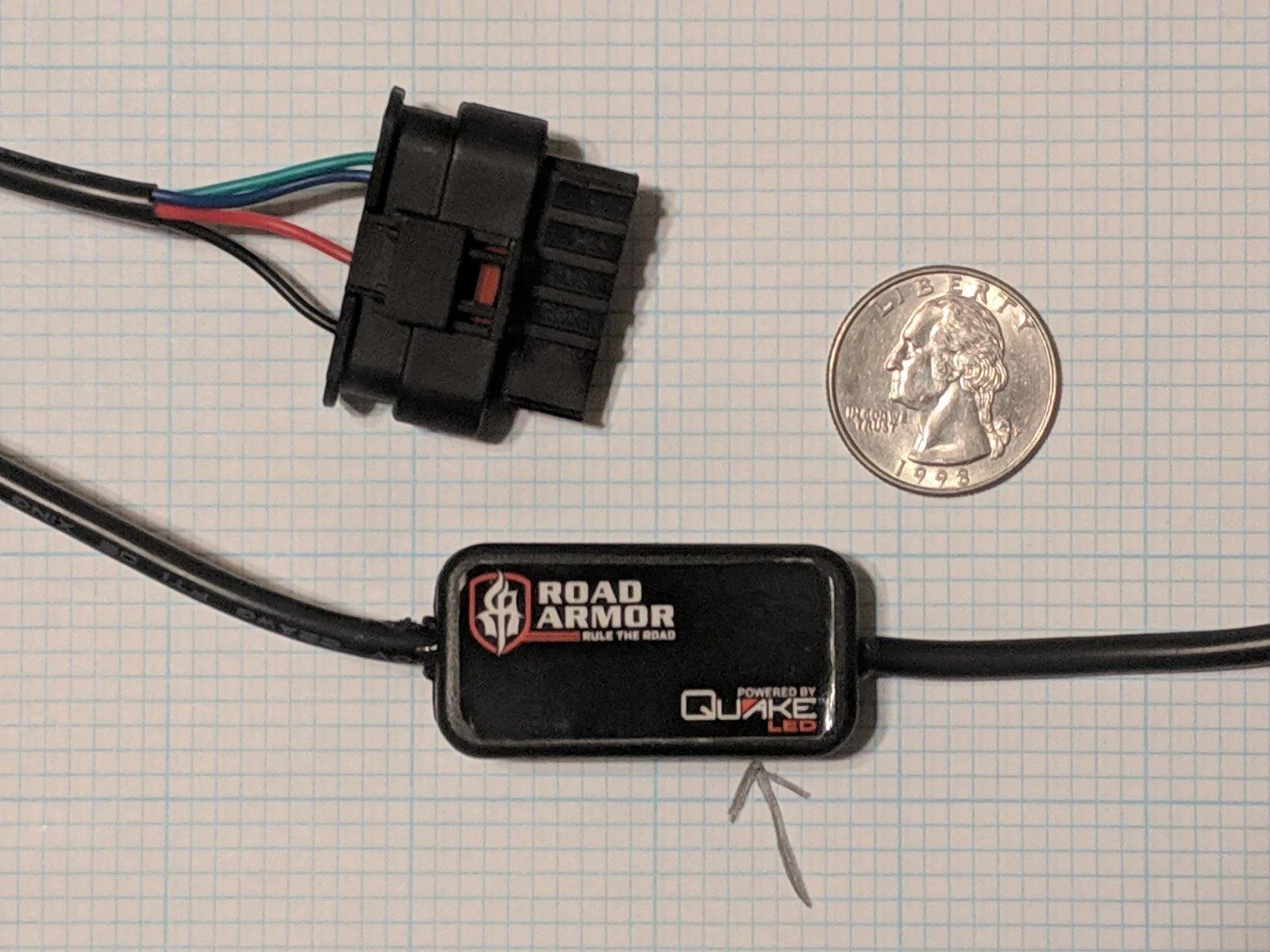

Solved!!
So, the LED package JL is not looking for the resistance of a bulb to determine if it is "burned out", because LED's have so little resistance. Instead the computer is looking for a special signal that is generated by the OEM light.
The good news is, Quake LED has figured it out and they have a solution available for us!
I have the Road Armor fender flares and they came with accent lights that are dual branded Road Armor powered by Quake LED.
It's a no cutting plug and play module that makes the computer happy :)
I can't tell what's inside because it's weather sealed with epoxy, but it works.
If I disconnect the Quake LED light I get hyperflash and the bulb burned out warning on the dash after about 20 seconds. Plug them back in and within the same amount of time the hyperflash is gone as well as the warning.
