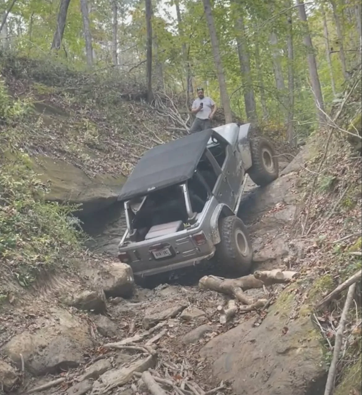

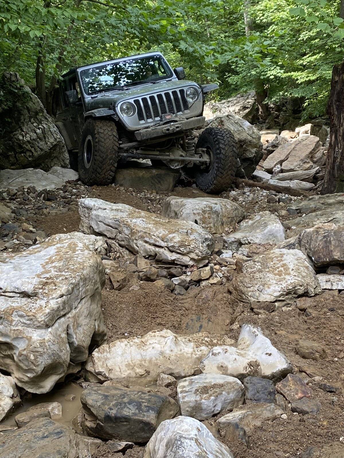

Thing just works. Drives 80mph down the highway to and from the trails. This was 300 mile one way trip 3 days on the trails and 300 miles back zero issues. I have been to Rush, Hollerwood, and wellsville with this setup and I believe it has helped tremendously. My power steering is cooler and it’s completely changed the off-road experience.
