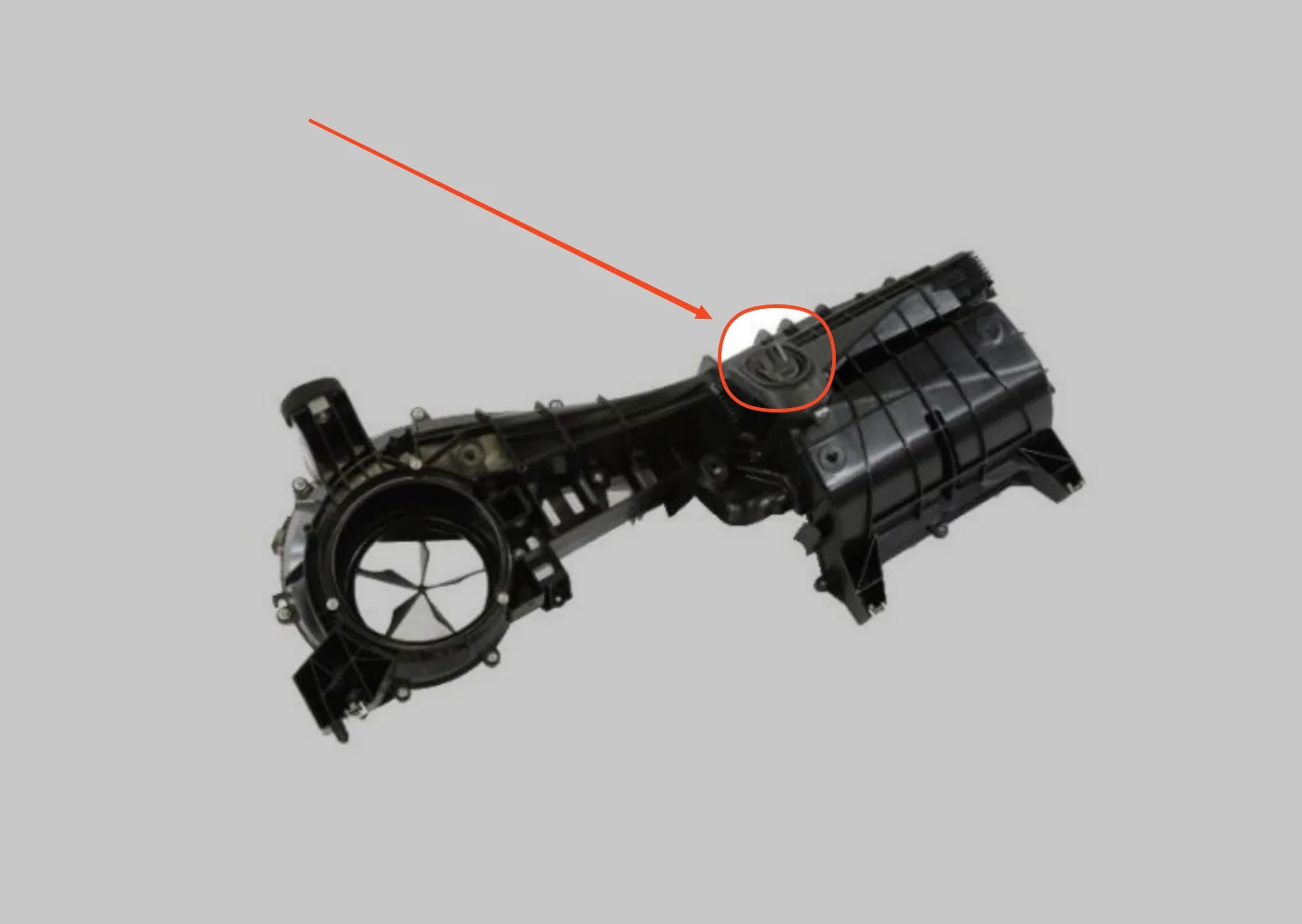

I have a 2020 Jeep Wrangler JLUR, and I have very few problems with it so far. But now I’m dealing with a frustrating HVAC issue. The JL’s HVAC system has an integrated drain that’s part of the solid HVAC housing (68301866AA) — there’s no separate drain hose or tube to replace.
In my case, the HVAC is leaking water inside the vehicle because the drain outlet inside the housing is broken and missing. Unfortunately, since this is part of the solid molded housing, fixing it isn’t as simple as clearing a clog or adding a tube —I’d have to replace the entire HVAC housing assembly just to fix the drain.
What’s puzzling is how this happened. My theory is that the drain outlet or part of it was cracked or weakened during assembly at the factory, but the broken piece stayed lodged in place and did the draining as normal — until it eventually slipped out or shifted, leaving an open hole that now leaks into the cabin.

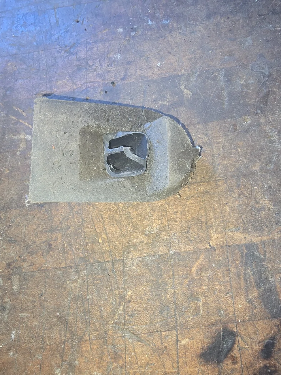

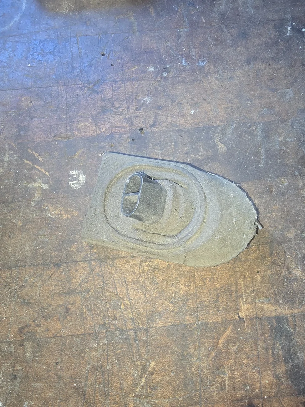

I have had this happen. Thankfully, mine was under warranty, but I can at least show you the part that you're going for you'll have to disassemble the -, but this is doable to replace, and the part itself isn't the costliest part. It's the time.
Hmm, it doesn’t really look like the part itself, more like a piece cut off of it. From what I can tell, I’d have to buy the whole housing unit 68301866AA ($450-$600) and replace it. And to do that, I’d need to drain the A/C and pull the entire front dashboard. Am I right?
