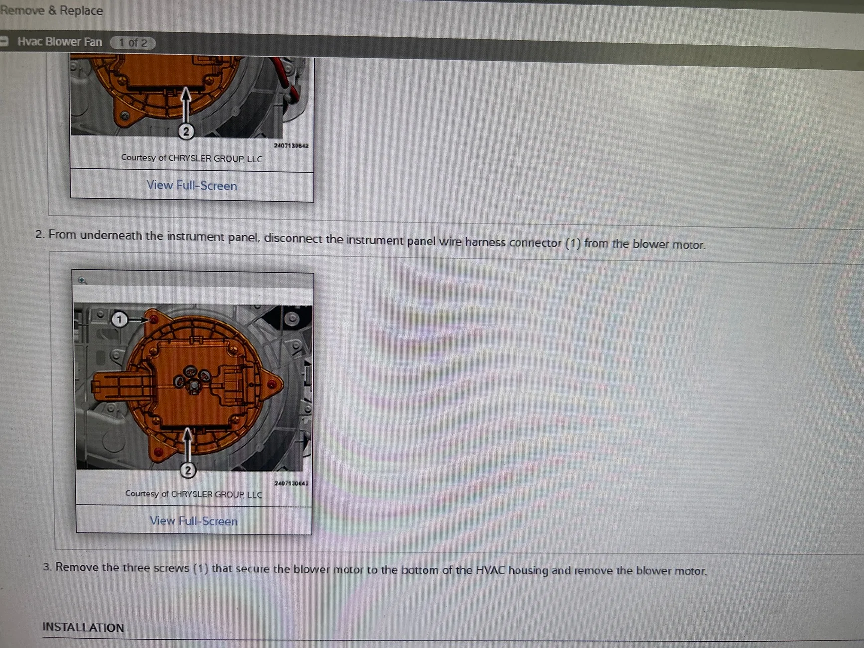

Bumping this up as I am having the exact same issue - recently replaced the filter, and now there is a hum/buzzing noise at higher speeds. Looking to remove filter, and potentially blower if sounds persists, to troubleshoot. Anyone have insight on how to complete this?
It could not be any easier. Just remove it, clean it, reinstall.
Any chance you have the instructions prior to this, such as accessing this area of the Jeep? Does this warrant the removal of the entire instrument panel, just the central console panel, etc.? Or is this in the passenger footwell, just looking straight up?
There is literally nothing else to it. Just look at it.
