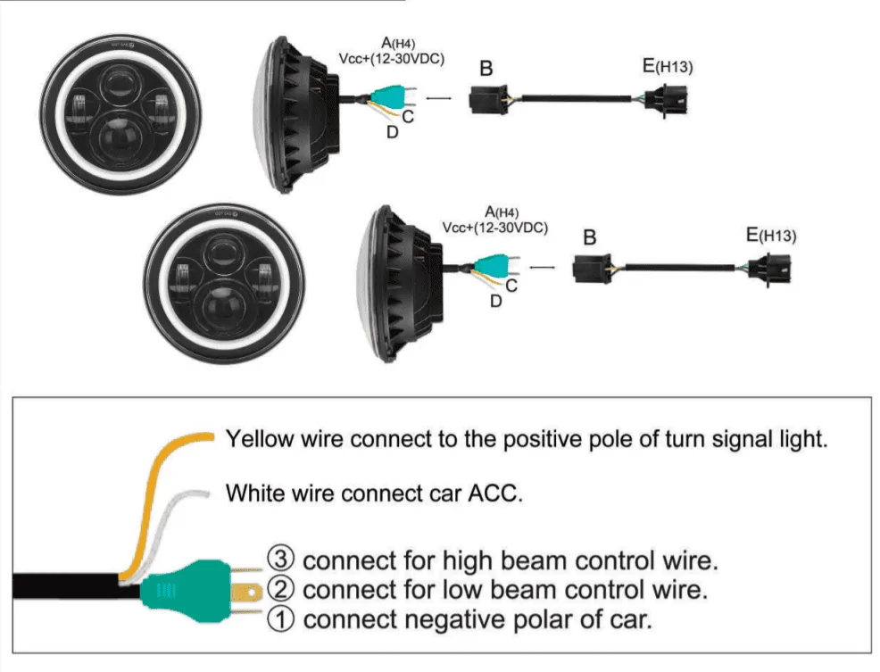

Yellow wire needs to tap the turn signal power for the halo signal activation. The white wire can be run back to the fuse block with an add a fuse tap to gain ACC power for the halo rings. Most people use the heated seats or lighter fuse slots. You already have ground in the main headlight harness.
Many people have done these installs before. Oracle has a good video of the fuse tap with their Bi-LED lights. You can search the forum for the correct wire to tap in the turn signal.

Truthfully, return them and put a little bit more money into a better quality light set. Oracles are pricier but it's a complete kit and you shouldn't have questions about the install process.

The only thing I had to do with the Oracle lights was run and extend the halo wiring to the fuse location. Not true DRL but always on when the ACC is powered.
