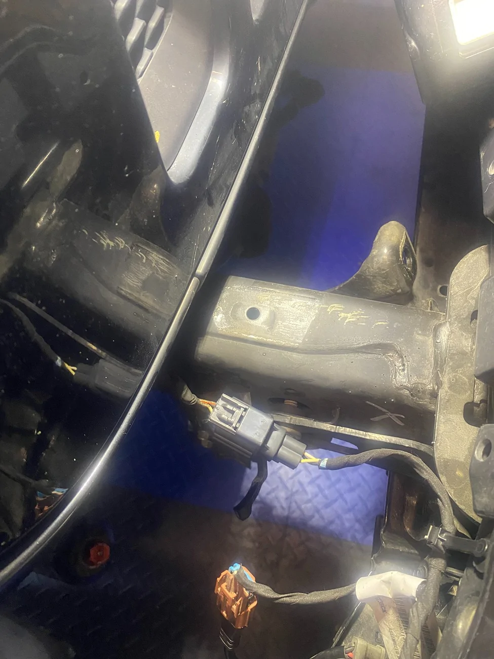

How to open this connector??
yokramer
Sep 8, 2022
31,122
157,923
Snark Incarnate
Thats just a standard connector, push down on the bit that bends down and pull them apart. If it isnt going push the 2 halves together and try again.

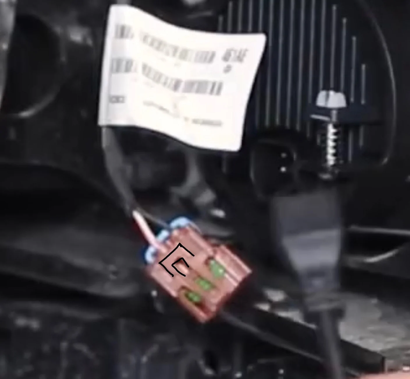

Are you talking about the brown connector? if so yes as @yokramer already said push the two connectors toward each other, push the lever down outlined in black, then pull the connectors apart making sure not to pull on the wires themselves. Today I’m just repeating everything yokramer says so I seem smart
