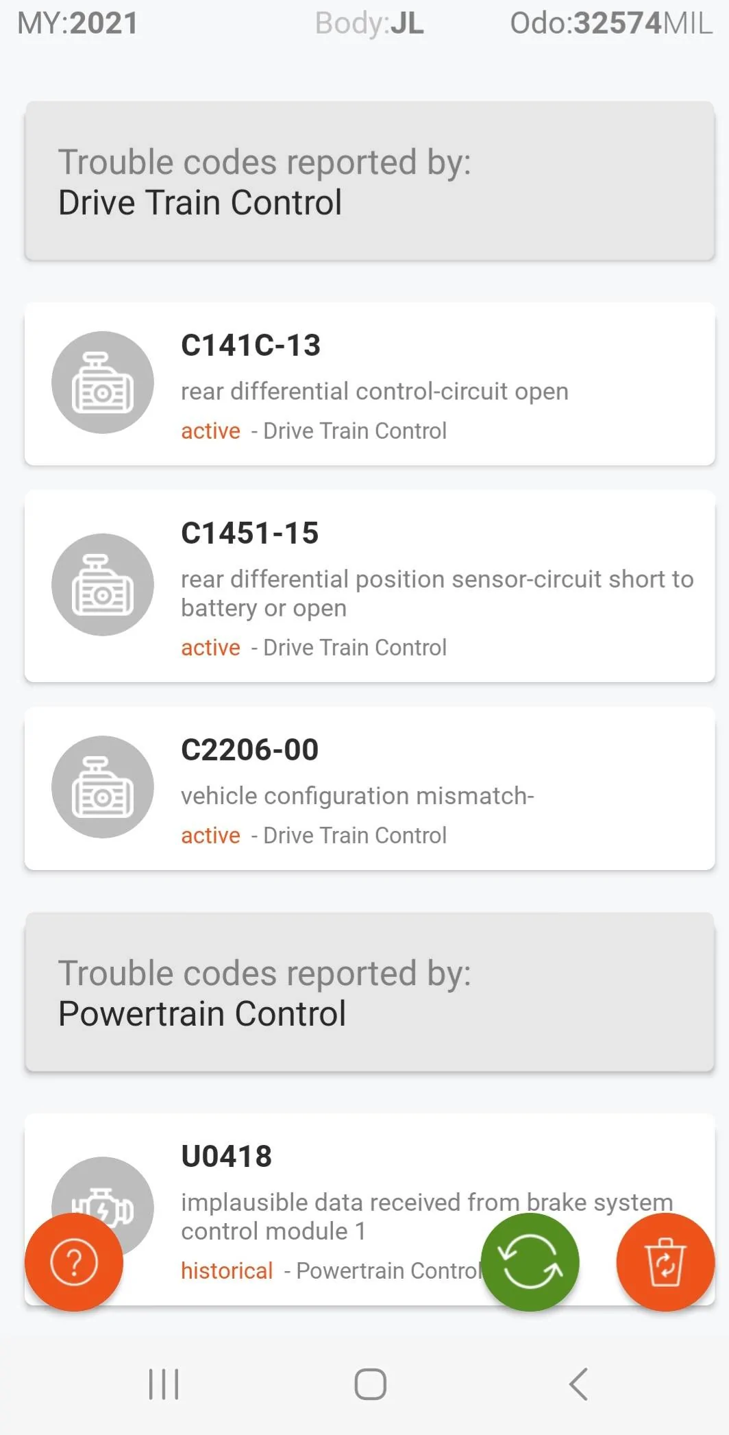

I've disabled the fad. Basically set it to None in jscan
Did the same with the locker setting. But I'm getting the following dtc codes and SERV 4X4 error.
Jeep Wrangler JL How to fully disable lockers? Screenshot_20231106_164027_OBD JScan
Any idea what I need to do in jscan to get rid of the SERV 4X4 error?

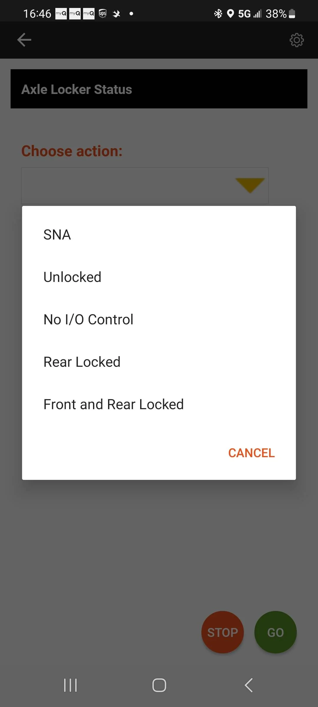

Do I need to set this? To SNA? Or no io?

Don’t mean to revive an old thread, but did this ever get resolved. I’m in the same position, just installed new axles and I was able to deactivate the fad without any codes, but when I deactivate the lockers I’m getting this code and service 4wd as well. Any input would be appreciated.
auditech
Apr 20, 2025
2020 Wrangler JLU
I was hoping JScan would be able to perform the locker disable function with out issue, but maybe I’ll have to get a Tazor. I just don’t know why the Fad deactivation worked using JScan, but not the locker disable.
