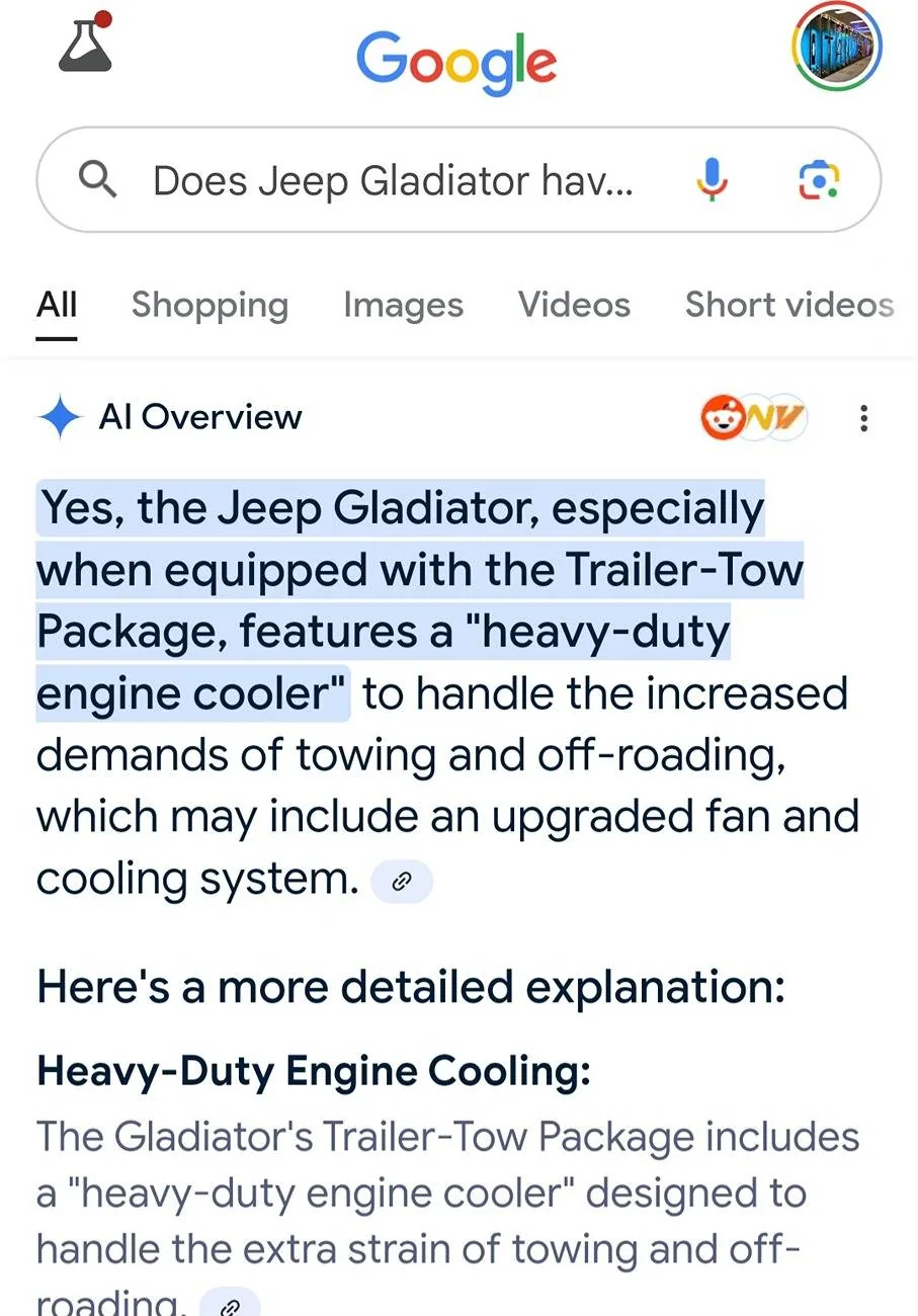

The 3.6L oil cooler is a plate style engine coolant-to-engine oil heat exchanger. Are you implying that the 3.6L in the Gladiator has an additional cooler for the engine oil or engine coolant? If so, do you have a picture of that cooler?
Jeep Wrangler JL How does JL 3.6L oil cooler work? Screenshot_20250306_132326_Googl

I am pretty sure that the "heavy-duty engine cooler" refers to a more powerful cooling fan, which some Wranglers also have.
