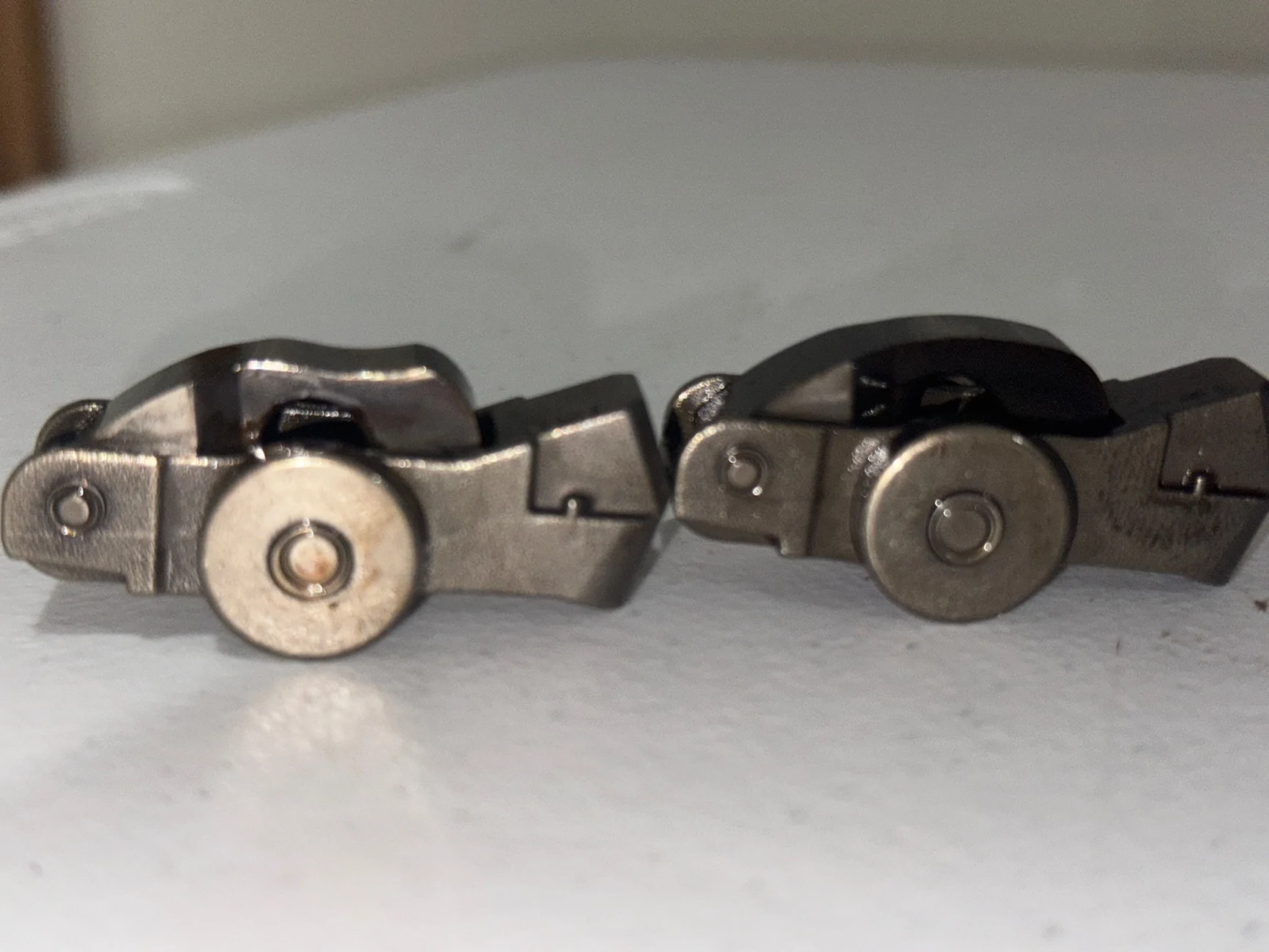

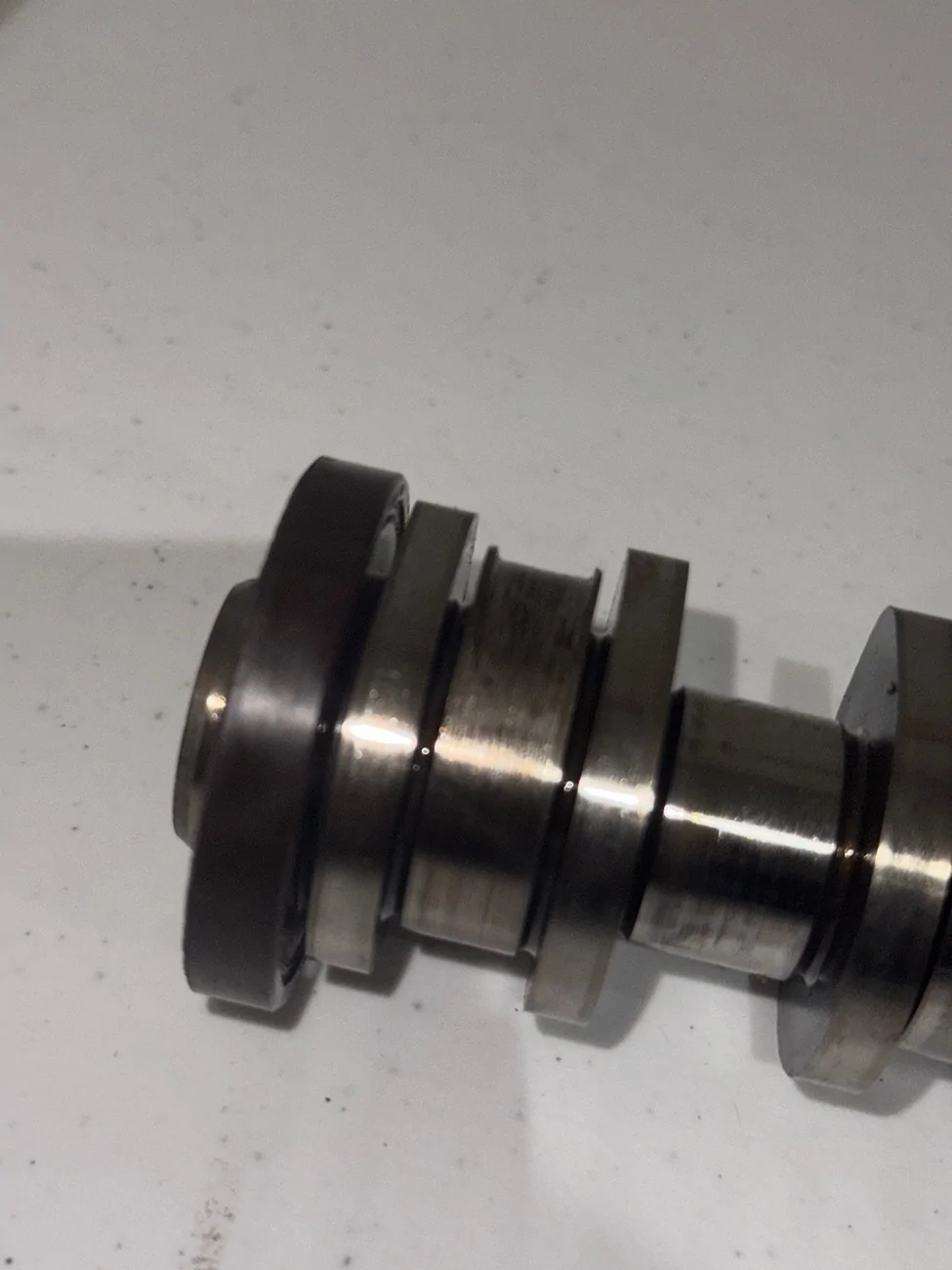

New right intake cam and rockers. No more tick.
Jeep Wrangler JL Does Timing Tool Kit Work on 2020 3.6L? RI Cam
Jeep Wrangler JL Does Timing Tool Kit Work on 2020 3.6L? RI #1 Rocker

That’s exactly what mine looked like.
