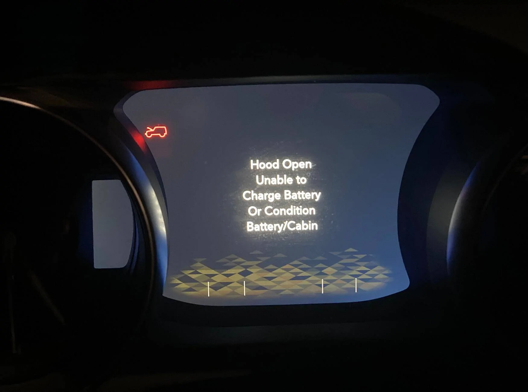

It’s a little confusing; normal operation, with the hood up the ICE is running but the dashboard message says the battery is not charging. I am not sure the engine is charging the 12V battery when using the air compressor. It would be nice if it did.
I'm not sure exactly what you mean by the dashboard message says it's not charging. Personally, I've never had an issue with the 12V dying or being too weak so far with this jeep. I had a gladiator before my 4xe and it never gave any messages, just straight up died one day before a trip to TN.
Your guess is as good as mine as to what this really means.
This disables the HV system so you or the mechanic don't shock yourselves messing around in the engine bay. This only applies to the HV battery when you are plugged in, it doesn't mean or do anything about the 12V battery.
