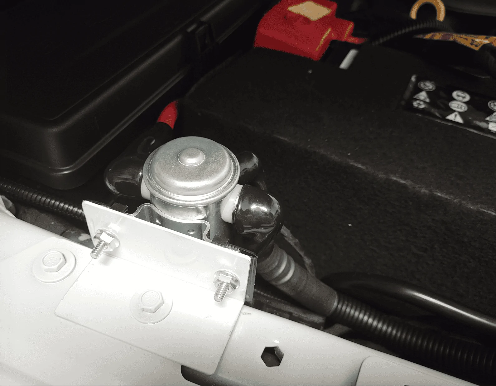

Also just installed mine today along w/ a bumper and winch, turned out great love having it hooked to an AUX:

Going to hook mine to aux. What do you feel are the main advantages to aux over the battery? I like that no one can turn it on when parked.

Piece of mind. The wire's not energized down to the winch unless the AUX switch in on, so it should eliminate any possibility of short conditions until the switch is turned on at which time you'd be acutely aware of it. Less puckering during water crossings, etc. Also it wouldn't be energized when the vehicle is off so you can't forget and run it and drain your battery in short order. But most of all because pushing buttons feels good.

Thank you so much for posting that, I have been out in the garage trying to figure out a mounting position. That is K.I.S.S simple and I'll be copying that.

Even easier with the pre drilled channel.
That is well done but it is also A Lot. It looks like you have the V6. The 2.0 as shown @PocketsEmptied pic is what I have. One of my goals is to insure that I don't hinder access to anything I might need in the future. For example, I don't want to have to remove my relay to get to he battery mounting bolt. Further up the thread there is someone that used the bolts on the firewall/cowl. That's not bad either but I also wanted to keep this all as far away from engine heat as possible.
