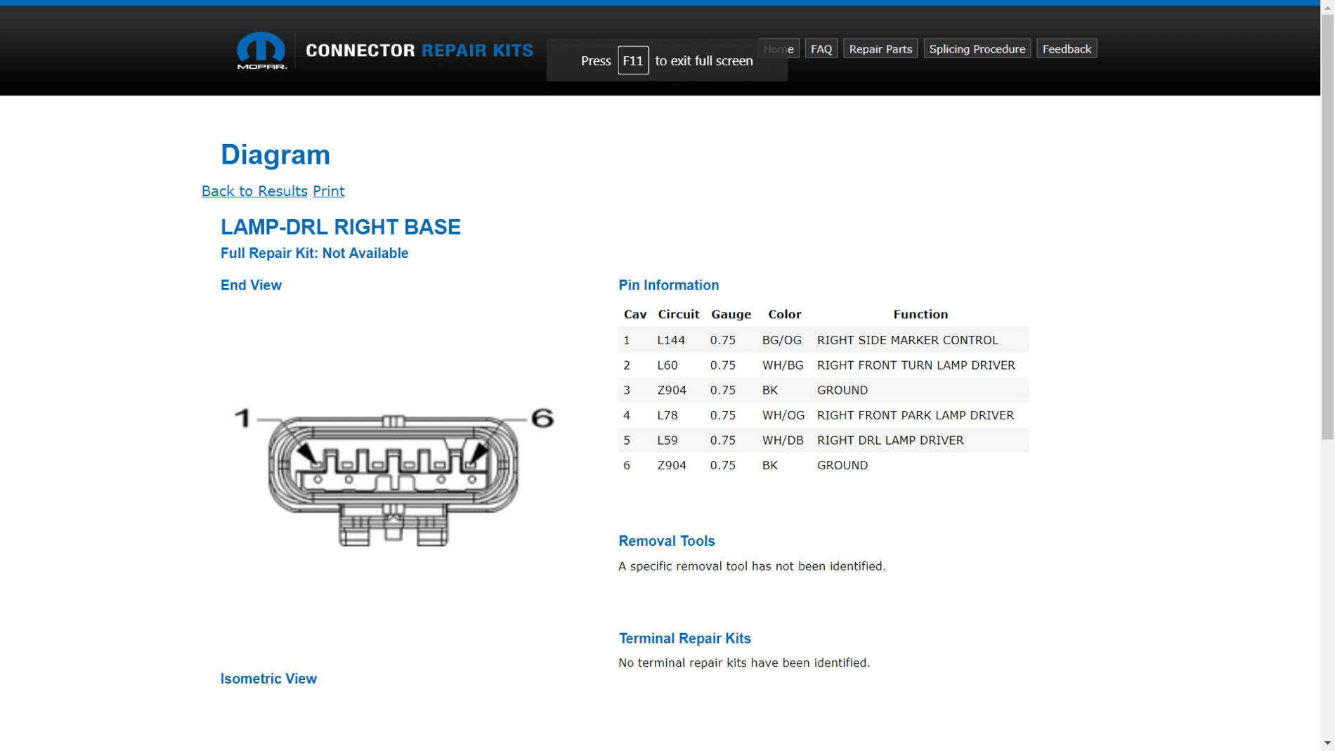

    I am sorry but I am not aware of any wiring adapters to go from halogen to LED but when I look up the repair connectors for both they look to be the same, Is this not the case? See below for what Mopar shows
    -Benny

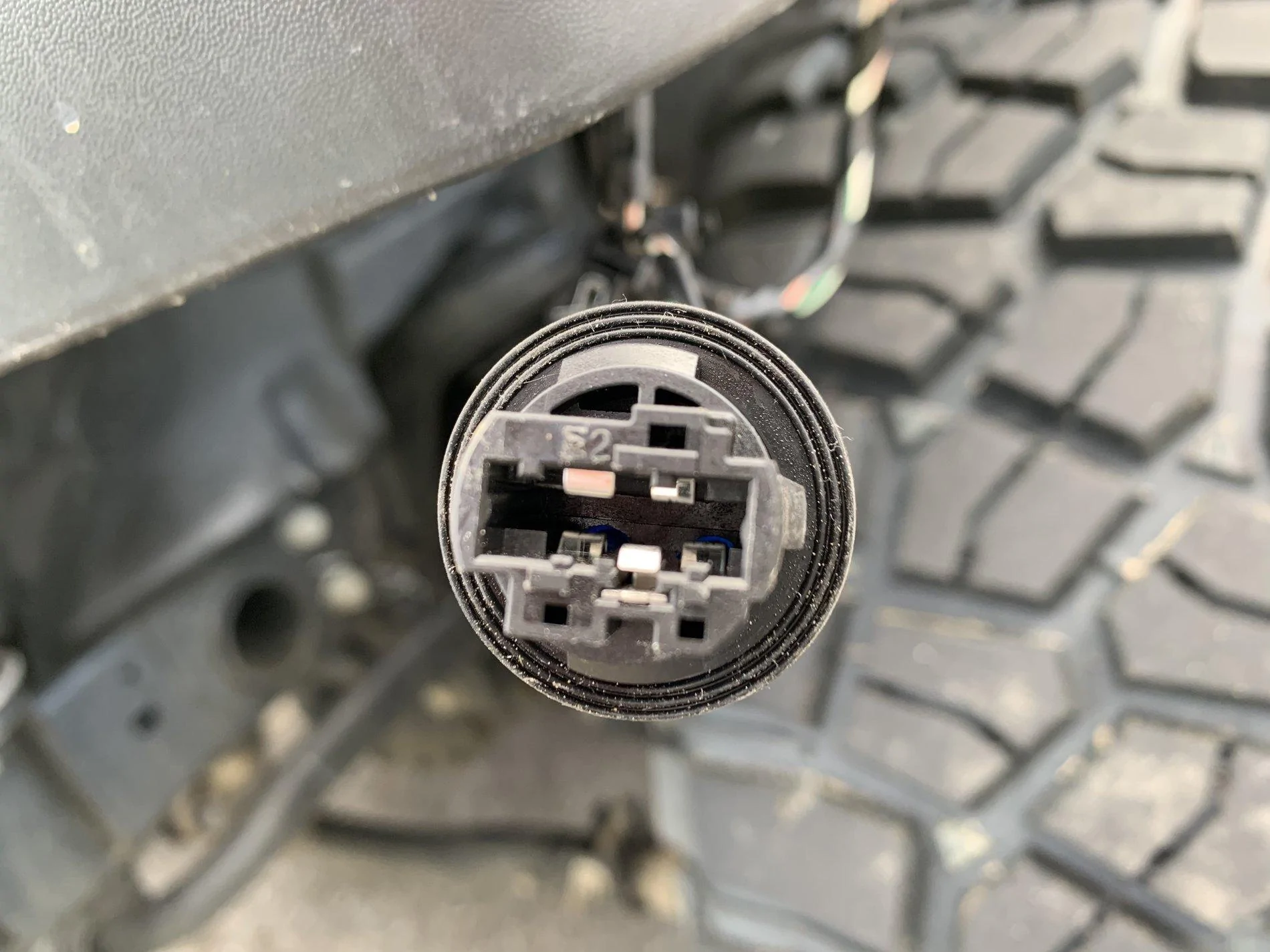

    Thank you for your response Benny!
    This is what the connector looks like.

    This looks like the bulb socket, Is there another connector inline behind this that perhaps matches the diagrams I sent?
    -Benny

    Perhaps, I need wiring that connects from terminal in above diagram to LED housing (5-pin) male connector.
