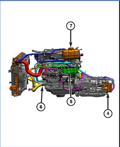

Hi Chance,
We should be able to figure this out. Is that T connection closer to the Radiator side?
Gonna use these images to hopefully help some
- Benny

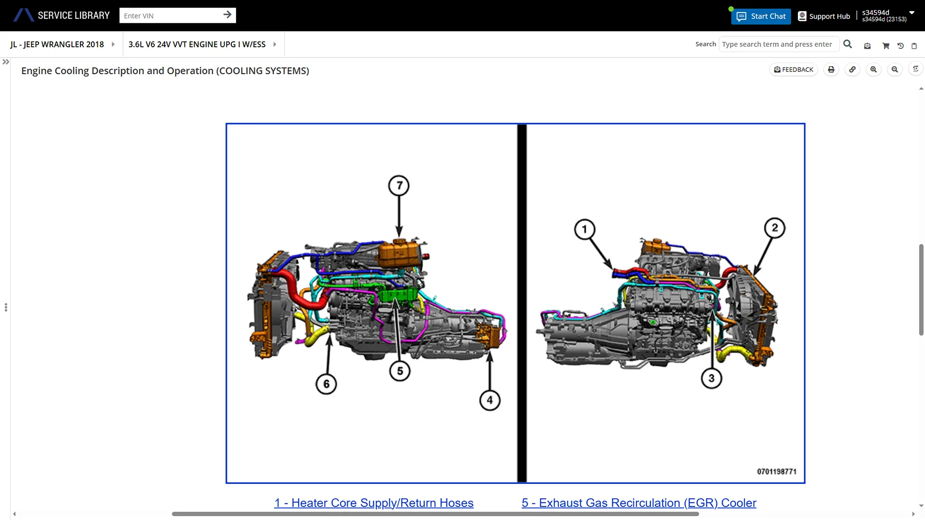

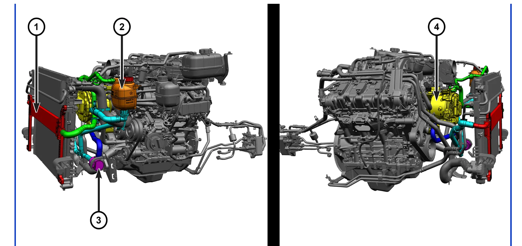

Benny,
Out of curiosity is this an engine diagram for an Etorque 3.6L. Because this setup doesn't quite match mine. This one looks to have an extra reservoir that's labeled as index 2 in the above.
The hose that I part numbered out connects from the upper radiator to the thermostat housing on the front cover but, right before the thermostat housing it has the "T" fitting. The small diameter hose connects to the "T" and has a short piece of hose then connects to a steel line that drops down beside the block then runs towards the back then back up to the rear of the head all on drivers side. if that makes any sense.
Thanks
Chance

Hi Chance,
Yes it looks like it was, Here is your configuration

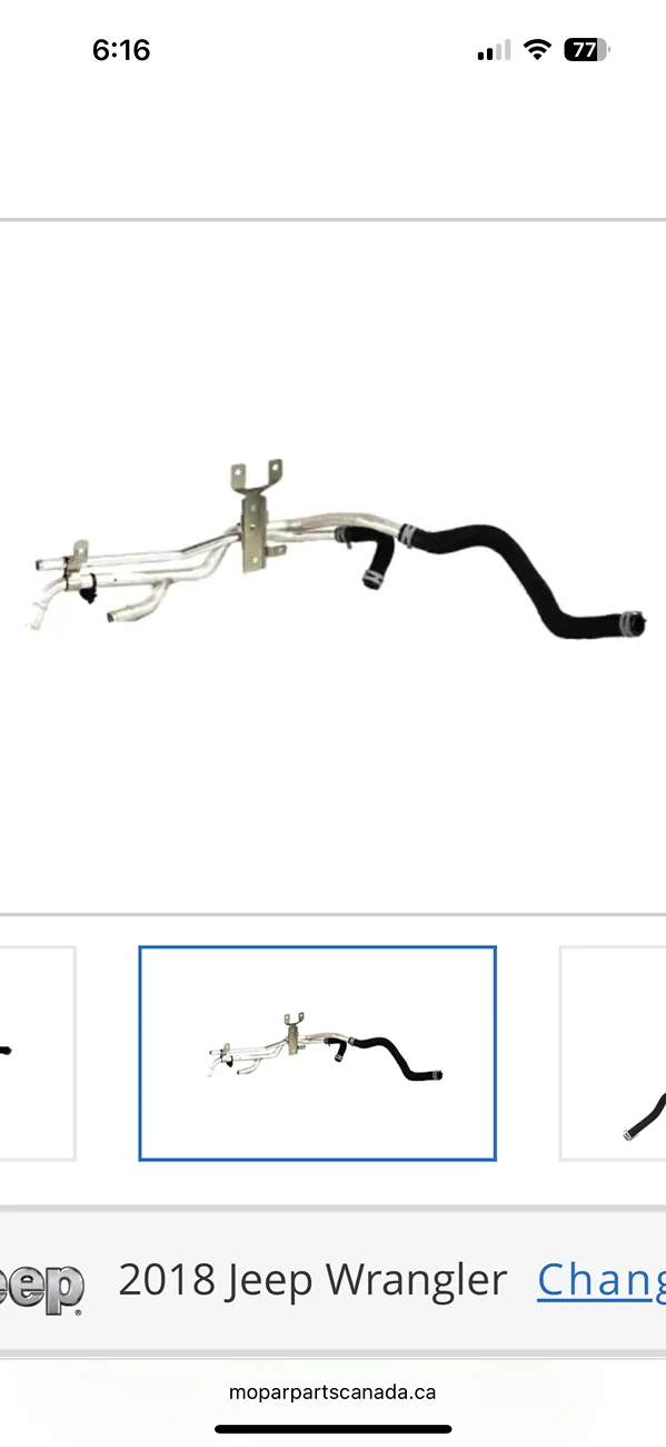

So it sounds like we are looking for the Purple hose which is part of the transmission heater circuit. This hose can be found here
https://parts.allmoparparts.com/oem-parts/mopar-coolant-hose-and-tube-68280791ad?c=bD0xJm49U2VhcmNoIFJlc3VsdHM=
Please let me know if you have any other questions.

Benny,
Looks like it its the pink hose connected to the red Radiator inlet hose. I've circled the connection point. where its leaking from.

Benny,
Thanks!!
My Purple = Your Pink lol , Its the hose I linked
