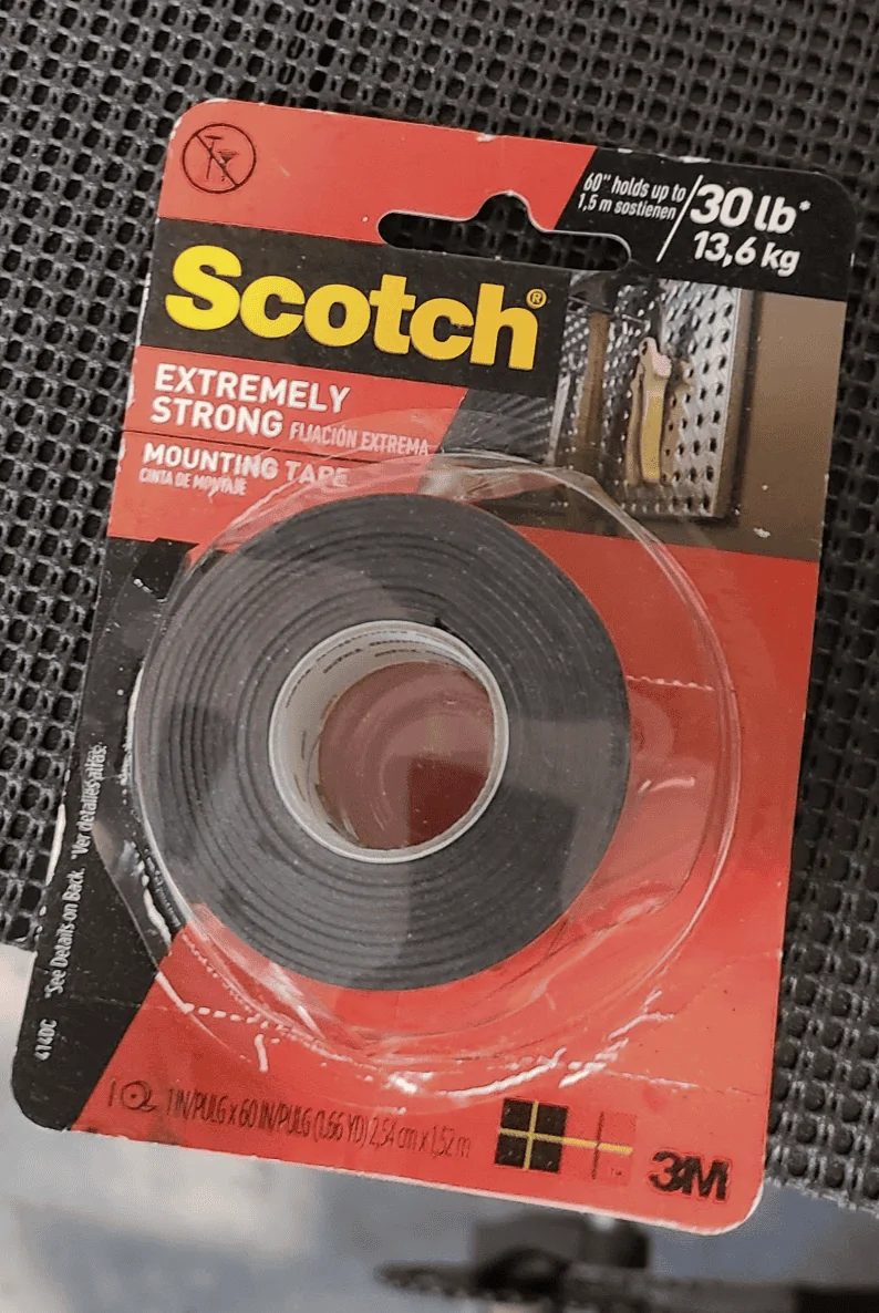

So far it has been holding strong after adding more tape. The front piece was still tacky, but just would not hold when closed. So I added some Scotch tape I had laying around. I did not take off the original tape, I just added this double sided Scotch tape to it. Its been great and holding up perfectly.
As for heat we shall see as we have not hit summer heat yet. However I have left it out in the sun on a 85ish degree day and no issues.

Hi,
I can't find the temp rating on that tape (I looked on 3Ms website). There are some extremely sticky/strong tapes but almost all of the retail ones are rubber based and will fail at high temps, 140+. We have a long history with the 3M VHB Acrylic tape we use. You could use an adhesion promoter in the front section like we have you use on the rear section but it pulled the paint off in the front doing that so we didn't think we needed to use it there.
If you have any further issues with the front holding let us know and we can send new tape and more adhesion promoter.

Thanks. I just ordered some of this off Amazon just for some reassurance.

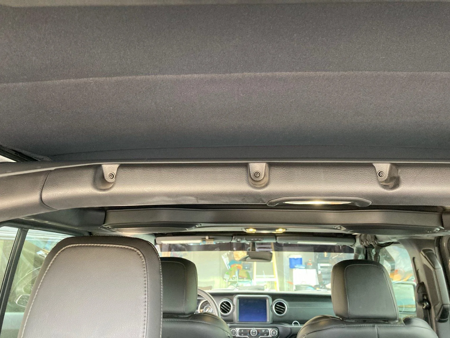

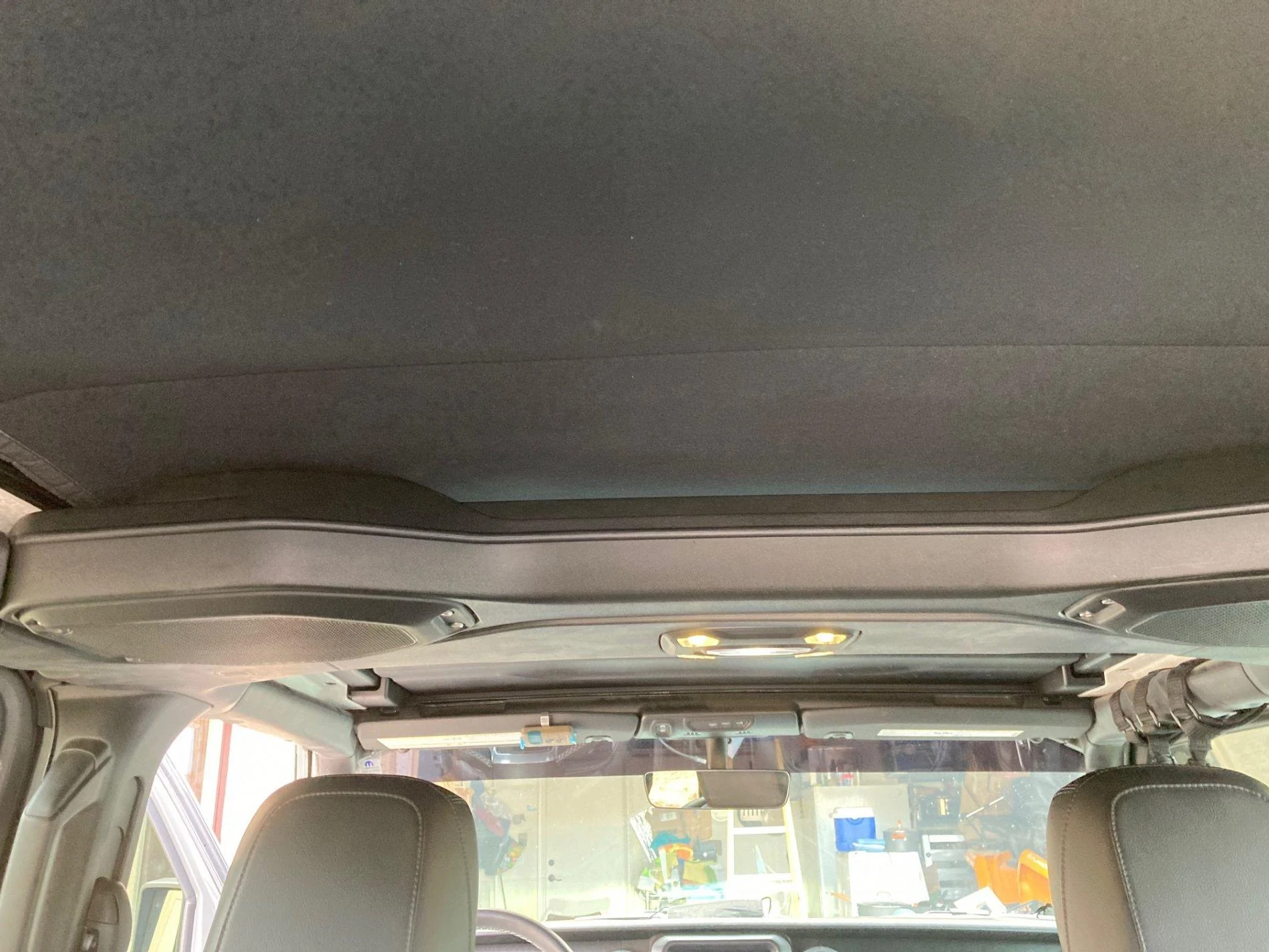

Wifey-pooh and I installed the liner earlier today. After watching the video, was roughly a 25-30 min install. The JL is her daily driver, and she said it does sound more quieter. But to be honest, we didn't buy the liner for that. It's a Jeep man! We love the sound of the mudder tires.
Rather, we'll see if it helps a little bit with the AZ summer. Granted, with the heat we have here, there ain't much you can do about that. (So we do take that into expectations. All of our vehicles can really "bake" here...)
But in summary, we do love this product, and we can see it does have a sound benefit.
We'll update our post in June... ;)

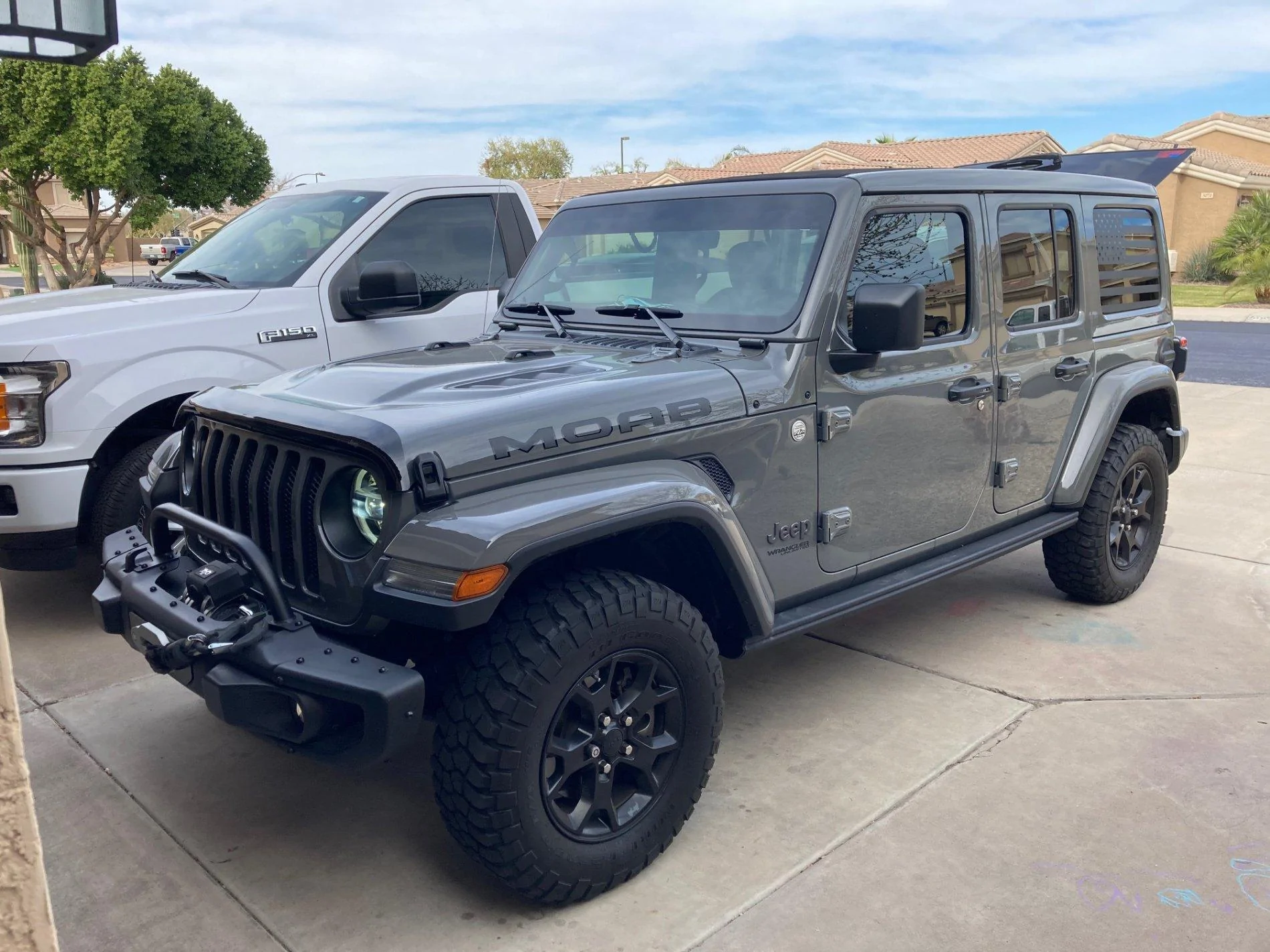

Here's her daily driver:
More post install pics:
Off topic. Which Front Deflector do you have installed? Looks sharp!
