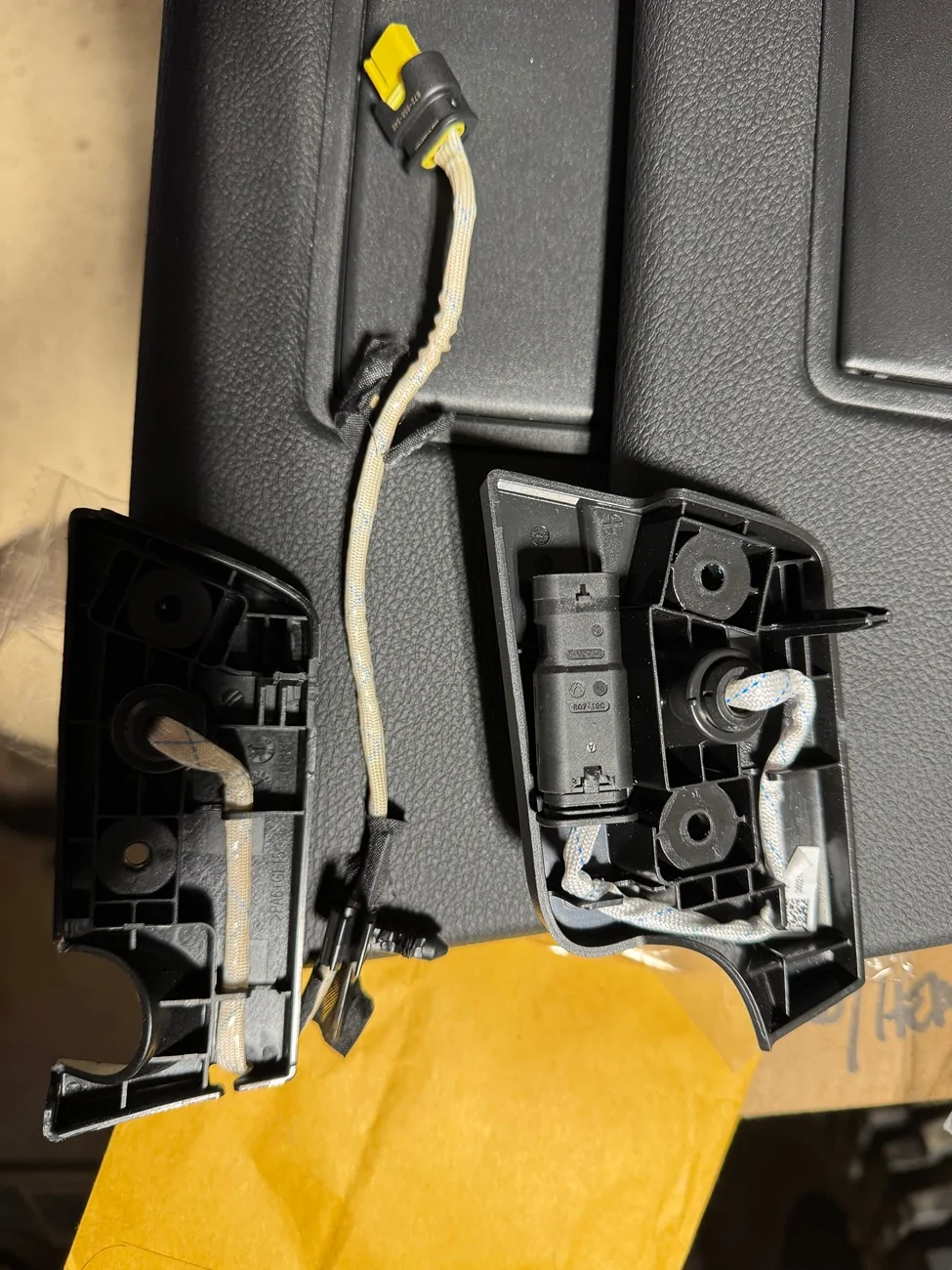

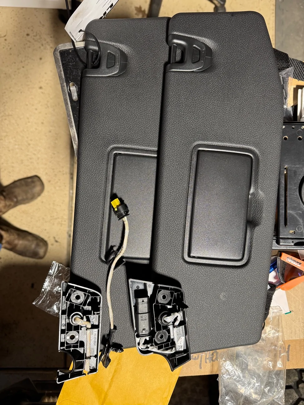

I first ordered a Sun Visor w/Home Link from an on-line salvage company. It came out of a 2024 Jeep JLU - Wrong! I found out the hard way the difference between the 2025 JLU and previous year model JLU's reference the side Air Bags. The 2025 JLU with side air bags has a different Sun Visor connector, mount, and a shorter wire (picture comparing the two attached). Yes, I could have cut the wire on the 2024 Sun Visor and rewired it to make it work. However, I elected to find another Visor from 2025 JLU. Fortunately, the same on-line source had a 2025 JLU Sun Visor w/Home Link that became available a few days later, it is an exact and easy swap. The only thing left is to activate the third wire in the Sun Visor Harness via the Body Control Module (BCM).
