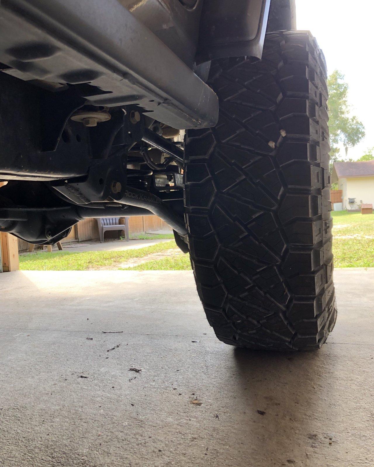

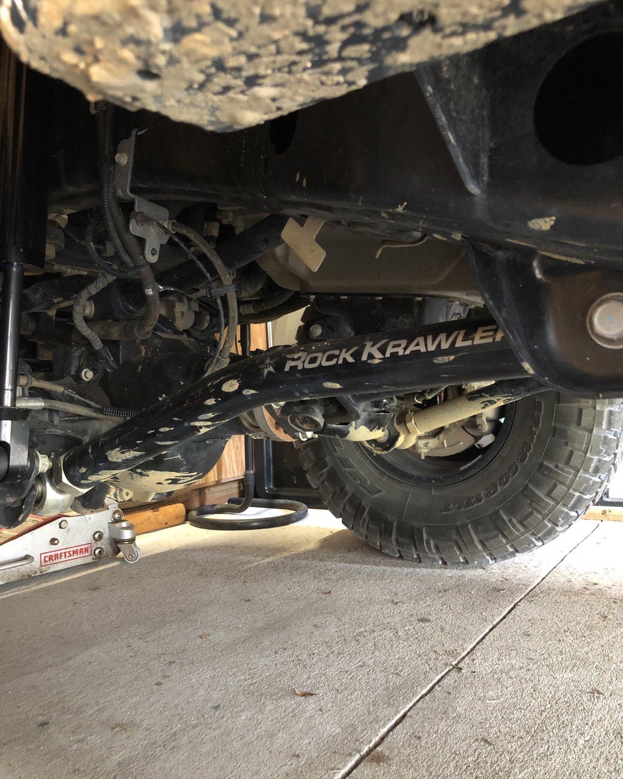

I personally would use adjustable control arms for any lift, I don’t like using relocation brackets because they hang down and you can’t dial in more caster if you need to. I just like the ground clearance and adjustability of the adj. arms. I use rk xfactor arms, you can see how they’re designed for clearance.
Jeep Wrangler JL Help with picking the right Teraflex for me ... F239F071-C4E4-4C09-905F-53F4A9766C69
Jeep Wrangler JL Help with picking the right Teraflex for me ... 484DC768-231B-4EF0-B16C-F43B63180BBB
