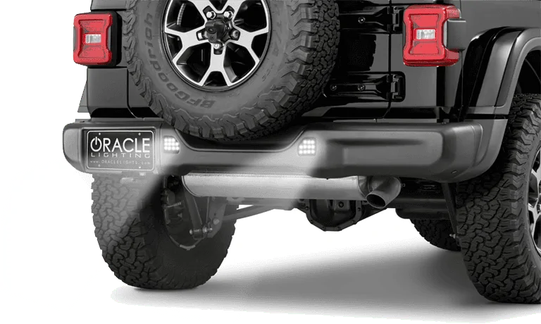

Cube lights for rear bumper look like an after thought, we recommend: www.oraclelights.com/products/rear-bumper-led-reverse-lights
Jeep Wrangler JL Help with light selection JL-Reverse-3
