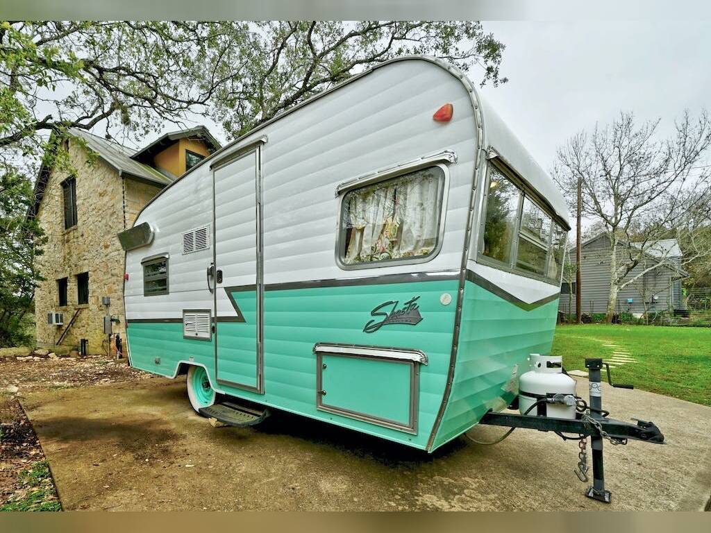

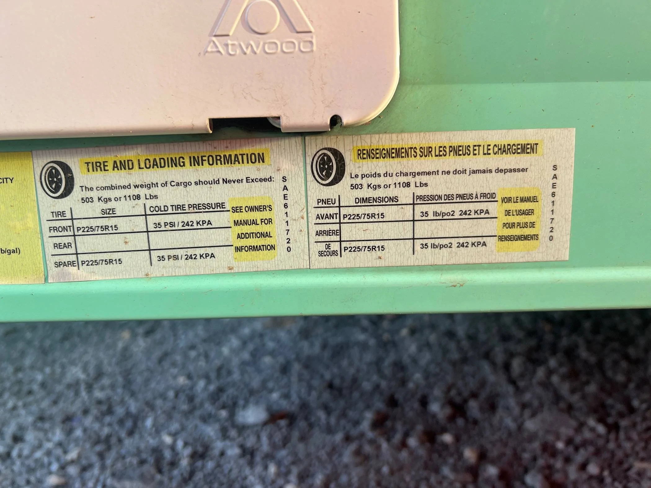

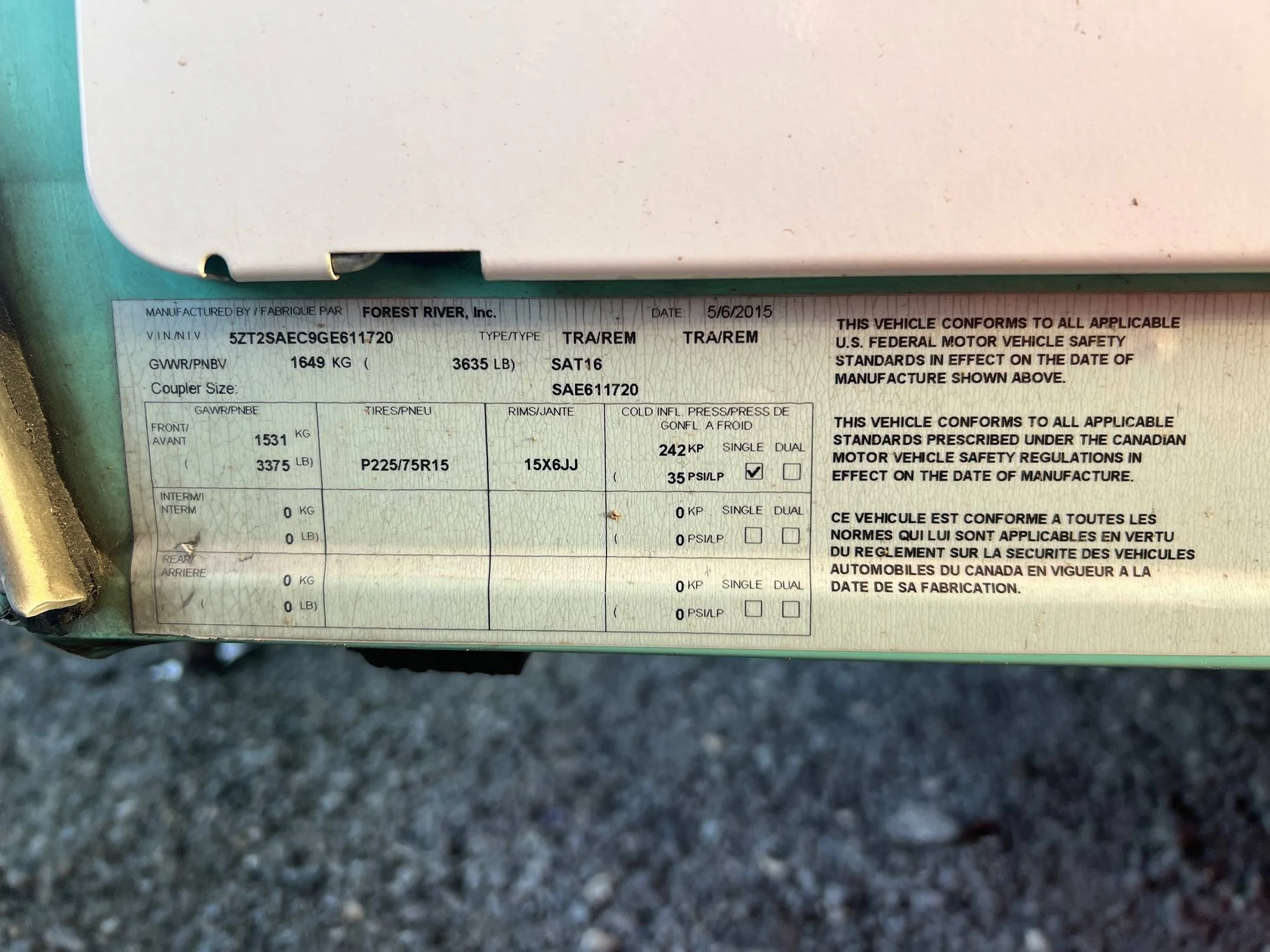

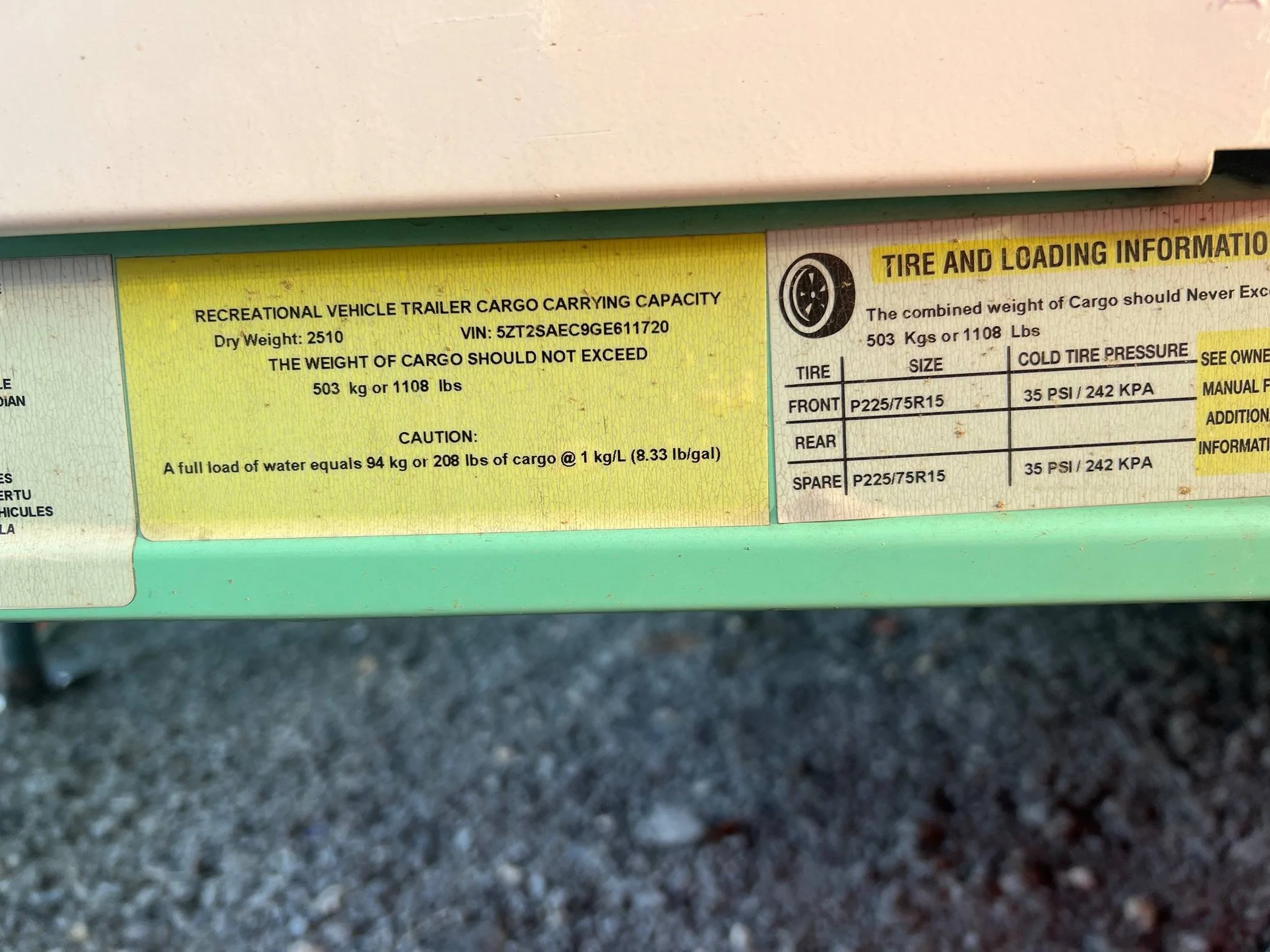

We have a 2024 Sports S 4xe and are about to buy a 2015 Shasta Airflyte Reissue. I’m trying to figure out what hitch to get for it. I know you can purchase weight distribution hitches and/or sway control hitches. I just don’t know if the camper is heavy enough for one of those, or both. I took some pics of the towing specs. I’m told the dry weight is 2,345 lbs, but it’s a little more on the tag. I just want to have the right hitch when I got to pick it up. I still need to get some measurements to figure out how much drip to get.

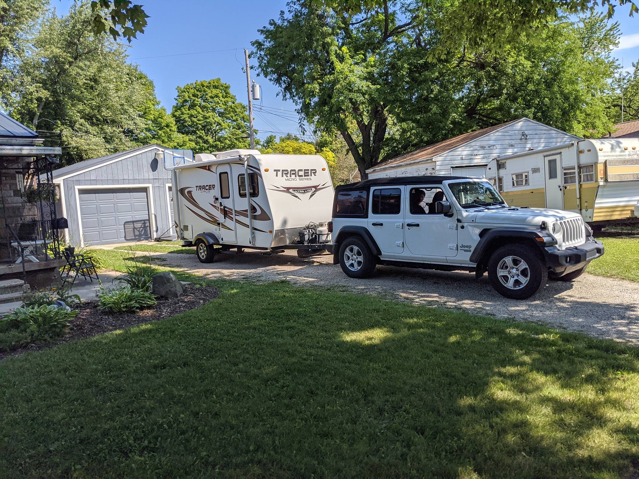

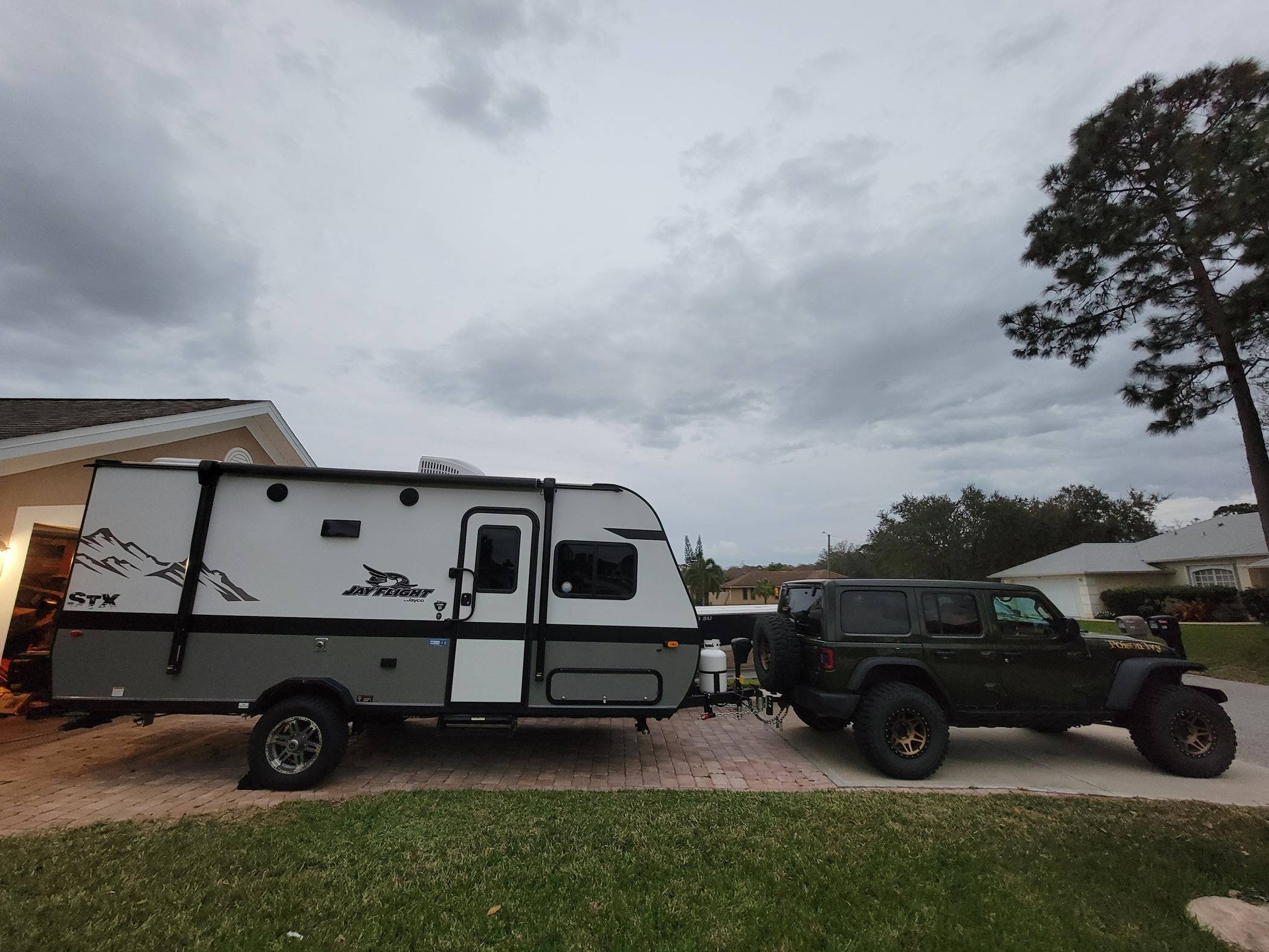

This was my set up on my previous jeep a sport s. This camper is lighter than the Shasta.
I used a wd hitch from e trailer that was awesome! I also used a Bluetooth brake controller with a phone app for manual use, which I didn’t use.
The thing about the wd is it leverages the weight across the entire frame from back to front, like a wheel barrow.
On top of that I would air bag the springs as they are inexpensive. This will give you a level stable ride that you can safely take anywhere.

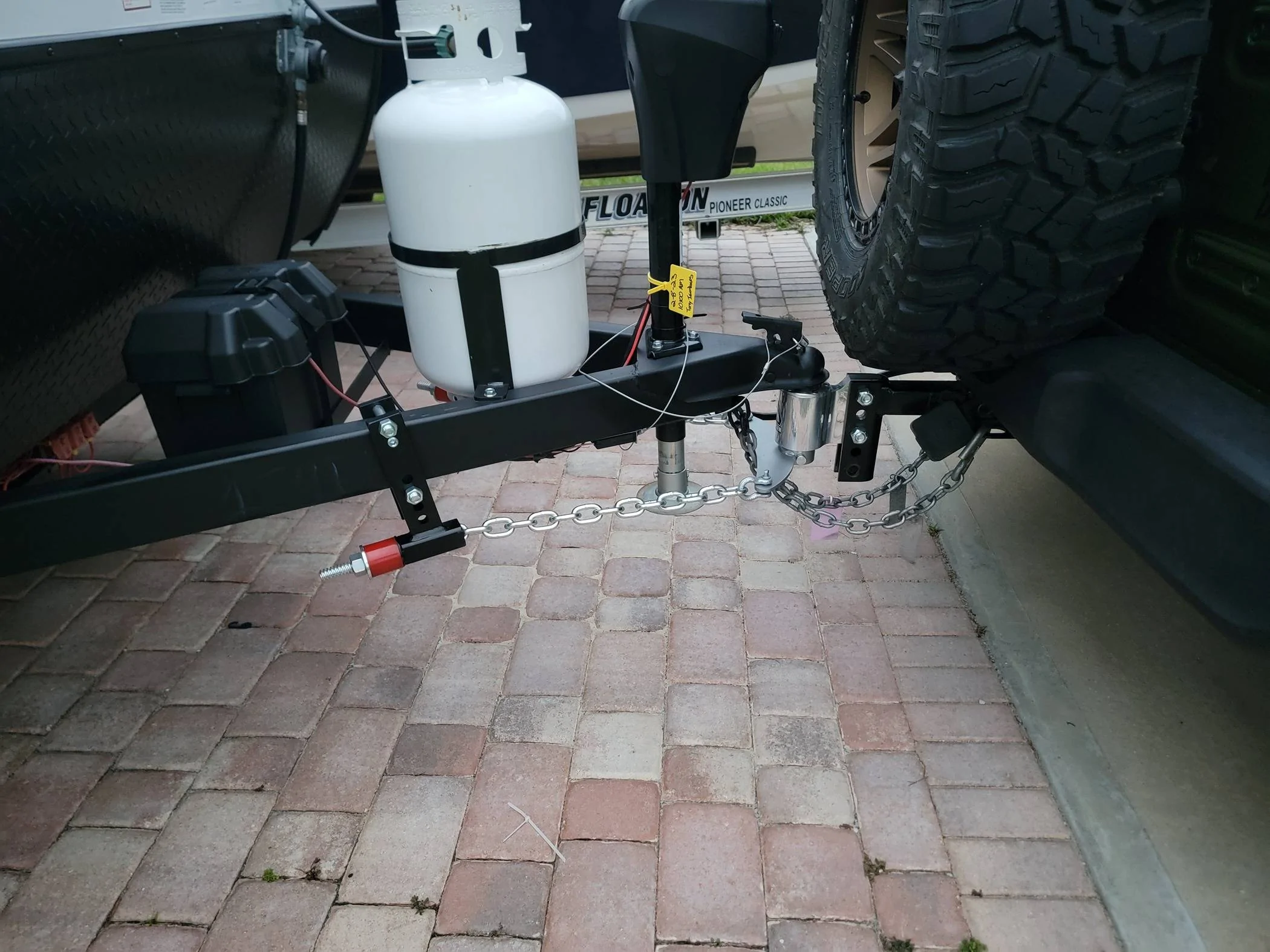

Check out Adersen WD hitch. It is much lighter Than a standard WD hitch.
