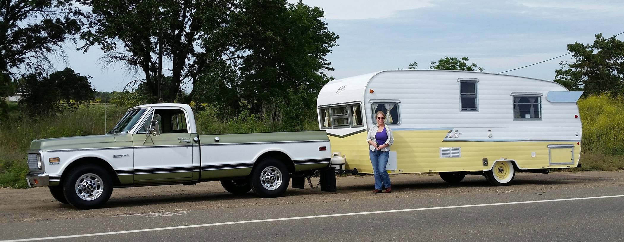

Shasta only made a total of 1941 of them (to commemorate Shasta's 1st year in business (1941)). We were on a waiting list to get one. They pre-sold every one they made.
This was the day we took delivery in April of '15 in northern CA.
It looked pretty cool behind my '72 ?
We sold that trailer in '20 for only a couple hundred dollars less than what we bought it for.
It was garaged (babied) it's whole life.
What a conversation starter at campsites though! ?

Yes, we typically met everyone at the site every time we camped.
