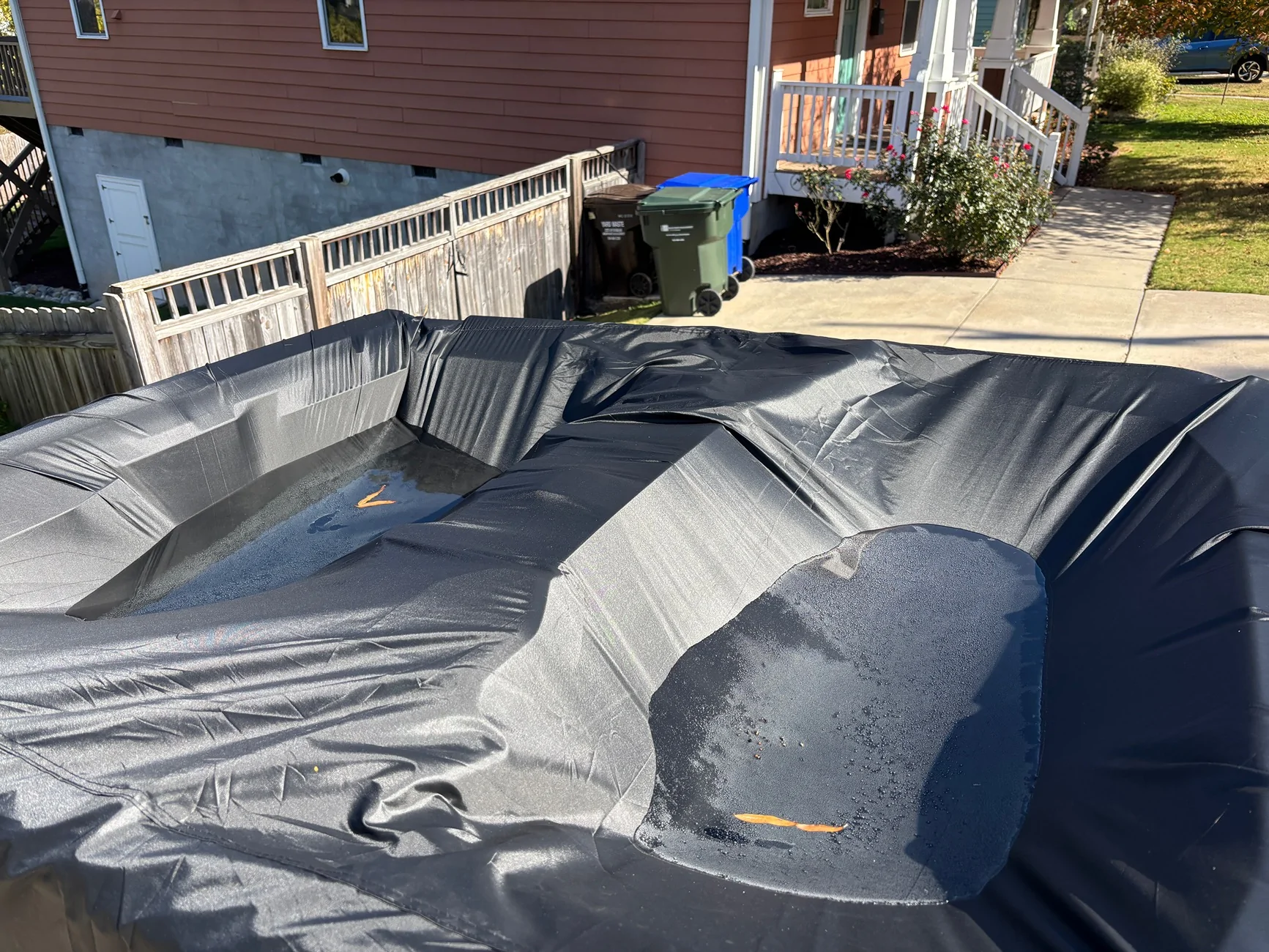

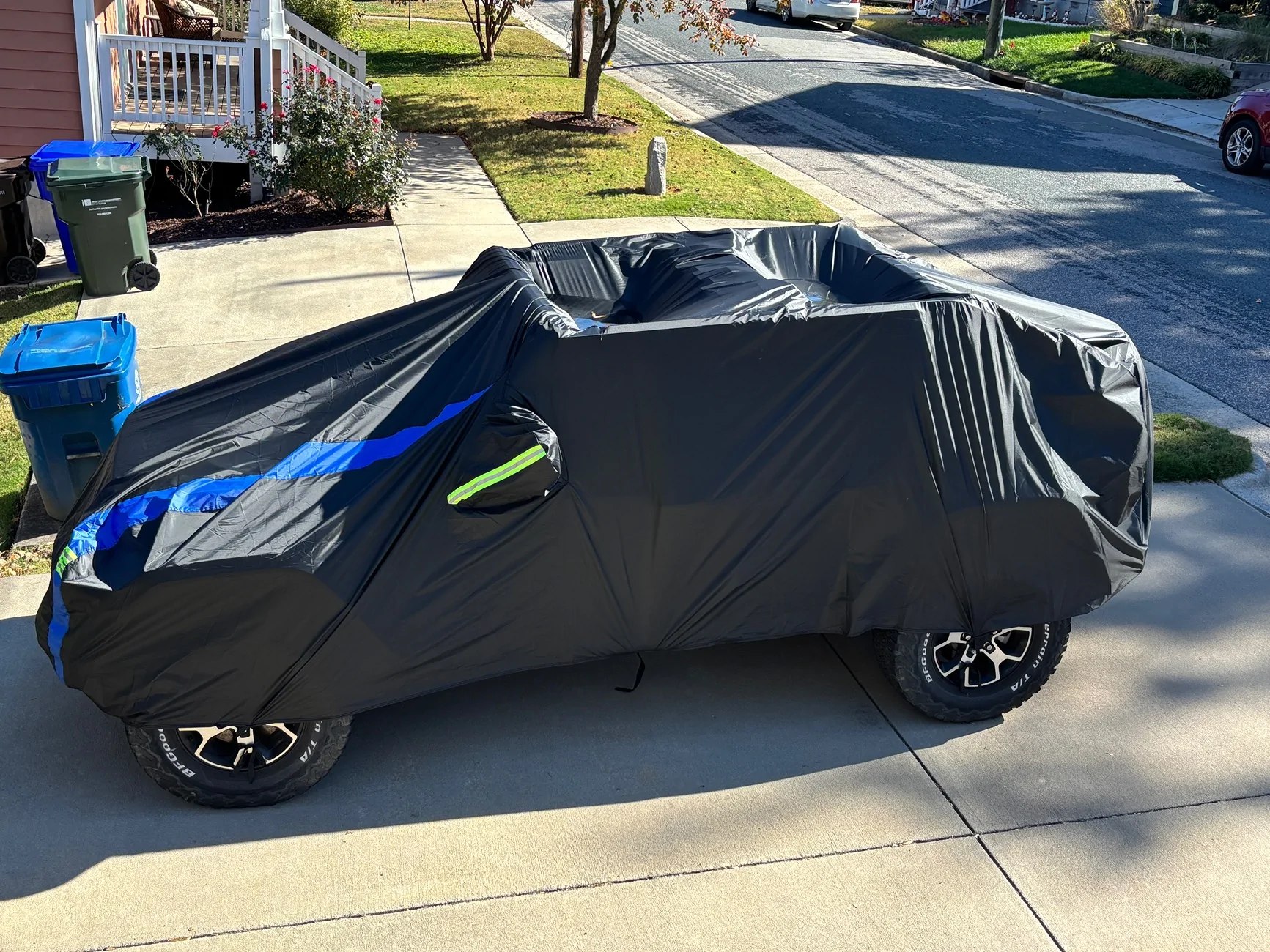

So I bought a full body cover and this is what happens…
Jeep Wrangler JL Help with cover for topless JLU IMG_9906
Jeep Wrangler JL Help with cover for topless JLU IMG_9909
Any recommendations for a cover that will allow me to keep my Wrangler topless? Also open to getting some sort of snap-in/rigid sunshade for those gaps which would create a surface keeping the water from pooling (I couldn’t find anything searching).

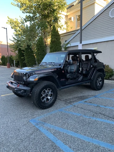

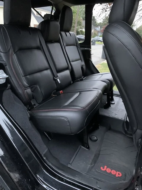

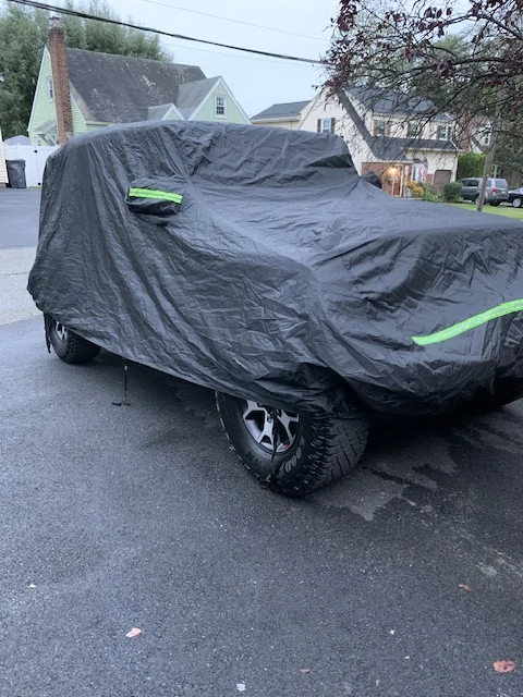

I agree, it looks slick, but you can't trust Mother Nature. You can put the top up in “safari mode” to give the rigidity you need. Don’t worry about putting the windows in. My son did it a few times last summer, and everything stayed dry inside.

Foam Nerf type balls above the sound bar raised my Mopar cover high enough that water didn't pool.

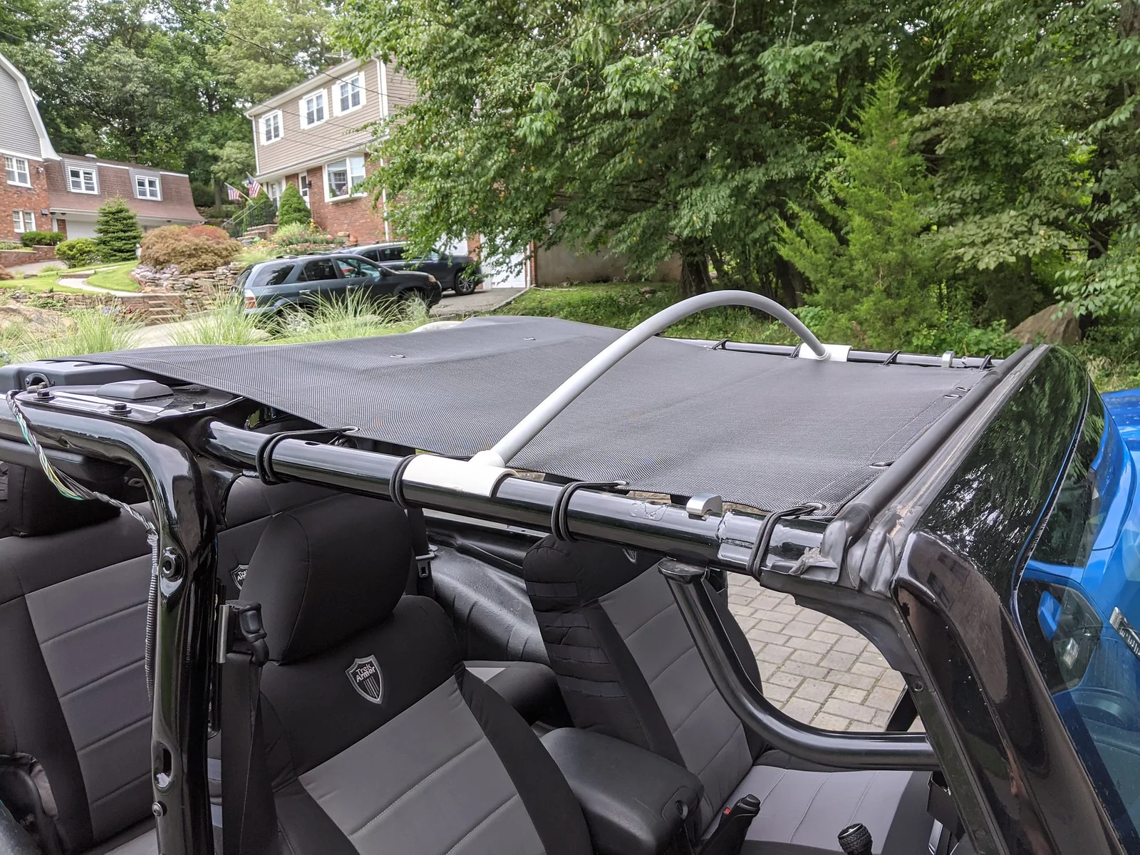

Somebody makes a flexible rod (like a dome tent pole) that goes from one side of the roll cage to the other creating a slight dome to prevent water from accumulating.
Here is a PVC diy version that you can make with a $10 trip to the hardware store and a hack saw. Slips on and off with no tools required.
