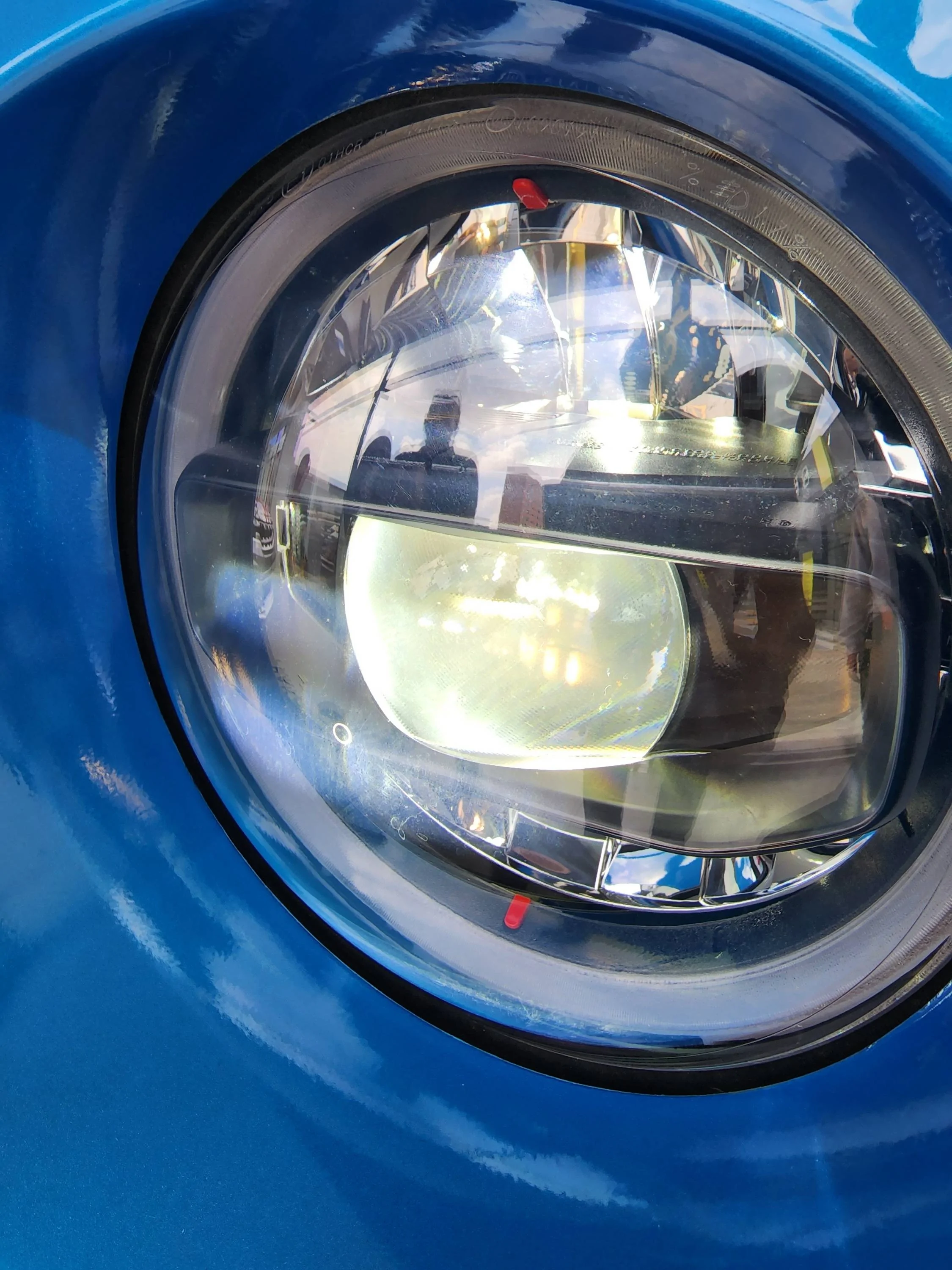

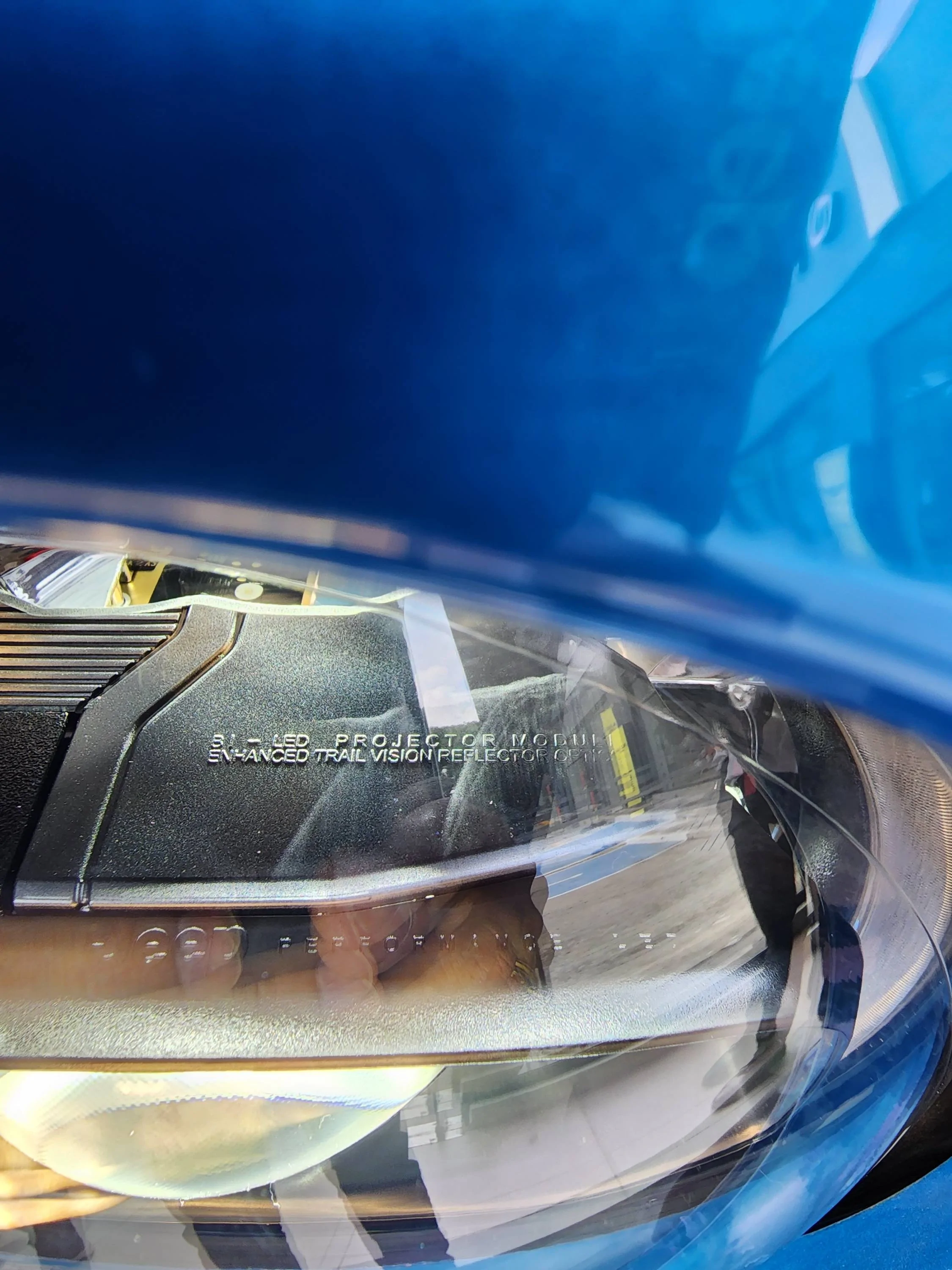

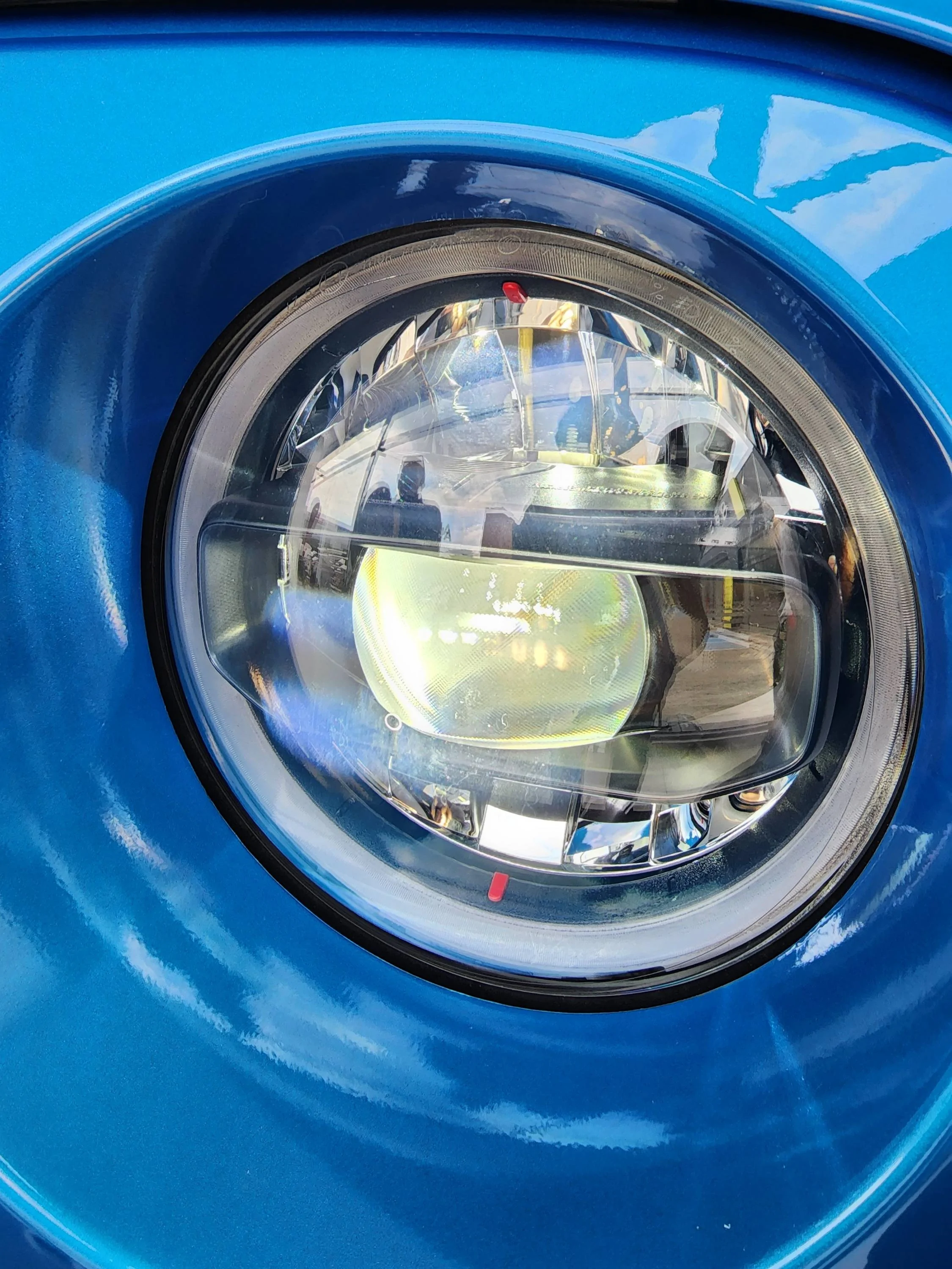

So i just received my 2023 JLUS and i have this equipment:
FRONT LED FOG LAMPS
LED PREMIUM REFLECTOR HEADLAMPS
DAYTIME RUNNING LAMP LED ACCENTS
I can see in the headlamps the Halo lights, but i can´t get those to turn on.
I checked all forums but i haven´t see a problem like mine.
I can´t do it through Uconnect, i don´t have the option on the screen.
My dial in AUTO doesn´t do anything (just turn on the lights when is getting dark, but no Halo)
I suppose because this is a Latin America Equipment Group car, they disable it for some reason.
Can you guys help me to turn the halo on?
Or am i missing something?
Thanks a lot

Can you help me checking the pictures I uploaded and see if the halos exists? I think I see it there but maybe I'm wrong
According to thread I attached the headlights nor harness have what is required to activate. Best way to verify is remove headlight and check for 4 pins on headlight and harness
