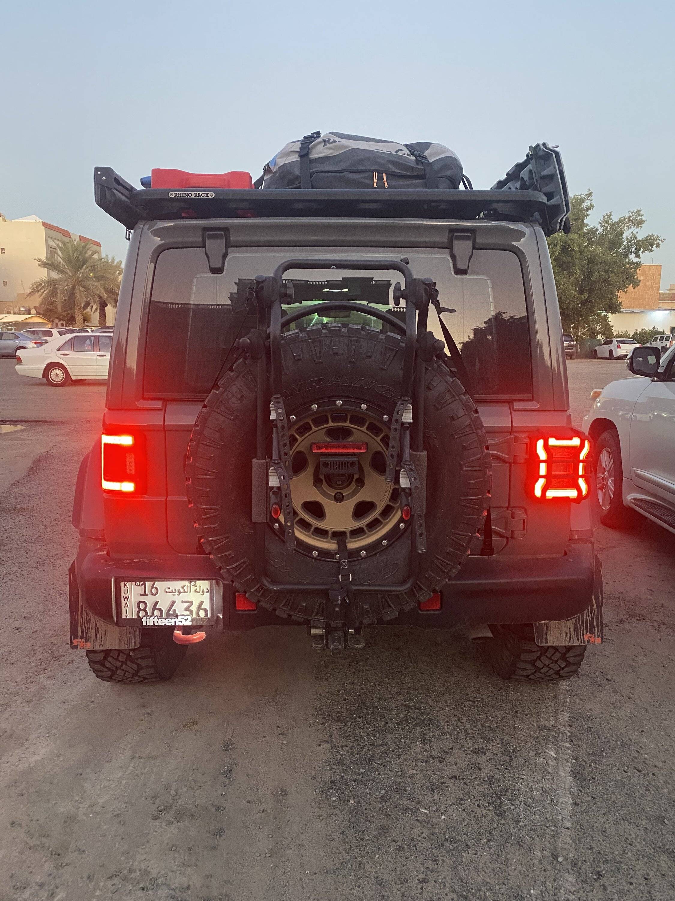

So, I recently bought the flush mount LED taillights from Oracle.
My Jeep is with the LED package but it’s EU / ME spec which got the extra (seperate) turn signal wire.. the running/brake/reverse work normal, i combined the turn signal wire with the brake wire and the turn signal works BUT when the brakes are applied the turn signal stops in favor of the brake light. Plus when I’m driving normal and apply the brakes for more than 3 seconds the dash message for the faulty turn signal comes up.
if anyone got any ideas on how to make this work would be appreciated!

@ORACLElights if you know how to fix this let me know ? i wanna run the lights but I can’t go without turn signals

Only way around this currently is by setting the rear lights to US spec using a programmer such as Tazer or JSCAN.

wow thanks for the quick reply! One more question, which tazer do you recommend the lite or mini for this issue? I don’t know which one can do this.

Lite will not allow lighting submenu. Only the Mini will. My personal recommendation would be to go the JSCAN route. It's much less costly and works through a smartphone app, rather than the vehicle's instrument panel.
Visit www.jscan.net for more info
