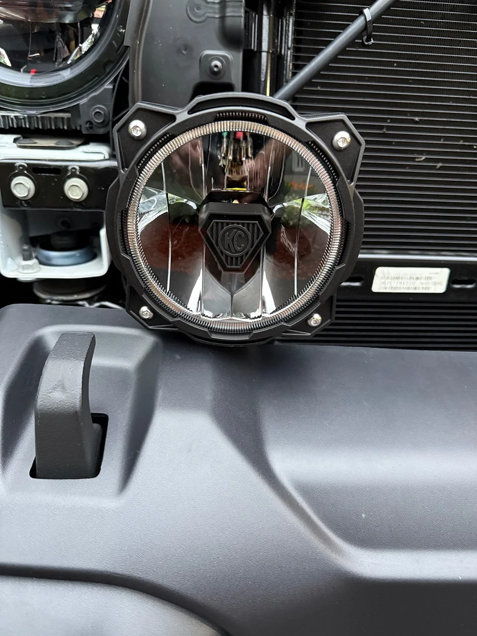

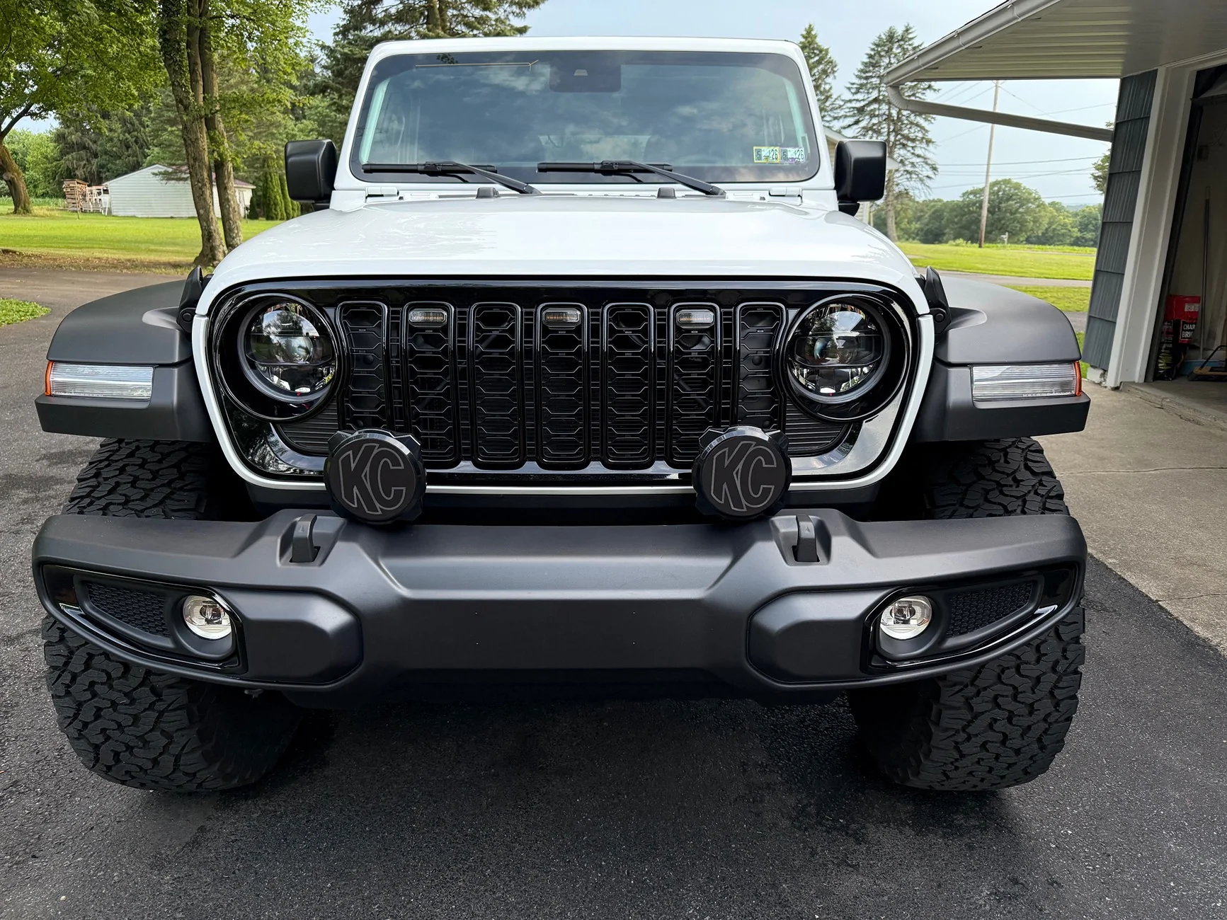

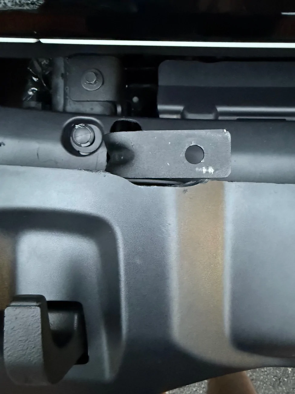

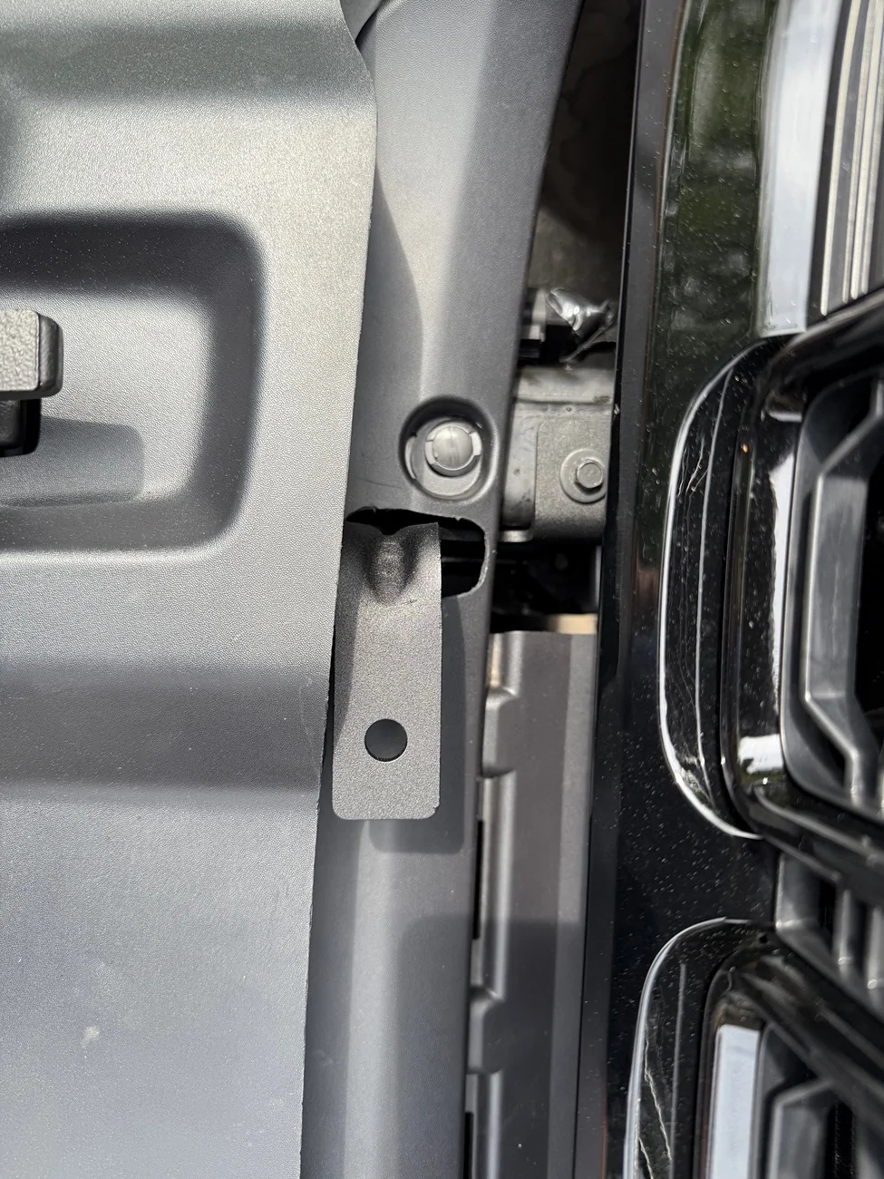

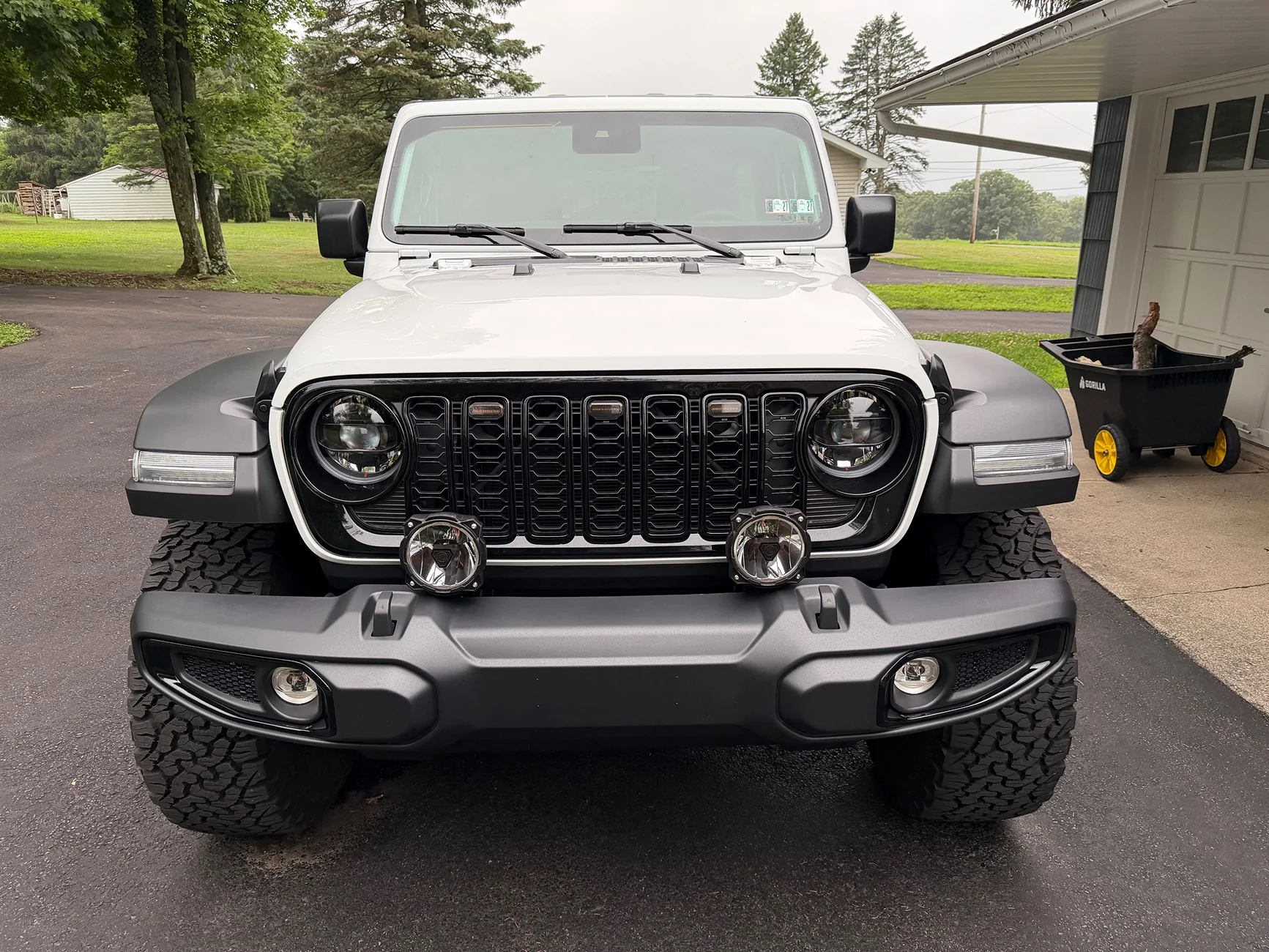

I also live in an area with a lot of deer. I went with KC HiLites Gravity Titans in driving beam. I used their optional wiring harness to wire them into the OEM headlights. This keeps me legal for PA State Inspection. I used the Mopar mount brackets to use them with my stock plastic bumper. I have them aimed straight ahead and they do a great job of lighting up the sides of the road. I’m very pleased with the performance of these.
https://www.kchilites.com/gravity-titan-led-pair.html
https://www.kchilites.com/wire-harness-adapter-jeep-jl-headlight-6325.html
https://www.quadratec.com/p/mopar/light-bracket-pair-jeep-wrangler-jl

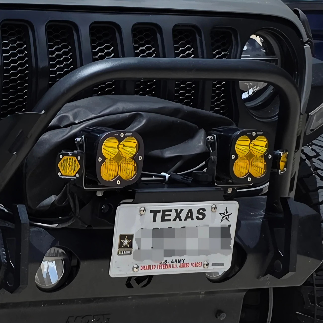

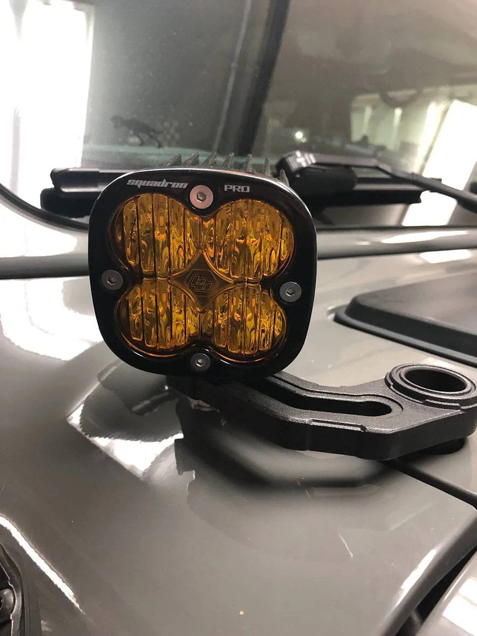

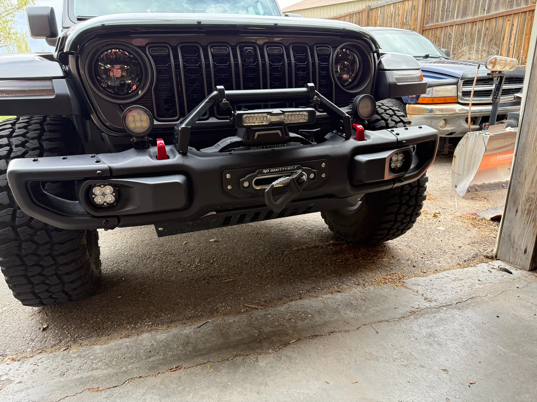

Baja Designs LP4 Combo on the bumper. Baja Designs Squdron Pro used for ditch lights on the cowl with Seven Sparta mounts. Even though I have the factory auxillary switches I have lights wired to a JL400 grab handle switch.

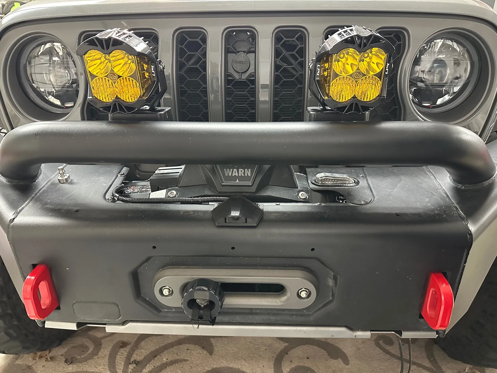

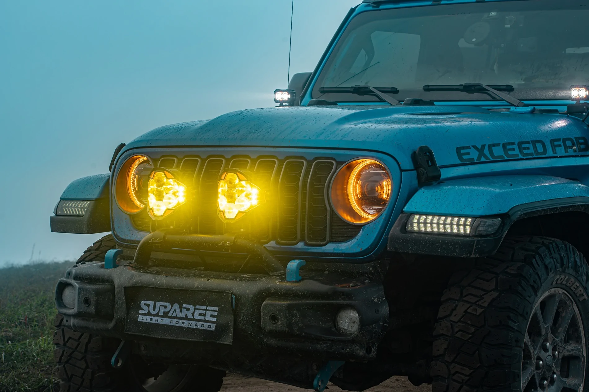

Hi Eric,
Thanks for mentioning us! We went through your whole post.

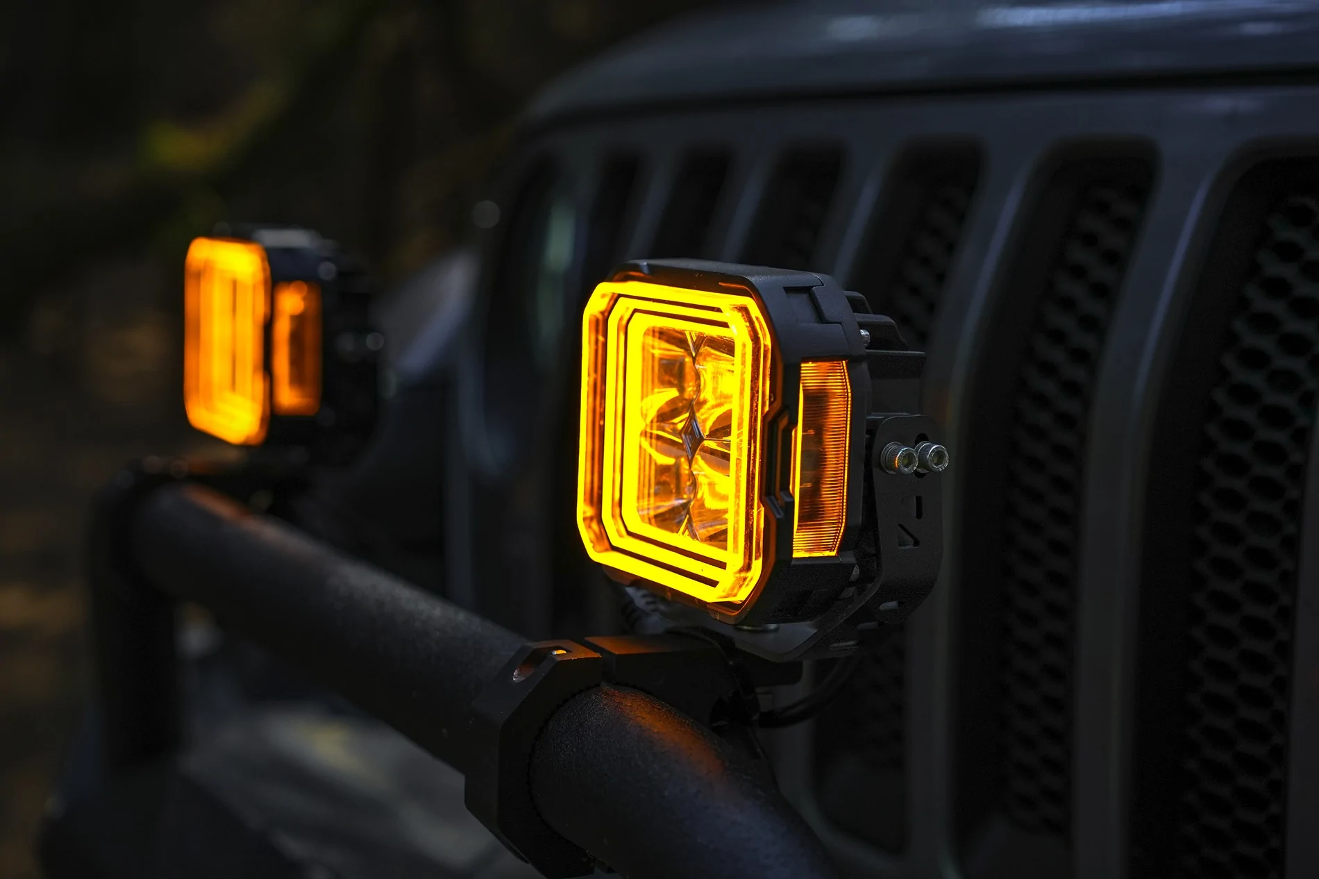

For your situation, our first recommendation would be the HELM 7. It has up to 217° of lighting coverage and 26,692 lumens, so it’s great for both distance and lighting up a wider area around the vehicle. For driving around cornfields and watching for deer, the wider coverage would definitely be helpful. It also works really well with a front bumper setup.
With the amount of light the HELM 7 puts out, you probably wouldn’t need to save room for another two forward-facing lights. It should be more than enough for your setup.
Jeep Wrangler JL Help me plan my lighting project 1785727301643-7o
Jeep Wrangler JL Help me plan my lighting project 1785727361460-wo
Another option worth looking at is the Hyper 5. It has up to 150° coverage and 4,556 lumens. Since you mentioned wanting to leave room for future upgrades, concerns about mount strength, and not wanting something too overwhelming, this might be a good balance. It’s also smaller and lighter than the HELM 7 (5-inch vs 7-inch).
Jeep Wrangler JL Help me plan my lighting project 1785727561637-dc
Jeep Wrangler JL Help me plan my lighting project 1785727615959-10
Both lights include the wiring harness and switch, and they can work with the auxiliary switch systems you mentioned. Just make sure the switch system can handle the current draw.
We’re also working on our own switch panel, so hopefully we’ll have more options to share in the future.
These are just some ideas based on your setup. Either way, we’d love to see what direction you go with your build.
