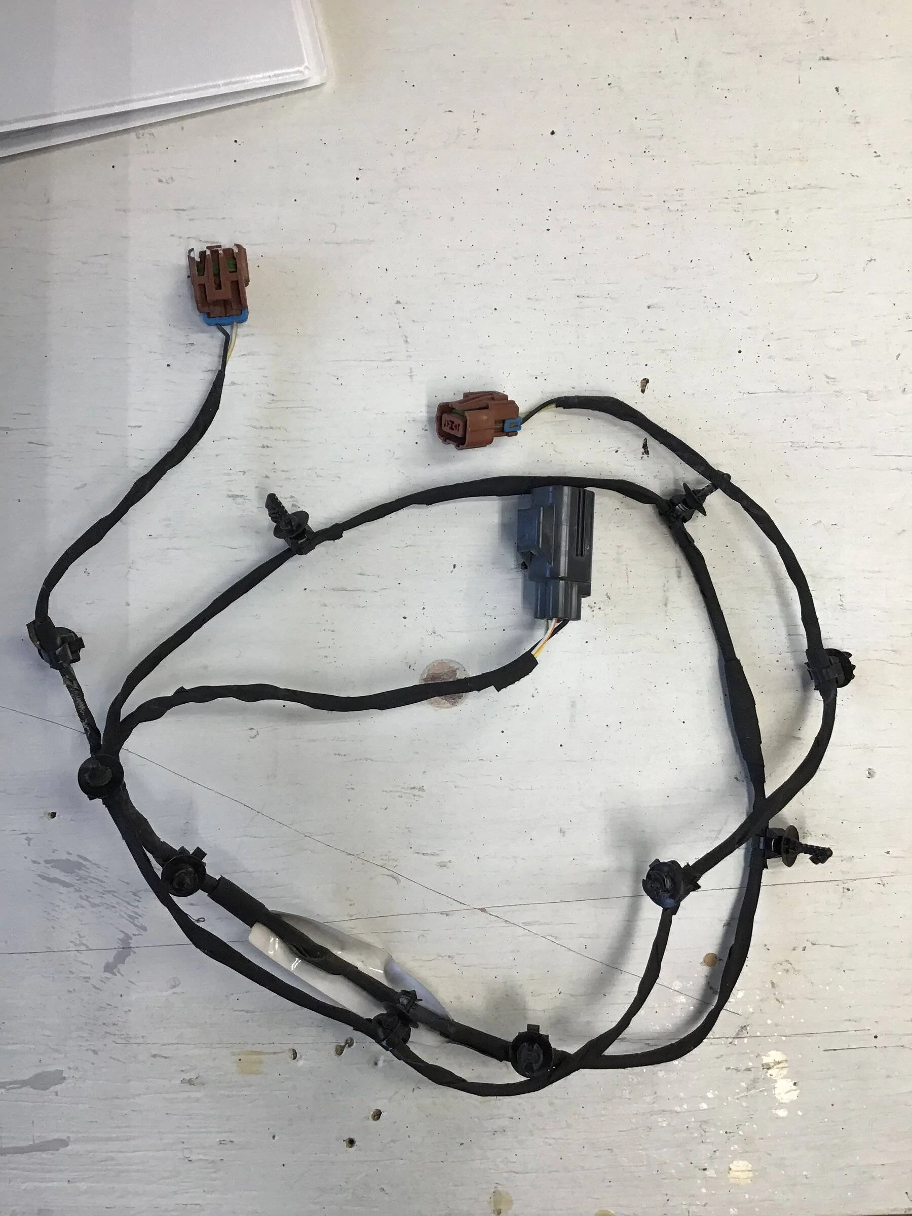

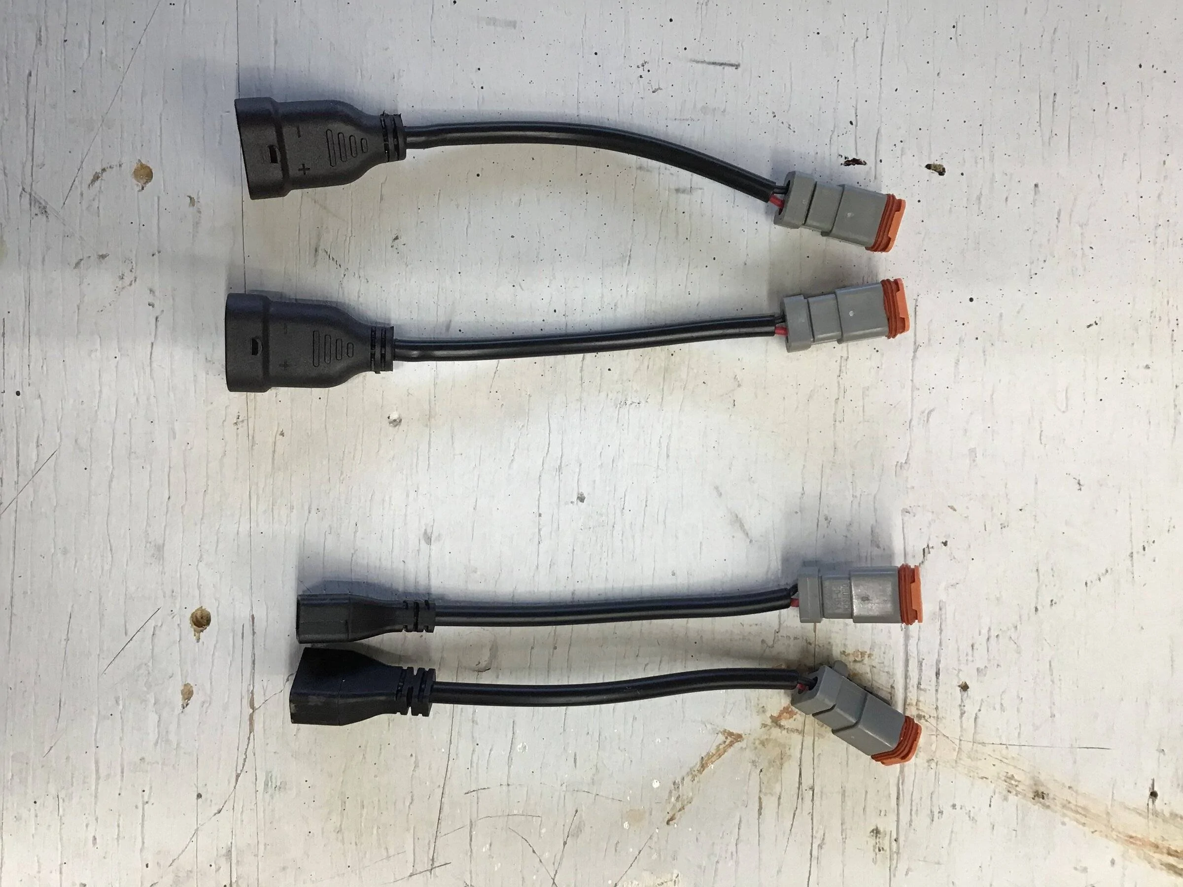

If you are getting the lights through Diode Dynamics I would see if they can throw in the wiring adapters that are in the JL fog light kit. I just got their Jl fog light kit and included wiring adapters to make the factory harness plug and play
Jeep Wrangler JL Is My Lighting Plan Feasible? 8DEEA200-866B-4FB4-BC6D-58F3ABC1649B
above is the Diode Dynamics adapters for 9006 to dt and 5202 to dt that come in the fog light kit

above is the fog light harness from my Rubicon steel bumper

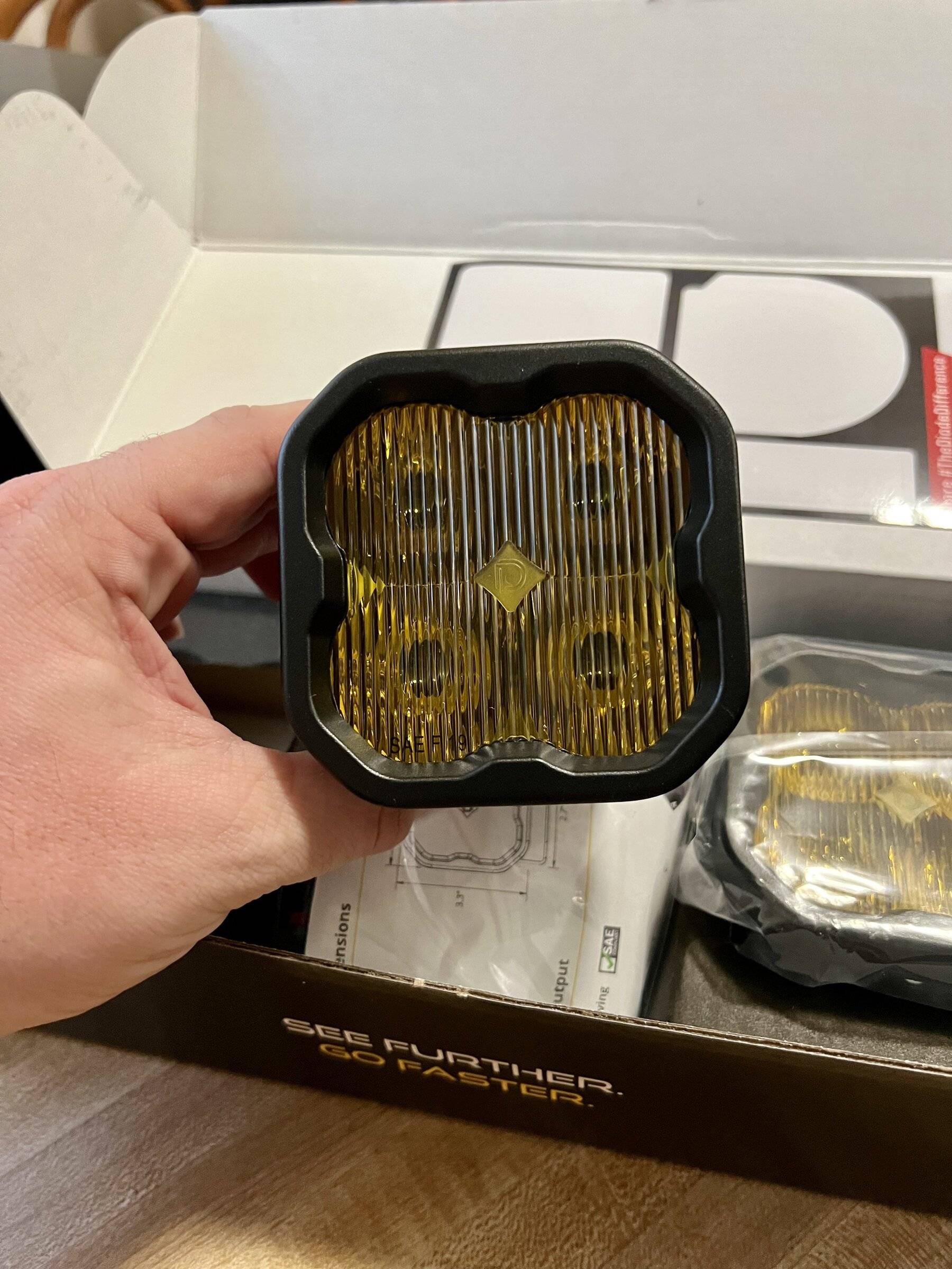

I had a bunch of Amazon points so I got everything from there. Also, I ended up going with the Sport lights instead of the Pro. From my research it seems that although the Pro is brighter, the Sport is actually a better fog light.
I've been running yellow/amber sports in my OEM bumper for about a year now. They are a fantastic fog light. No issues whatsoever.

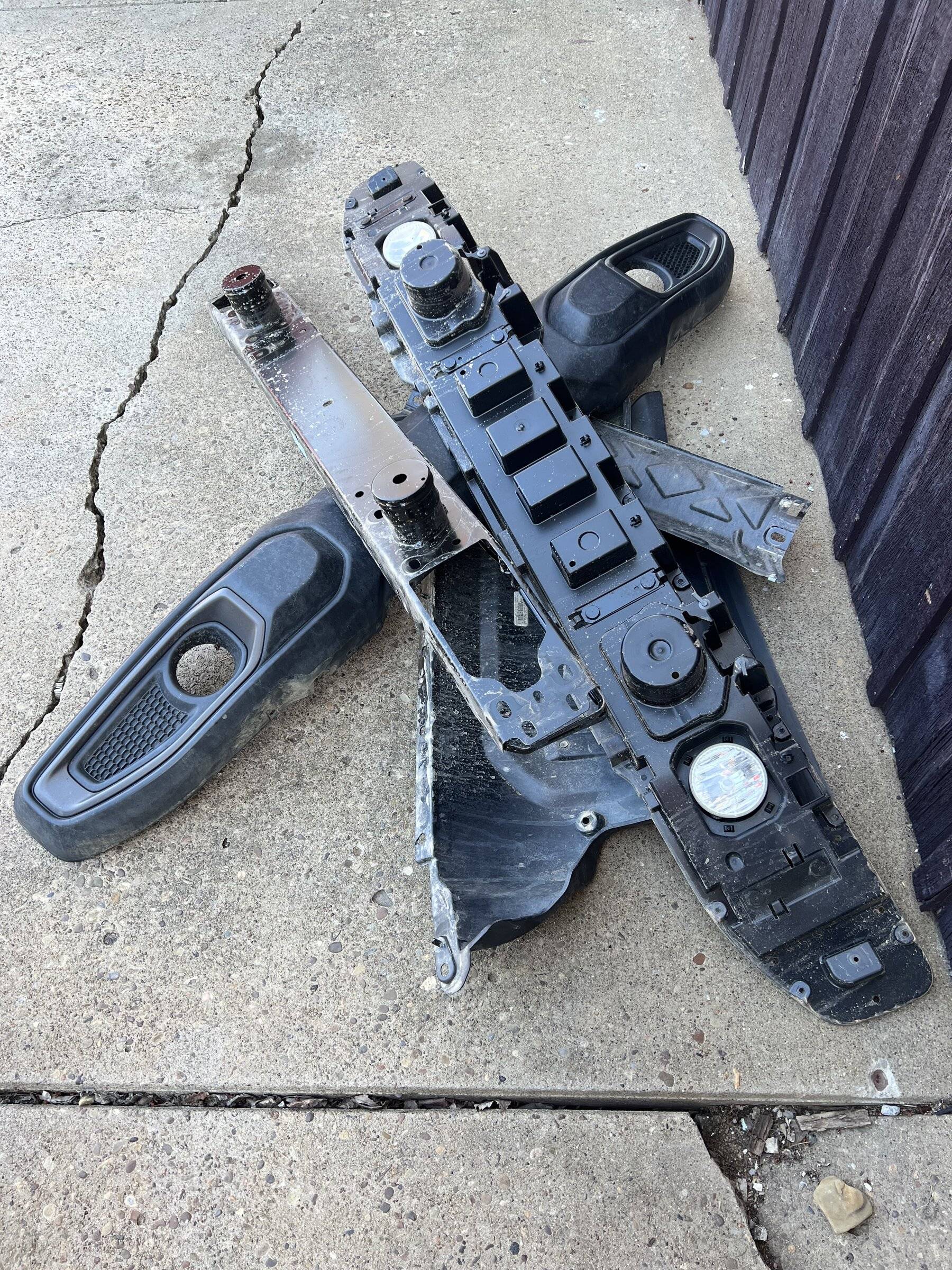

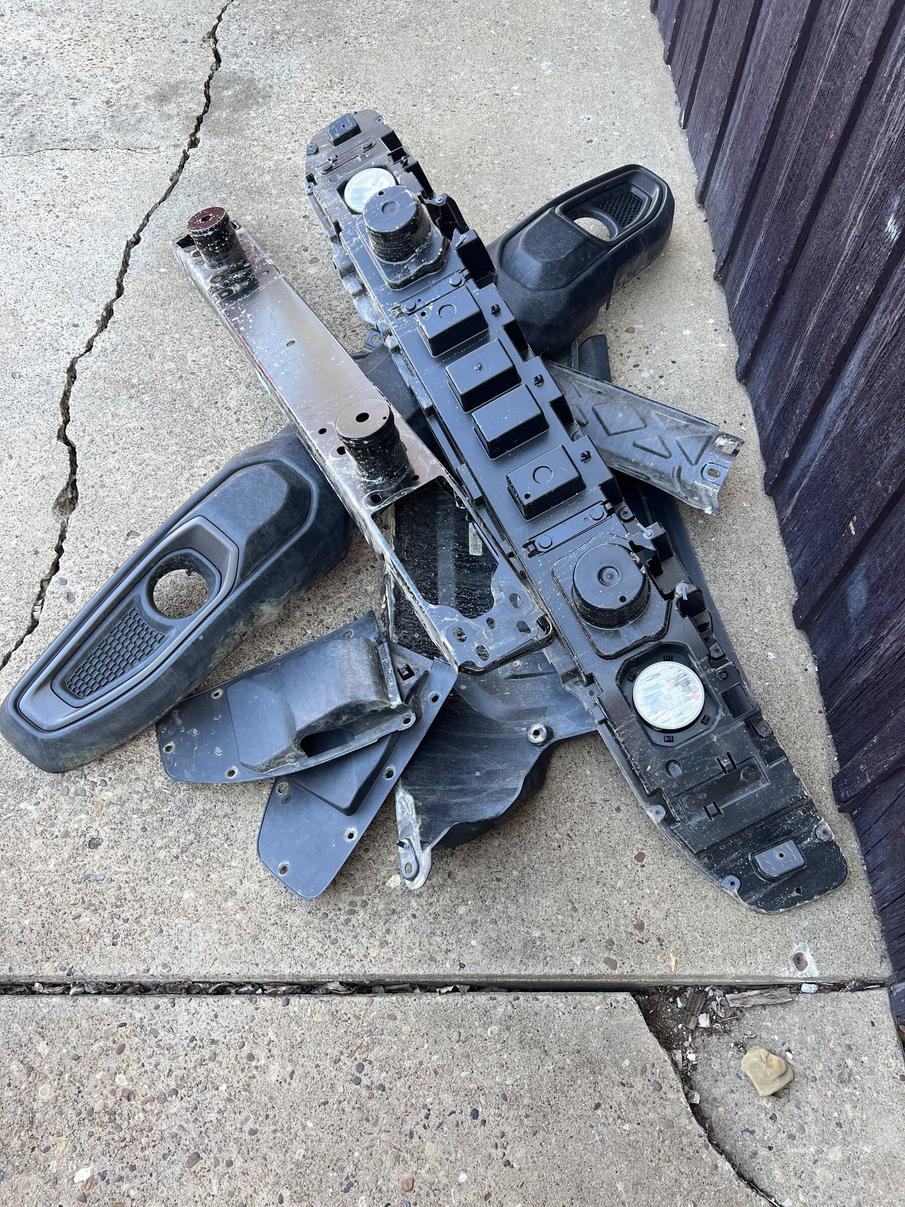

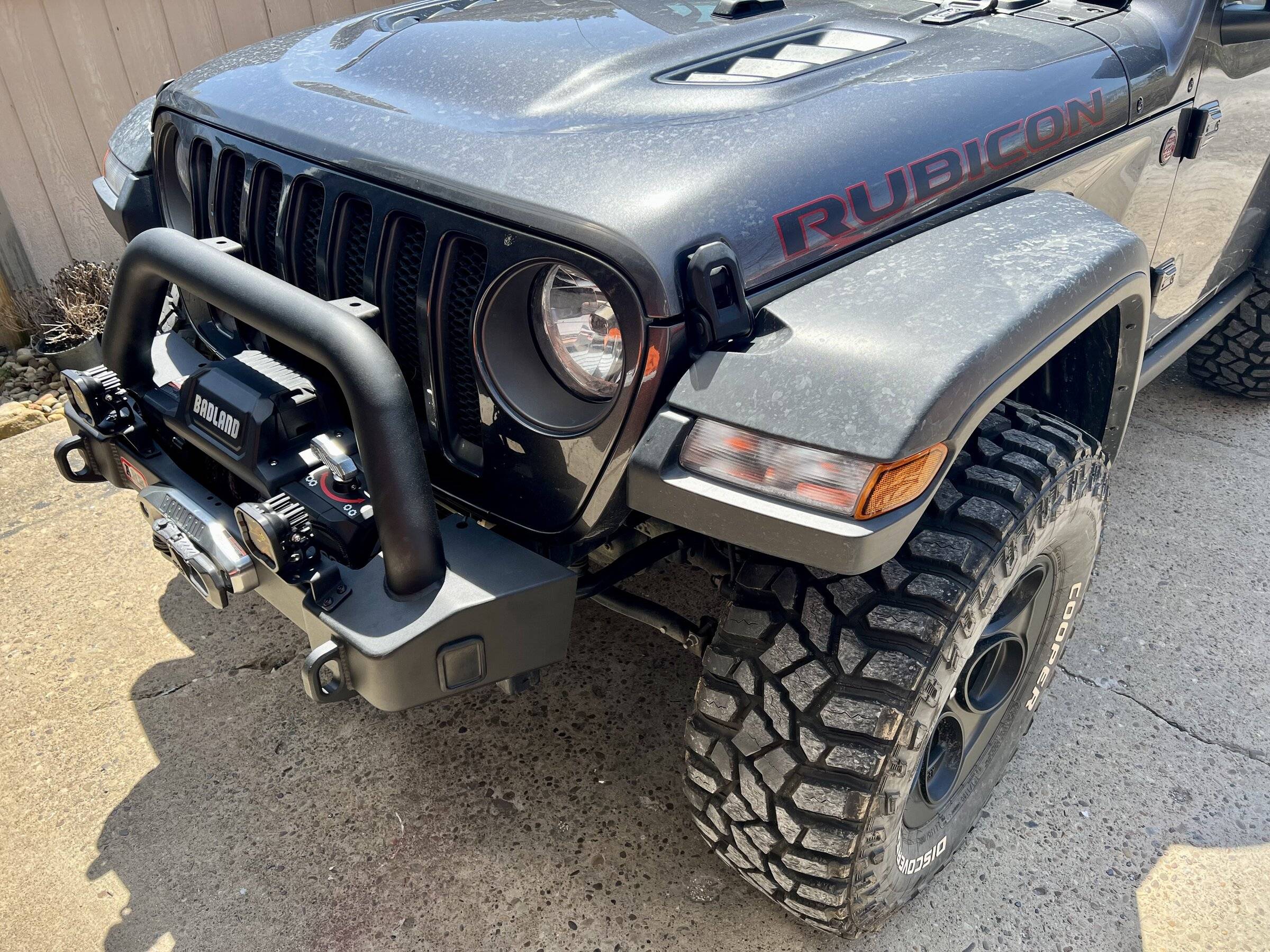

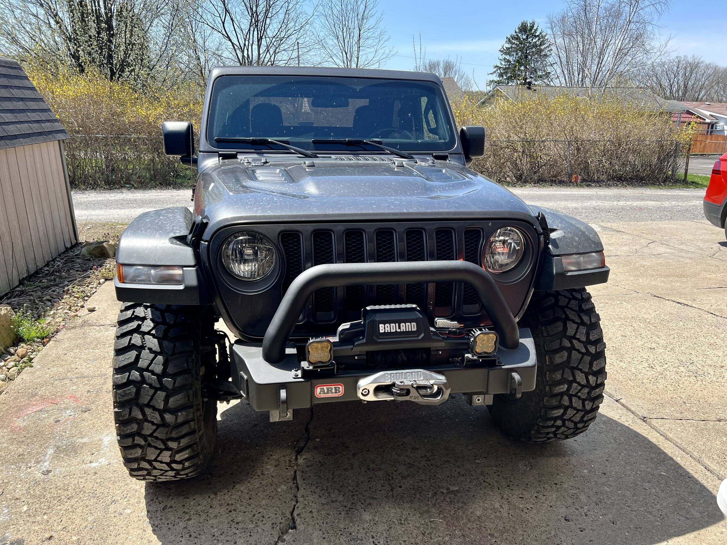

Worked like a charm. I did have to change the polarity of the adapters but that was easy as eatin' pancakes.
Jeep Wrangler JL Is My Lighting Plan Feasible? 032D8D67-43AA-4E4F-A286-386382FF15DE
Jeep Wrangler JL Is My Lighting Plan Feasible? D6AA6CBF-59EA-4FA1-B799-1A668C433DB6
Who's idea was it to put the harness inside the bumper :facepalm:
