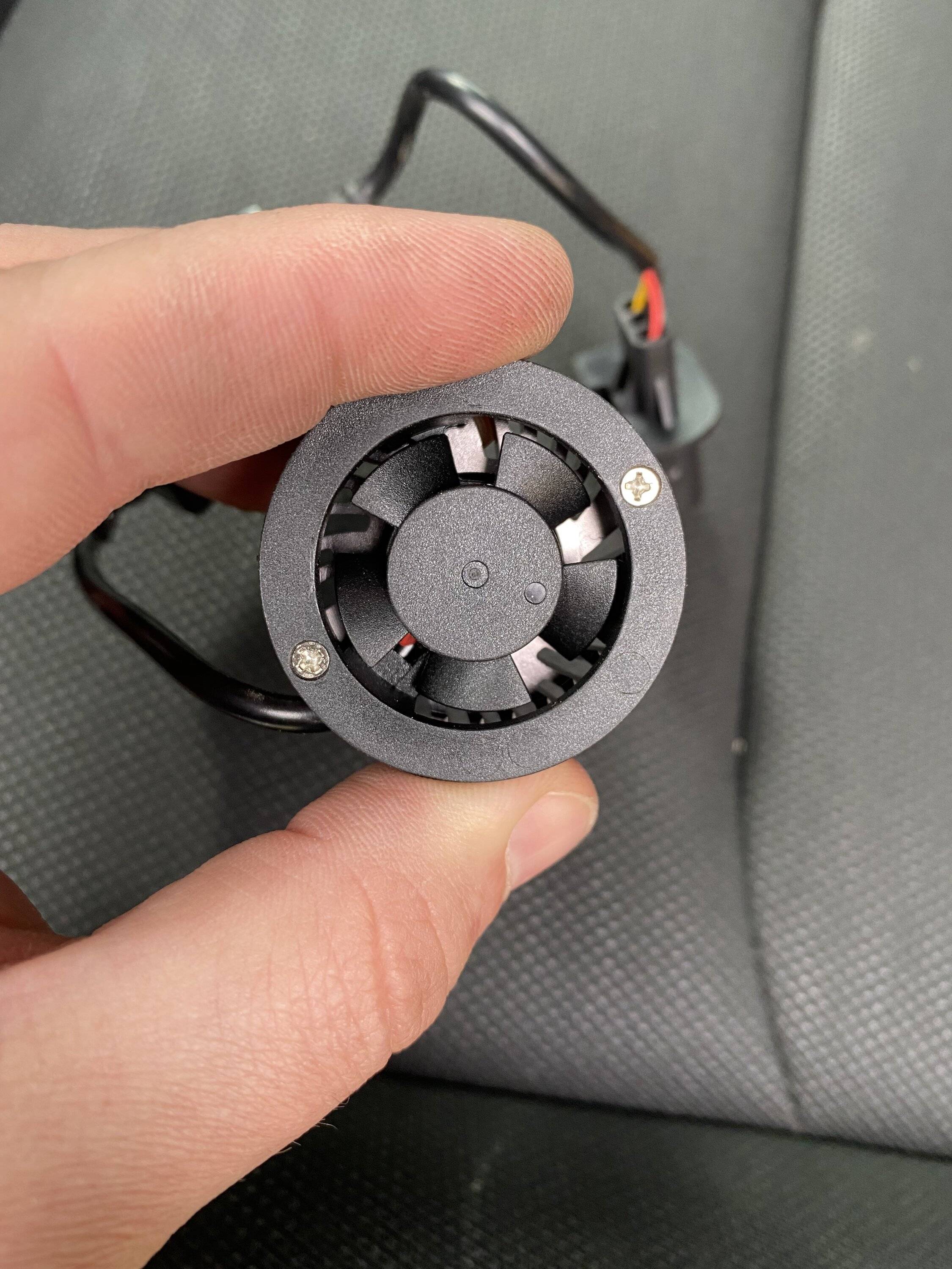

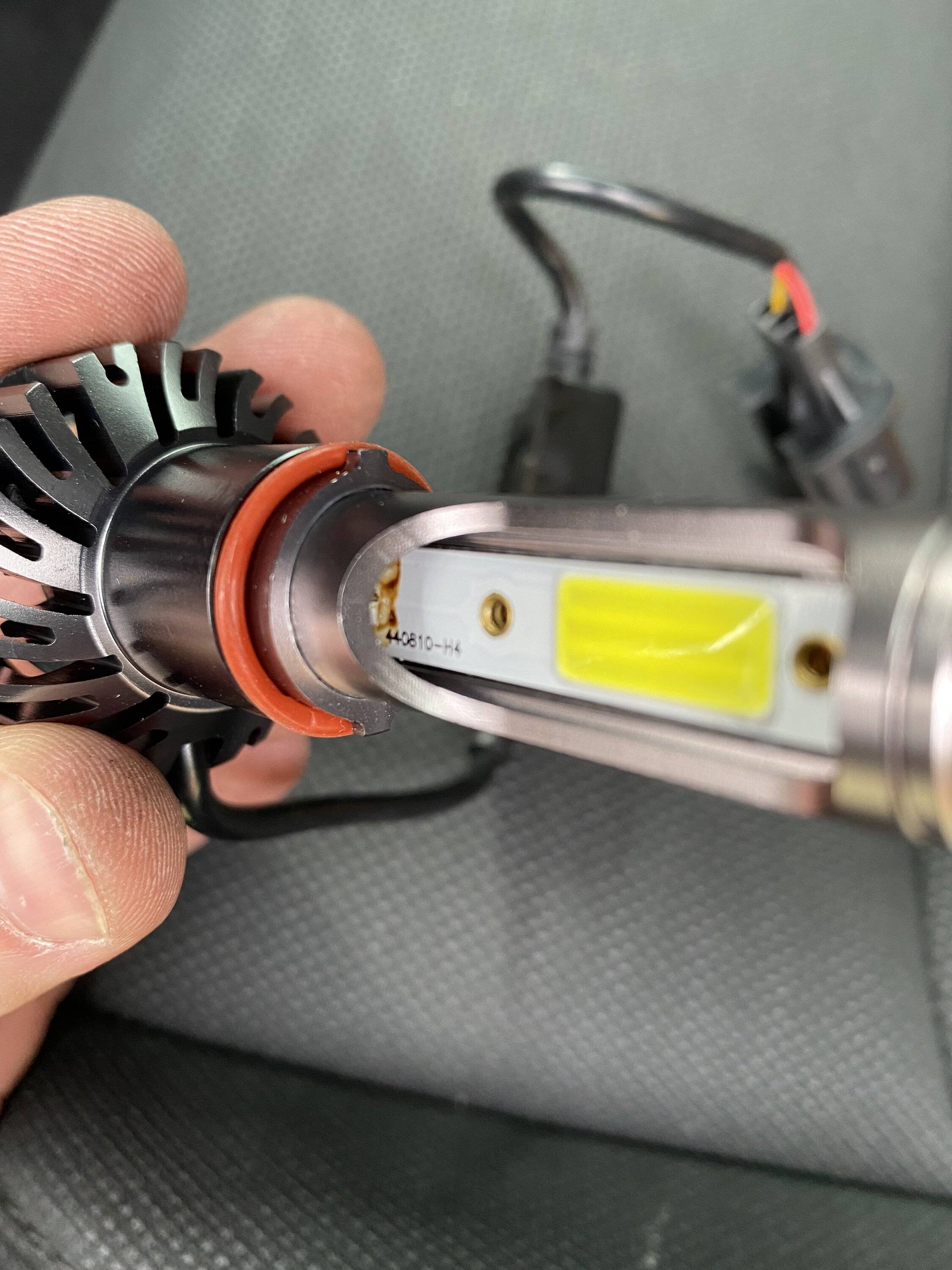

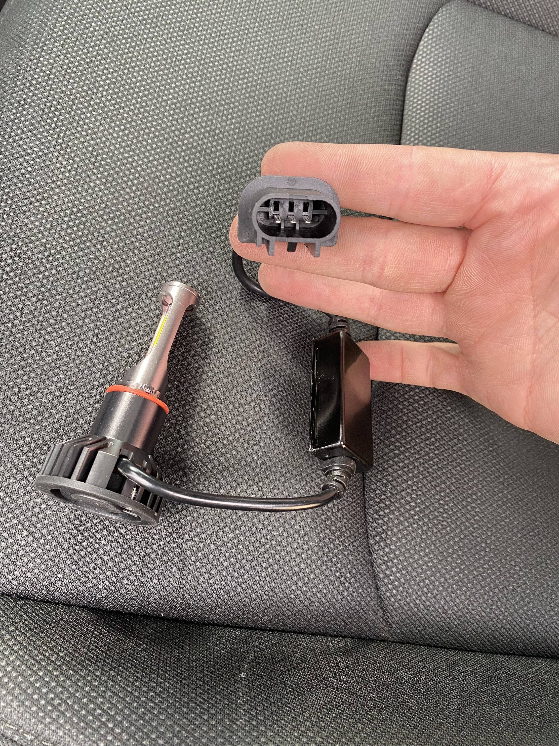

Hi all, first post here so I apologize if this was done wrong. I’m sure someone will let me know lol. Im having issues with my 2019 JL’s lights. They are aftermarket (not sure brand), I’ll post a pic. The low beams all of a sudden do not work but the high beams are fine. All other lights work as well. I’ve metered the bulbs, one is showing power the other is not, but again, the high beams work so im very confused. They are a dual beam set of LEDs. I’ve tried checking the main harness connectors-no visible corrosion and everything was seated. Fuses show power so assuming no problem there. I bought the jeep used a few months ago and been trying to figure out all the parts the previous owner put on it. Could one bad bulb cause the other not to work? Any help is appreciated.

You should start by simplifying things and putting a set of new halogen bulbs in for testing, particularly if you don't know what kind of LED bulbs are in there now.
The particular LED bulbs you have may not work properly without the vehicle being set for LED headlights. Normally you shouldn't have to change anything, since these bulbs are meant to directly replace halogens, but some bulb/vehicle combinations are picky.

I’d recommend replacing them after testing to make sure your connections are working, as @jludave mentioned.
I have similar led bulbs and I went through two sets in 4yrs…both did the same. First the low beam went out, while high beam stayed on (this was after 1 year use). I put in another set and eventually the other bulb did the same.
Mine looked like yours. I replaced both with a set from Beamtech (muchh cheaper than what I spent on the others) haven’t hadan issue with them.

Thank you for the advice! Since you went through a couple sets I’m not as concerned with the wiring now. These bulbs are supposed to last an extremely long time so it had me concerned with other issues with the jeep! Could be as simple as just having a bad batch of LEDs.
