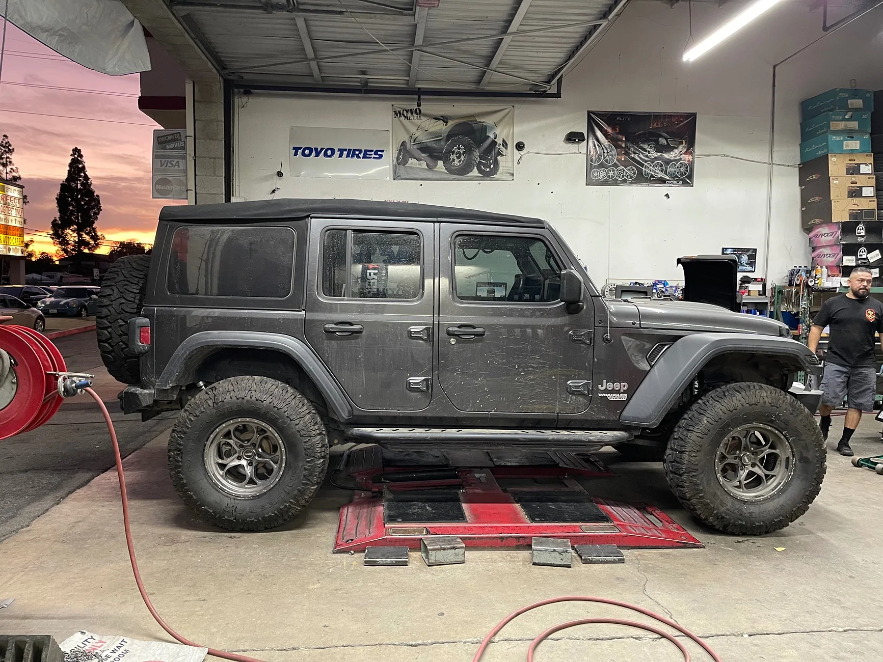

You dont have it on your list but i would recommend checking out Dynatrac. Smooth riding on and offroaf. I added .5” spacers to the front and rear to make it 2.5” all around. Here is my jeep on dynatrac with 37s. I recently switched to MC 3.5” lift but i can really feel the difference in ride quality.

Do you not like the MC as much for on-road?
