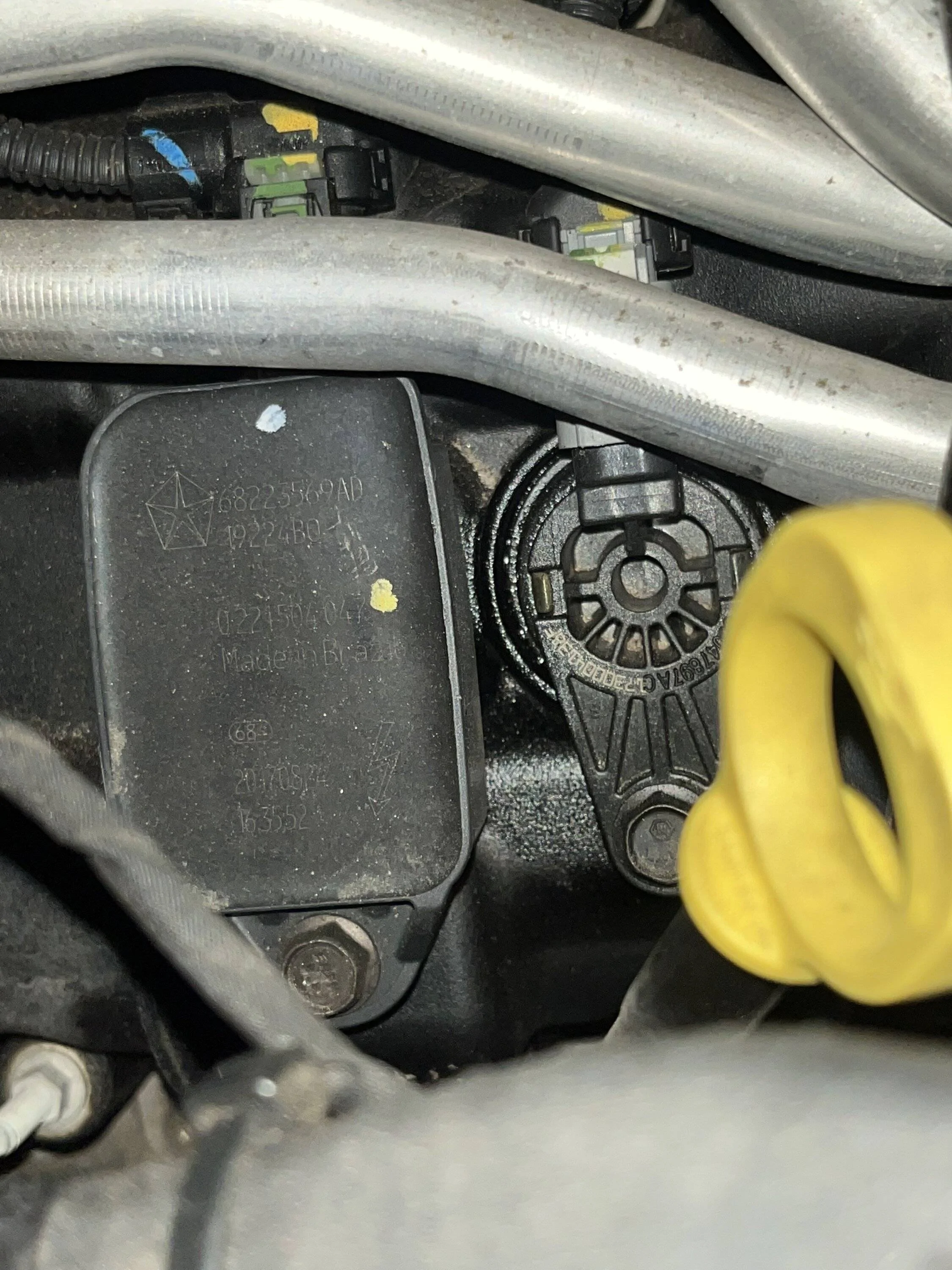

Help identify this leak please
TheOtherMe
Dec 8, 2022
71
47
Rocklin,CA
2019 Sport S
For reference, this is on the passenger side valve cover just behind the oil dipstick.

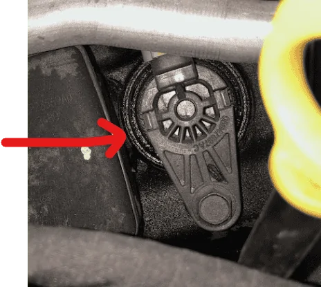

Replace the o-ring that's under here:

Do you have any pictures that aren't so zoomed in? Or maybe a video?
If the packing shown in the picture is letting oil vapor by, that would explain what I'm seeing here. The crank case pressure and oil vapor get pushed out of the passenger side valve cover through the PCV system. Check that at the same time and make sure it's not clogged up anywhere.
There's a fitting on the very back of the valve cover that will run across the top of the engine to the manifold on the drivers side. That's the PCV line.

Thank you for the response. Forgive my ignorance, but what is that part you're pointing at so I know what o-ring to look for?

Super common leak, VVL solenoid o-ring. Not really an issue as it's small, and can be rather difficult to fish out.

My 2018 had the same leak. It's the o-ring on the variable valve lift solenoid.
This is what I replaced mine with (front passenger) https://www.moparpartsinc.com/p/Jee...MIrf-k34W17QIVwxmtBh257w-9EAQYASABEgImXvD_BwE
For just the top seal I think this is the part: If it's the top seal, this is the part: https://store.mopar.com/oem-parts/mopar-seal-left-side-4893803aa
My 18 JLU Sport S is throwing codes for a VVL solenoid being stuck open and I am going to go ahead and replace all 4 solenoids as there is evidence of them all leaking... When ordering do I need 2 fronts and 2 rears or is each of the 4 solenoids a different part?
