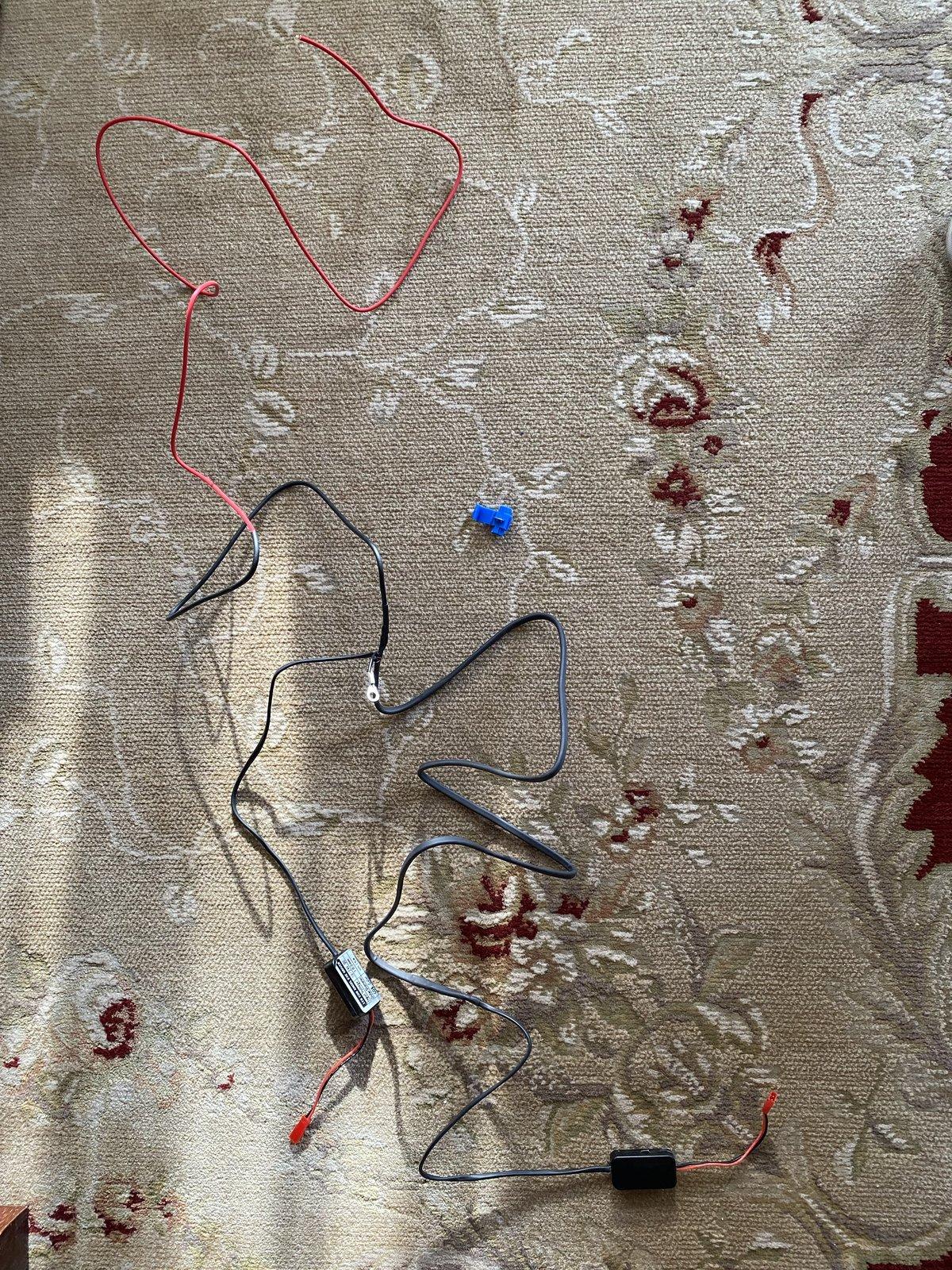

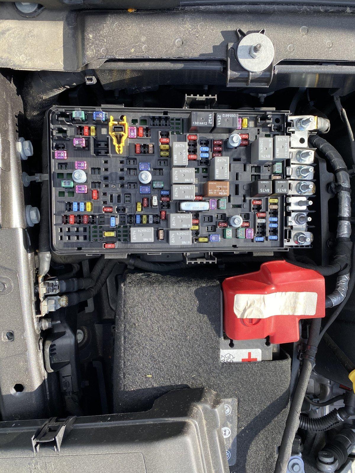

I decided to upgrade my headlights for my ‘18 JLU, and I went with Delta Lights 7in. LED with Halos. Reviews said the instructions could be confusing but people managed to figure it out. Sadly, given my lack of electrical knowledge, I’m struggling - so I’m here for help!
I included a couple pictures of my fuse box for reference, the parts provided & the directions for wiring the halos (the headlights themselves are pretty plug & play). My issue comes in at step 5, where I need to run the red wire to the fuse box, then connect it to the ignition fuse indicated in an extremely hard to see photo.
How should I go about tying in the red wire to the ignition fuse, via a piggyback connector?
Tap into F52 using an Add-a-Fuse connector. Some tie into F57 or F58 if the vehicle is equipped with heated seats. The ground can go to the ground stud on the fender, near the battery.

Thanks so much for the response. I actually just came inside from installing them. I didn't end up using the piggyback they provided & decided to go with the Add-a-fuse connector into F57 (since I have heated seats). Appreciate you getting back to me!
