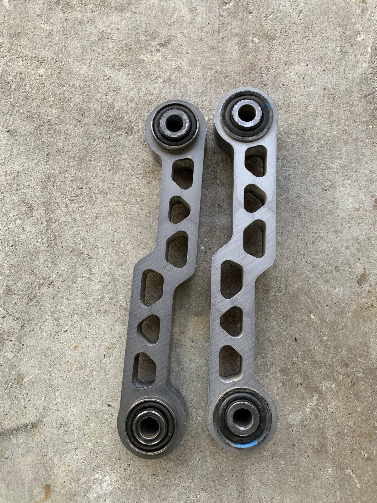

I’m resurrecting this thread to show why the no limits are the best way to go for Rubi electronic sway bar on rigs with a lot of articulation IMHO…….
I was finally able to get my hands on some MC sway links so I could show the difference between the oem style and no limits style links.
This is in “NO WAY “ a knock on MC. I love me some Metal Cloak, they’re a top tier company with great products and service…. Their links were the only ones (long enough) I could use for this because I was afraid of inverting my sway bar.
They didn’t restrict any droop because of their length, but after running them for a few weeks, wheeling and highway, I’m already compromising the axle side bushings…….The highway ride is the same with both styles, no noticeable difference in NVH , but I’m really not a very good judge of that……..The MC links are very inexpensive, though also very well made as you would expect from them…….

At 6000 miles my Clayton end links are shot.
Which size no limits link do I want for a shock drooping 29”?
I can’t find mom/max lengths of these things anywhere.

Do you know how long yours are? Or how short you can get them?
I hate talking lift height. It all depends on how you are bumped for tires and how much droop you have in shocks. Lift height is some nether-region in between.
I’ll measure them when I get home, but the lift height is important and in this case has nothing to do with bump stop… you don’t want them to long that it puts your sway bar at a ridiculous angle at ride height and yet they need to be long enough not to invert…..

My end links are adjusted to 11.5”, they are 8 “ out to out on the jam nuts…..mine are almost 5 years old, I think they only had one size back then….
With synergy springs you’ll definitely need to run limiting straps…. You need to run a dual rate like MC or triple rate like RK in order to keep springs seated in the front if you get the 6” lift shocks like mine….

It’s when it inverts or bends the other way, if you don’t have the elect disco there’s no issues…..here’s mine straight before I adjusted it longer… you don’t want it to bend like the yellow line it makes for a long day…….
