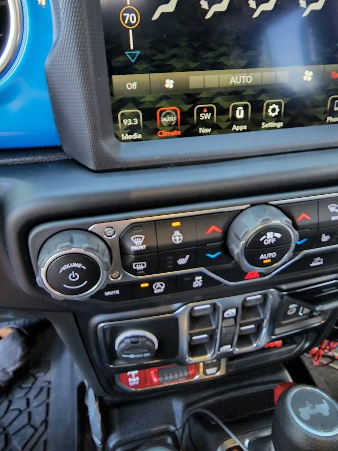

Hello all,
install is done and the seats are working. A couple of quick points for those that want to use the infotainment wiring harness.
1. I back-fed the wiring through the driver side firewall plug. Manual owners would need to find an alternative way.
2. the 12 volt connector is so long bc you are supposed to use the cigar lighter in the cargo area and move the fuse to battery. I connected to the cigar lighter in the dash and the seats don’t turn on with the auto start.
3. the heat is not as hot as my factory gladiator was. That being said, my temp gun measured 104 after I drove around the jeep for 30 min. High is still very warm and I moved to med heat and was very comfortable on a 20 degree day. It does not get blister your skin hot through. Maybe better than factory?
I hope this helps and it was easy once I figured out where to route everything. I would purchase again if I needed to do this for another vehicle

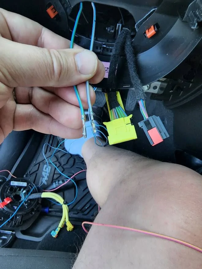

I am looking to start routing the wiring loom this weekend, any helpful tricks on how you routed the cables throughout the cab?

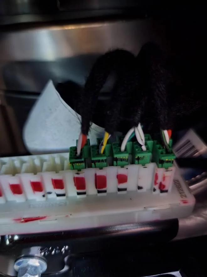

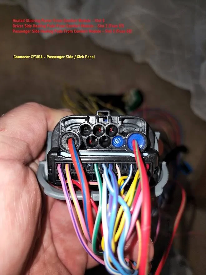

Im doing the oem/mopar autostart system. I ended up wiring it to the front 12V port since I never use it as is, we'll see how that works out. I still have plenty of line to run back to the fuse box or I can extent the wires.
Side note for anyone savy with the canbus system. I already have something in my 8th spot from the right. Any idea what it could be? I've got time while im waiting on my clock spring to come in but I didn't wanna start unplugging things just yet. I got a 21 ecodiesel with the tow package, led package, and 8.4 entertainment package.

It doesn’t matter which port you plug into, they all preform the same function EXCEPT the first one, that one has an extra wire in it. I suppose that extra wire is to power the block 🤷🏻‍♂️.

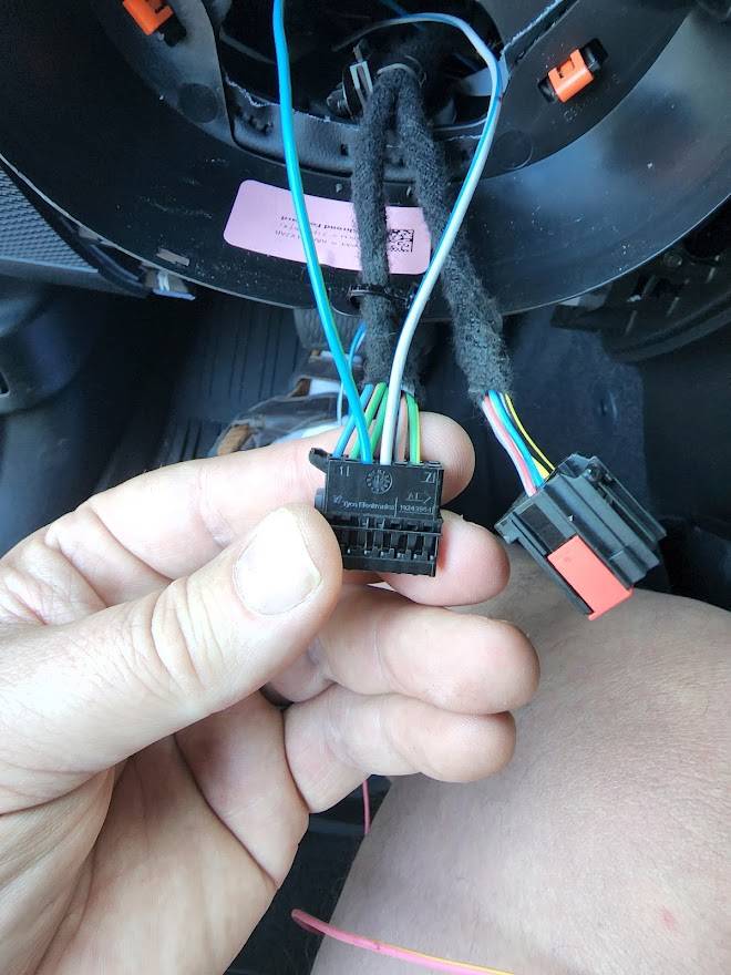

It took me a total of about 10 hours over 3 days to knock this out. First day was wiring install which was pretty self explanatory minute the 2 clock spring pins. I was lucky enough to have the connectors that were pinned out factory from the various parts I orders so I color matched that way.
Day two was seats. I found this video helpful for figuring out how to take apart the seats and do the hog rings. Took about 3 hours for the first seat (Passenger) and 2 for the driver. Word of warning, the driver is a bit more complicated due to the various adjustment knobs on the door side of the seat, which also has the airbags. Only issue I ran into was I ripped out a small bit of the foam side cable that you hog ring too on the back. Some quick Gorilla glue fixed it back up and held just find.
Day three was the steering column. It took me about two hours going slow to make sure the vehicle was completely discharged, figuring out the steering column, etc.
