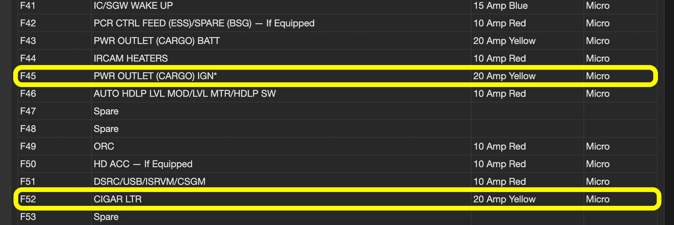

I also noticed there was 2 fuse available already marked for heated seats, according to this diagram. Are these functional and available for use in the JLs without the heated seat(cold weather) package?
So question is...
Fuse #45 and #52?
Or
#57 and #58?
I don’t believe those fuses are installed without heated seats. Pop open the hood and check.

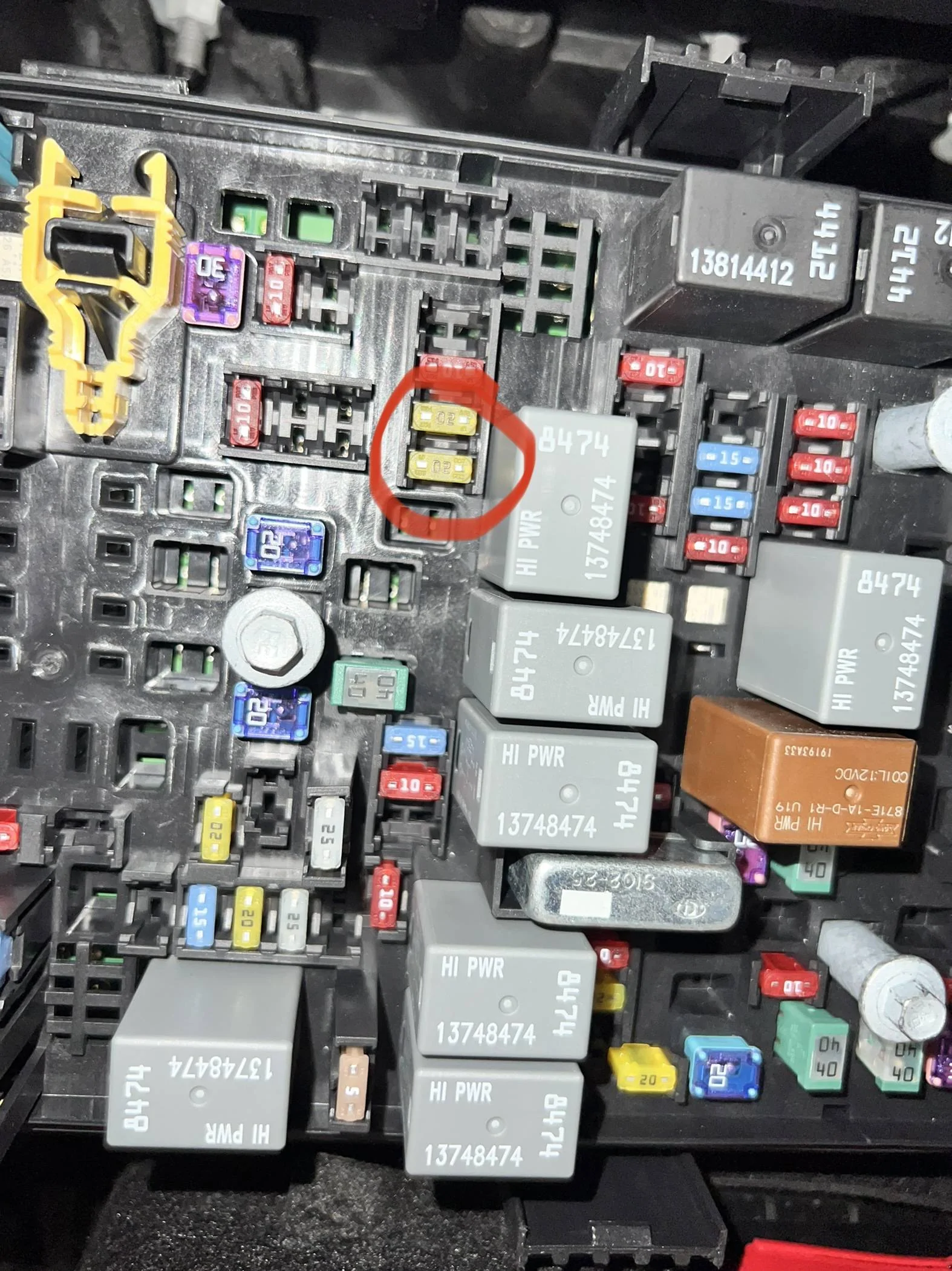

It looks like I have it in my 2020 sport s. ???? I might test them to see if they’re functional.
