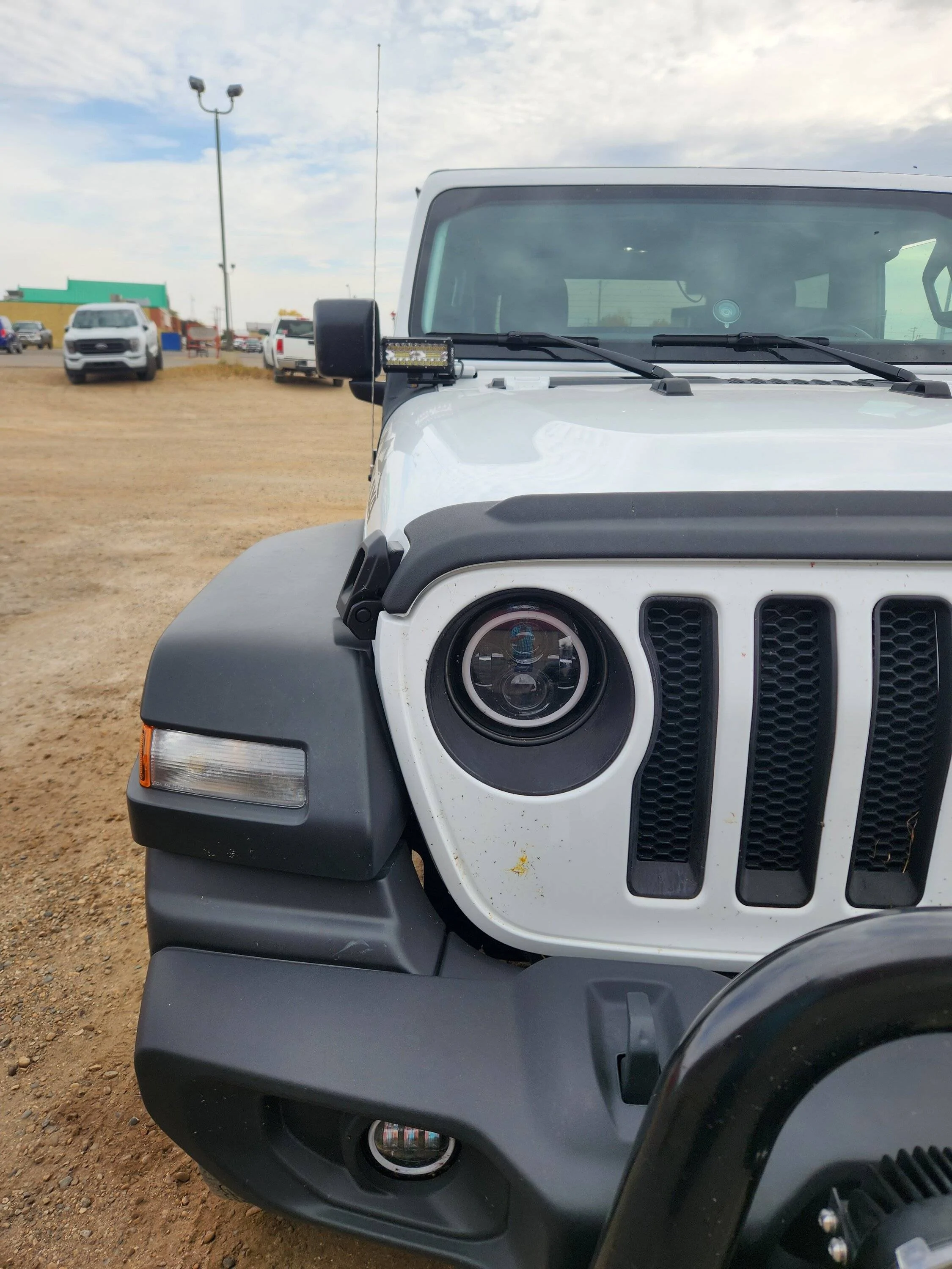

I was wondering about interference of the beam. These are the lights I have
Jeep Wrangler JL Headlight guards 20220930_114611

Can definitely see these being an issue. Thank you for bringing it to my attention.
Jeep Wrangler JL Headlight guards 515MjiLr-dL._AC_SL1500_
You may need guards that are designed with that headlight in mind, or a sheet of clear adhesive vinyl (a larger version of this, for example) that could be correctly applied to the light's convex surface. As you recognize, the RR guards would foul the proper projection of the LEDs in your lights.
