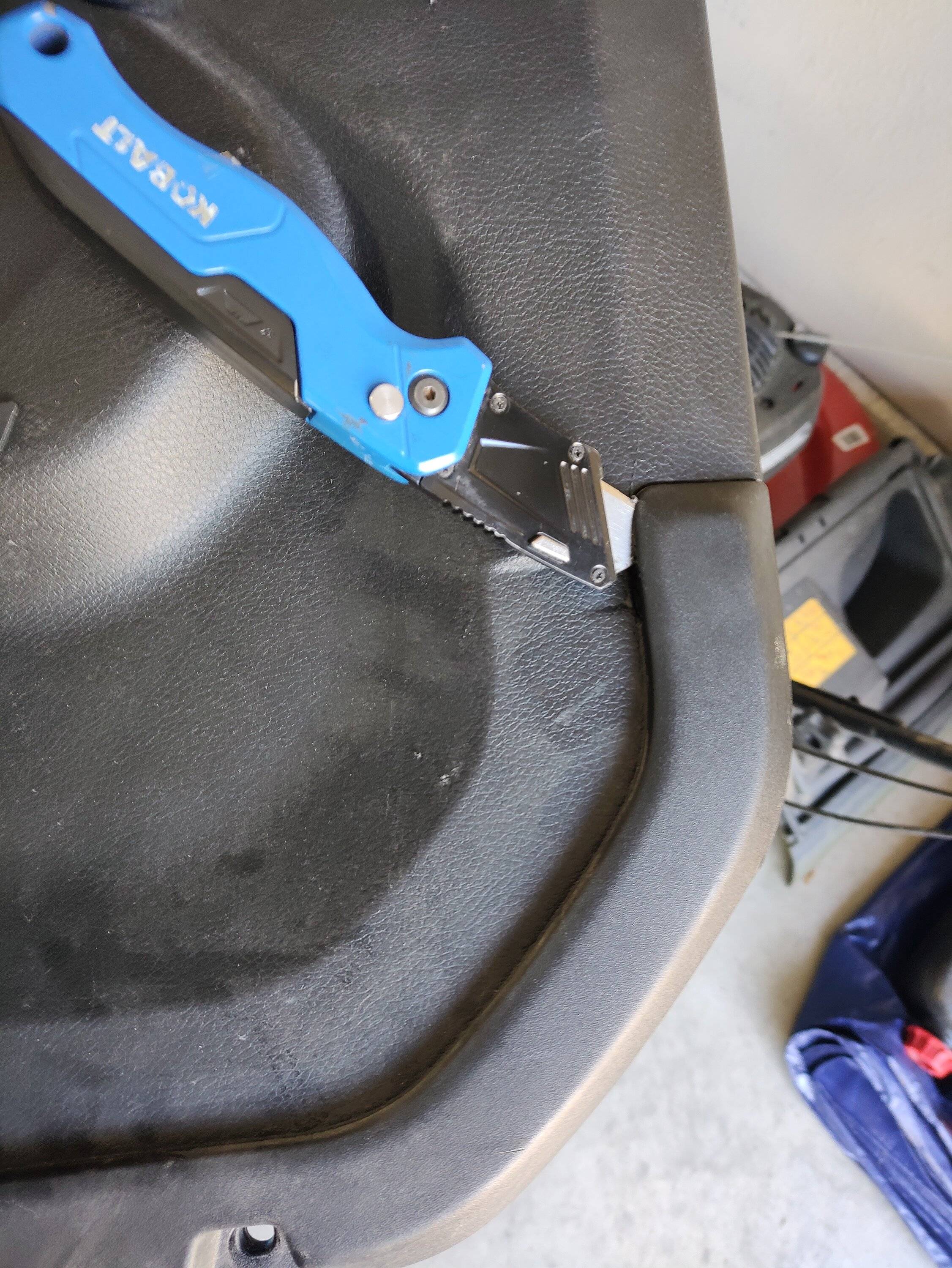

i just cut all four nets and i think it actually looks much better. has anyone else done this? i imagine a few have.

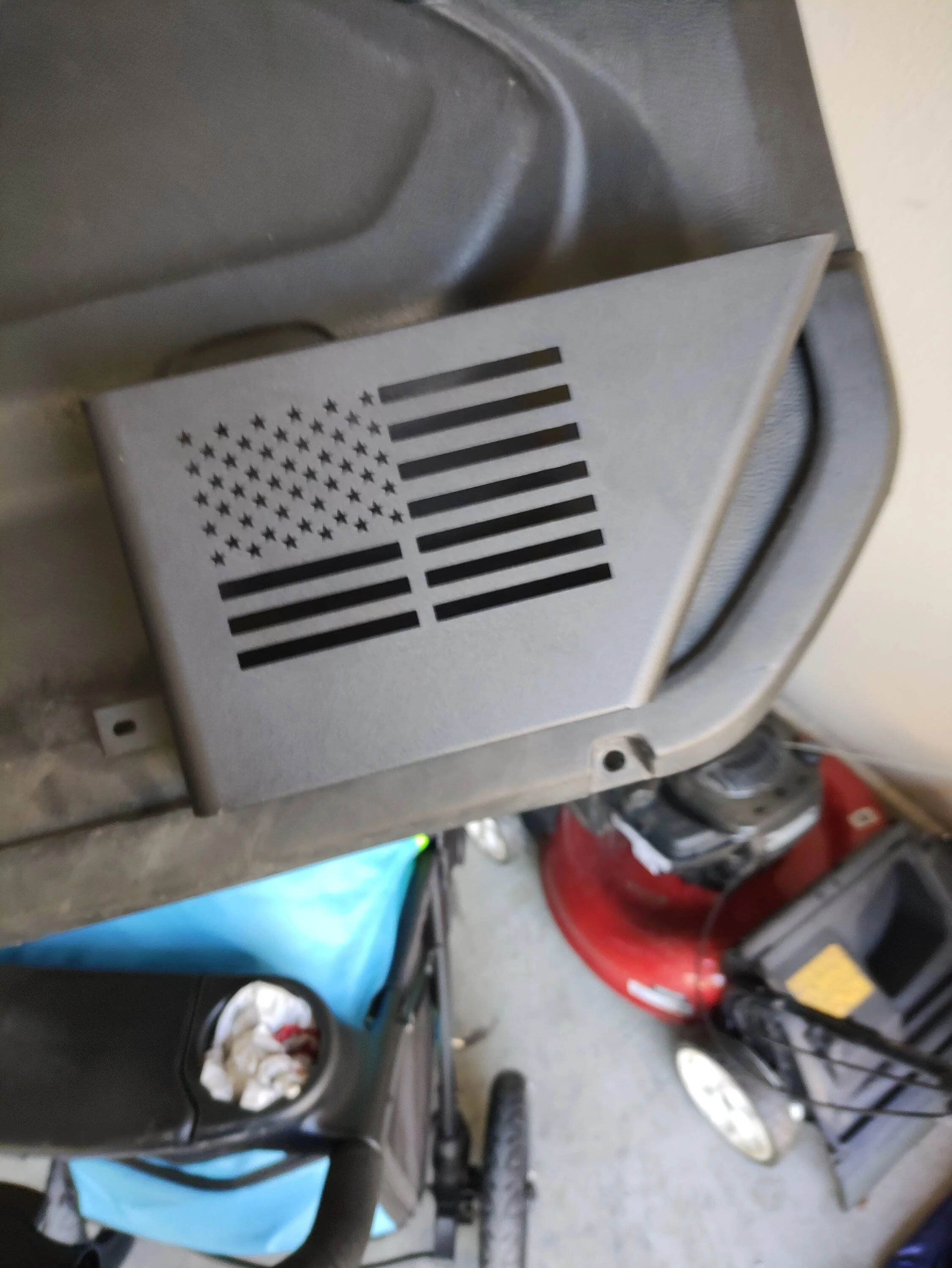

Now here's the fun one. I've had my driver side door panel off for a minute now...

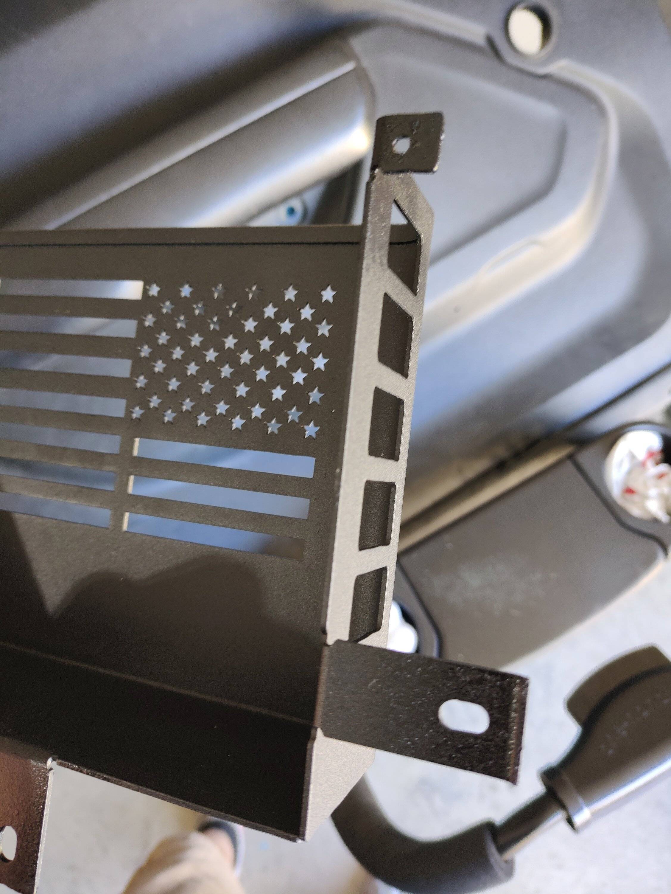

I want to replace the netting on there, because it's absolute trash! However I didn't want to spend 160 bucks for a metal replacement. So I've kept it off for a week now, and then Friday night I ordered this guy from Amazon.
$38 from Amazon, I thought they were cheap plastic, but they're actually cheap aluminum. :LOL:

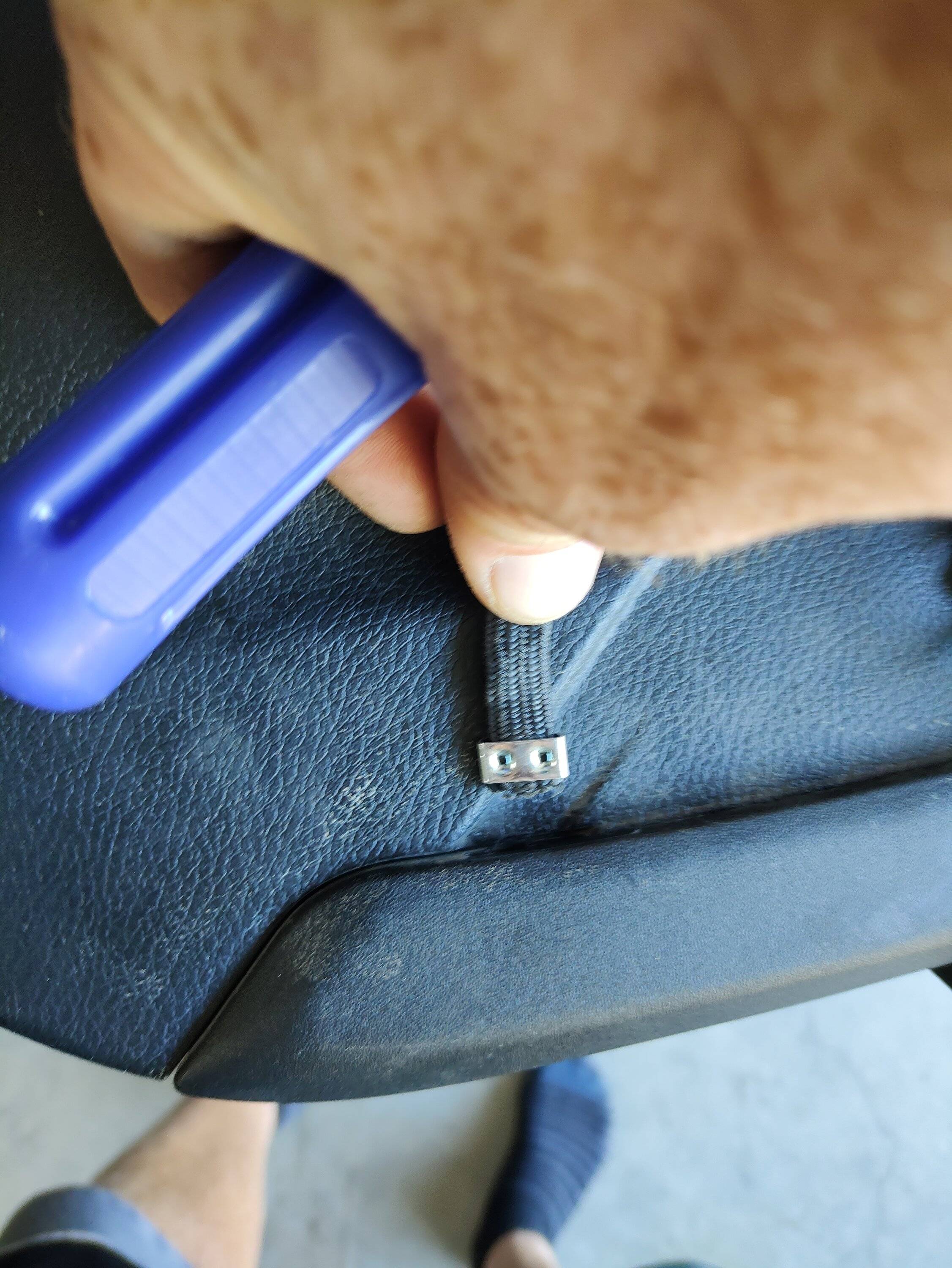

I figured out how to get the netting off of the door without just cutting it off. Not super complicated, but kind of annoying.
Just a little wire on the bottom, and two clips on either side.

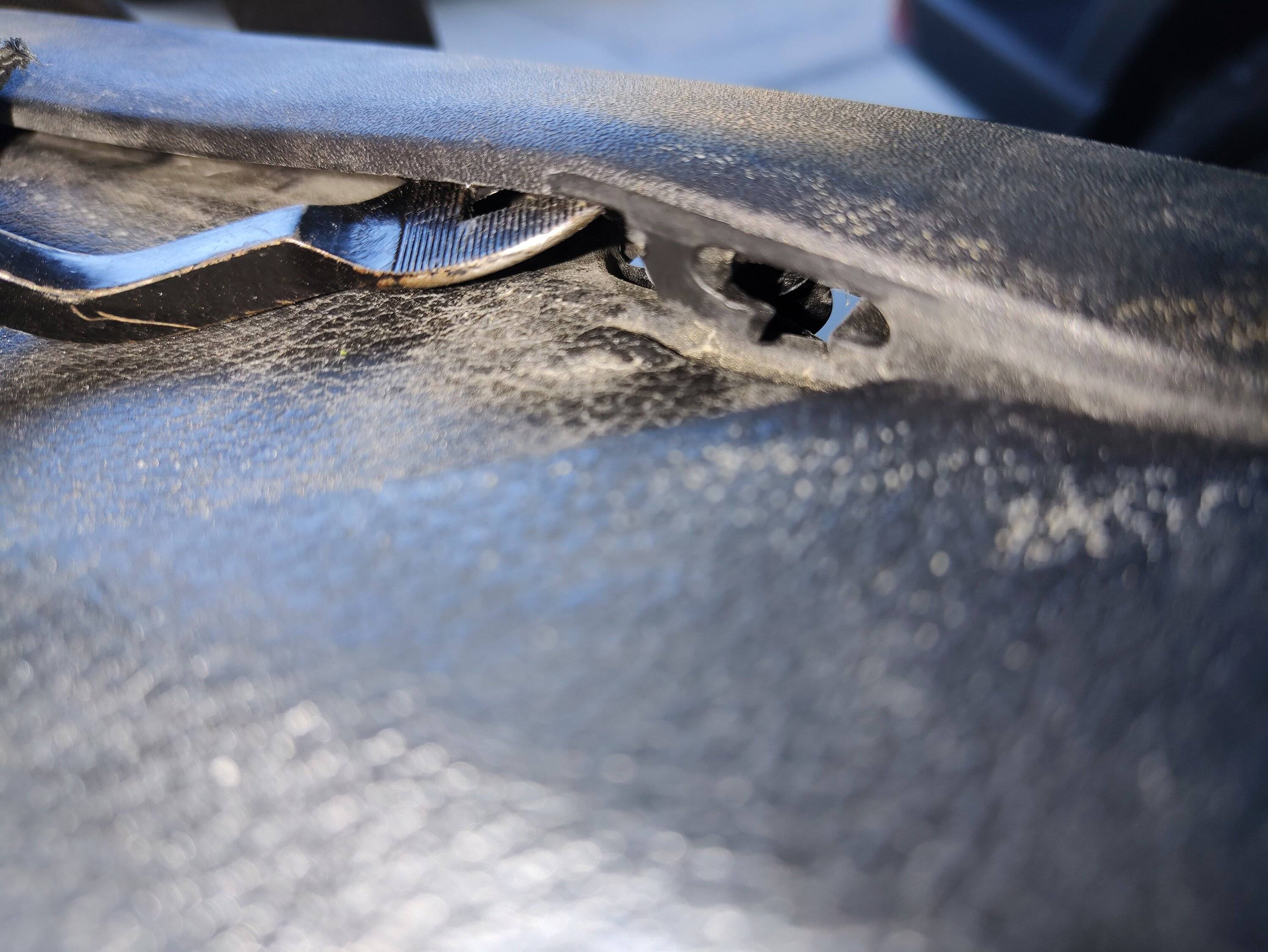

Pretty self-explanatory up till here, use the trim to lock down the far upper right tab and the bass tab which I trimmed so it didn't have a bend in anymore.

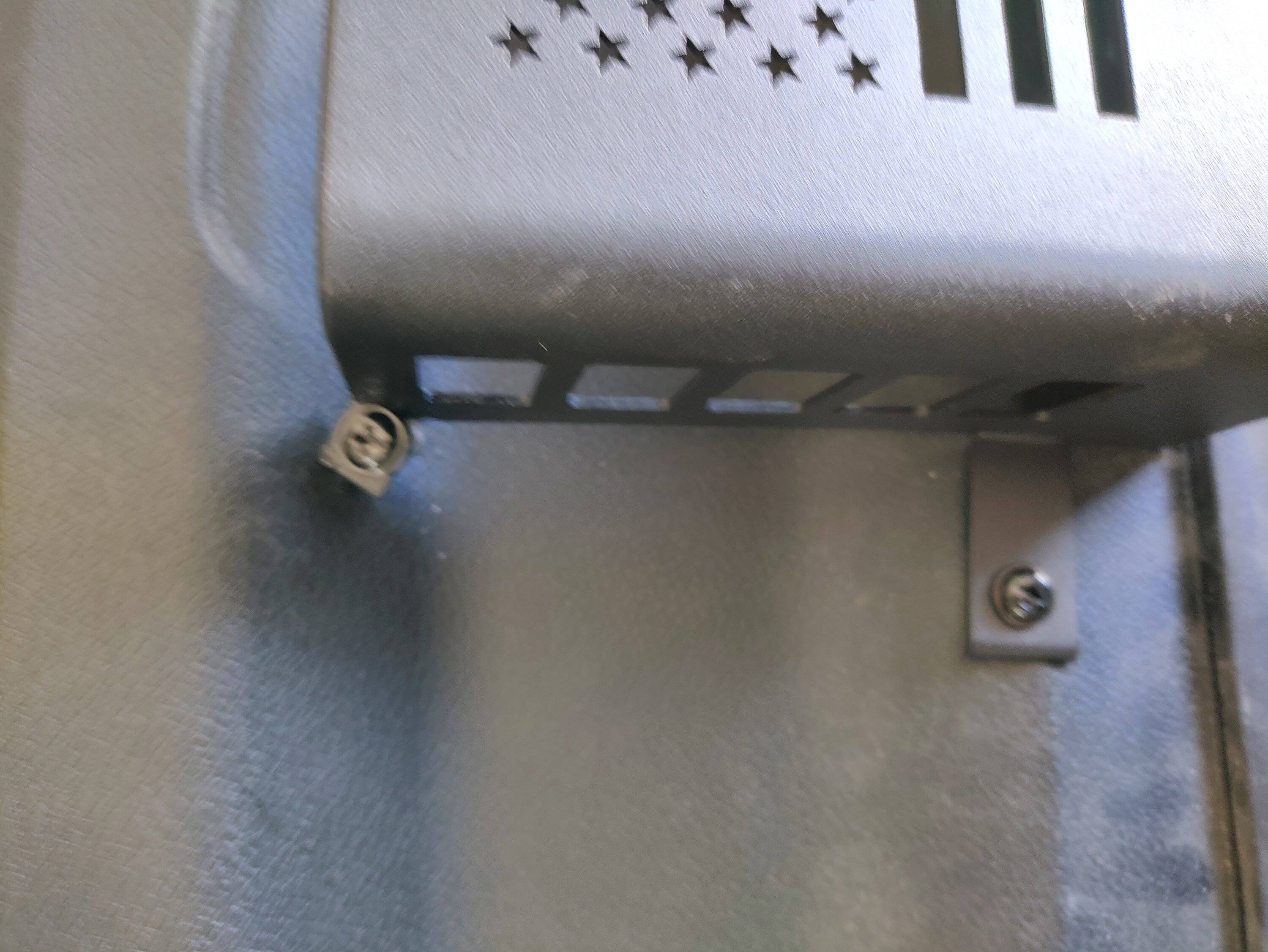

Because it is aluminum I put some truck bed liner on the exposed metal from the holes I drilled into the tabs that didn't originally have holes and from the pieces of aluminum that I cut so there weren't any tabs getting in my way.
This top tab been a little bit when I screwed it in all the way, but not a huge problem.

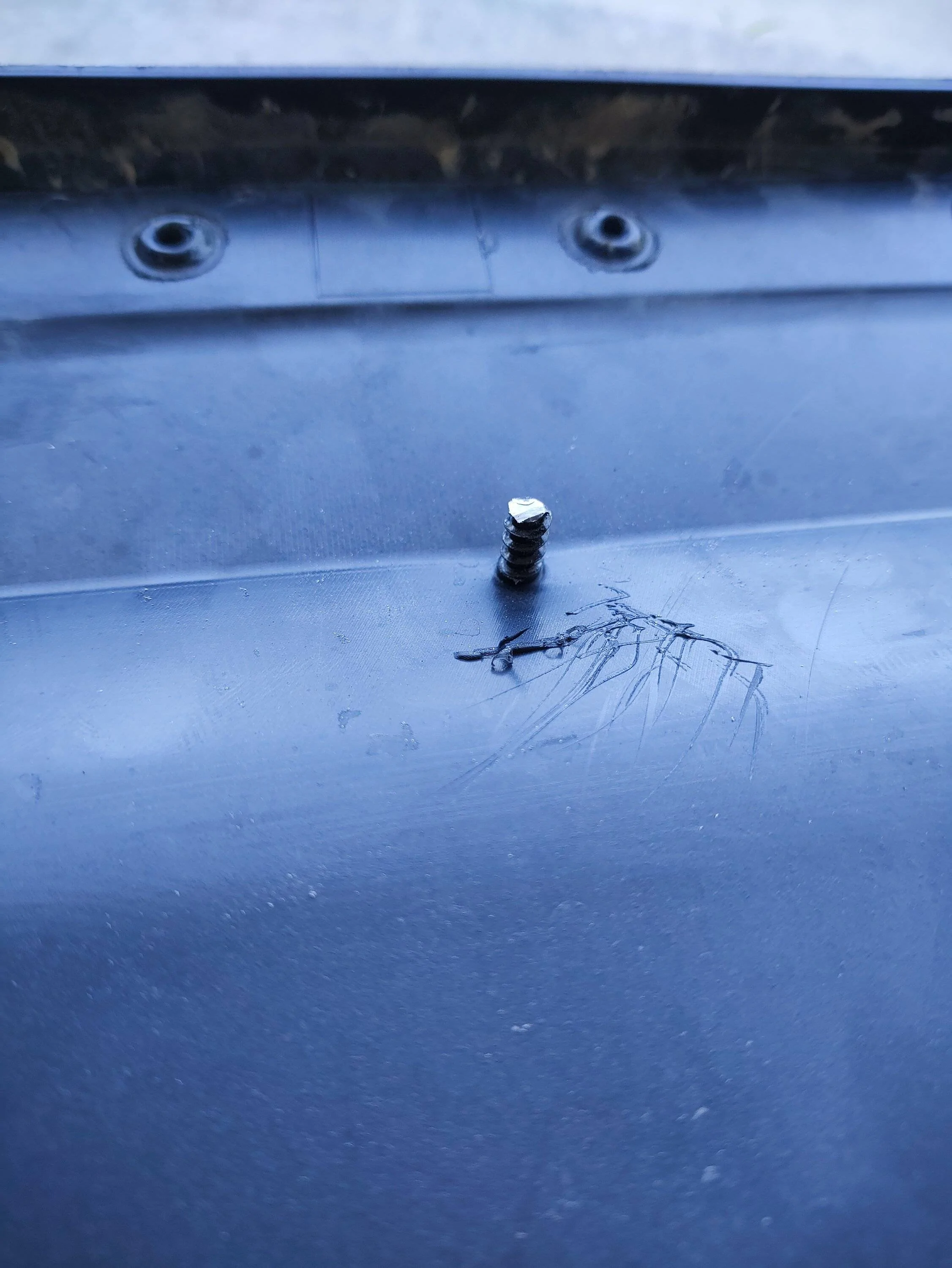

I trimmed the three screws on the opposite side, and then I truck bed linered them as well so they wouldn't oxidize.
I put the panel back on the door, put the door back on the Jeep, and now we're having a good time!!
It sticks out quite a bit so I shouldn't have any trouble getting stuff into it, or out of it for that matter. I barely use that little area for anything other than trash or receipts which I throw away the second I get home anyways. But it's kind of nice. And it's patriotic even though it's probably made in China! But hey, what's more American than outsourcing!! :captain:
Now that I got the driver side done, it'll be a lot easier to get the wife's side completed. Honestly I don't think I'm even going to have to take the panel off of the door. Project for another day though on that one...

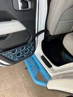

Bought these…. Extra cup holders
Amazon.ca…. Probably cheaper in the states.
If you had a manual, does this get in the way of your left leg?
