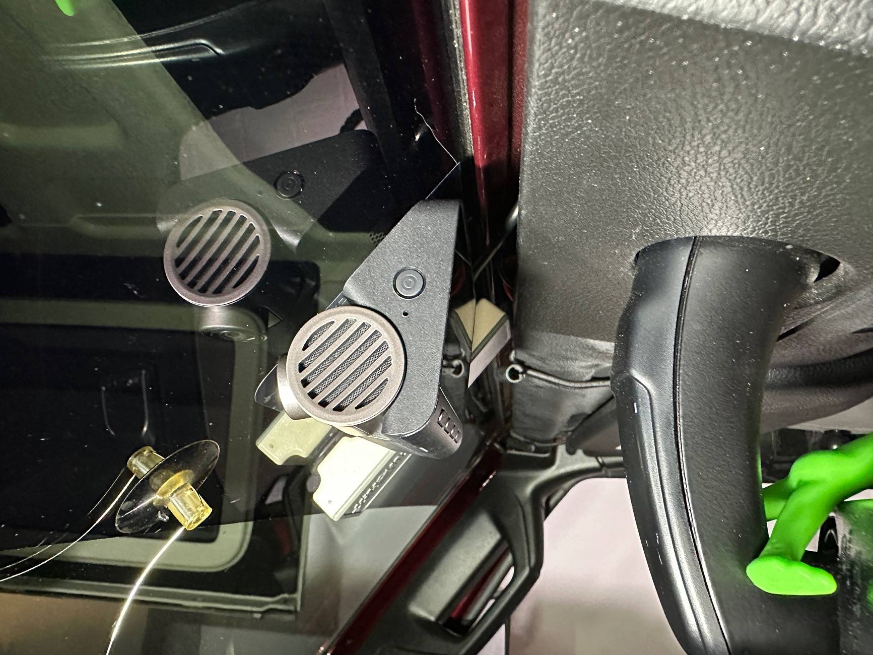

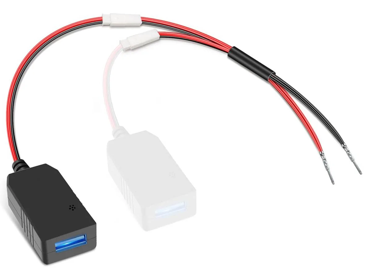

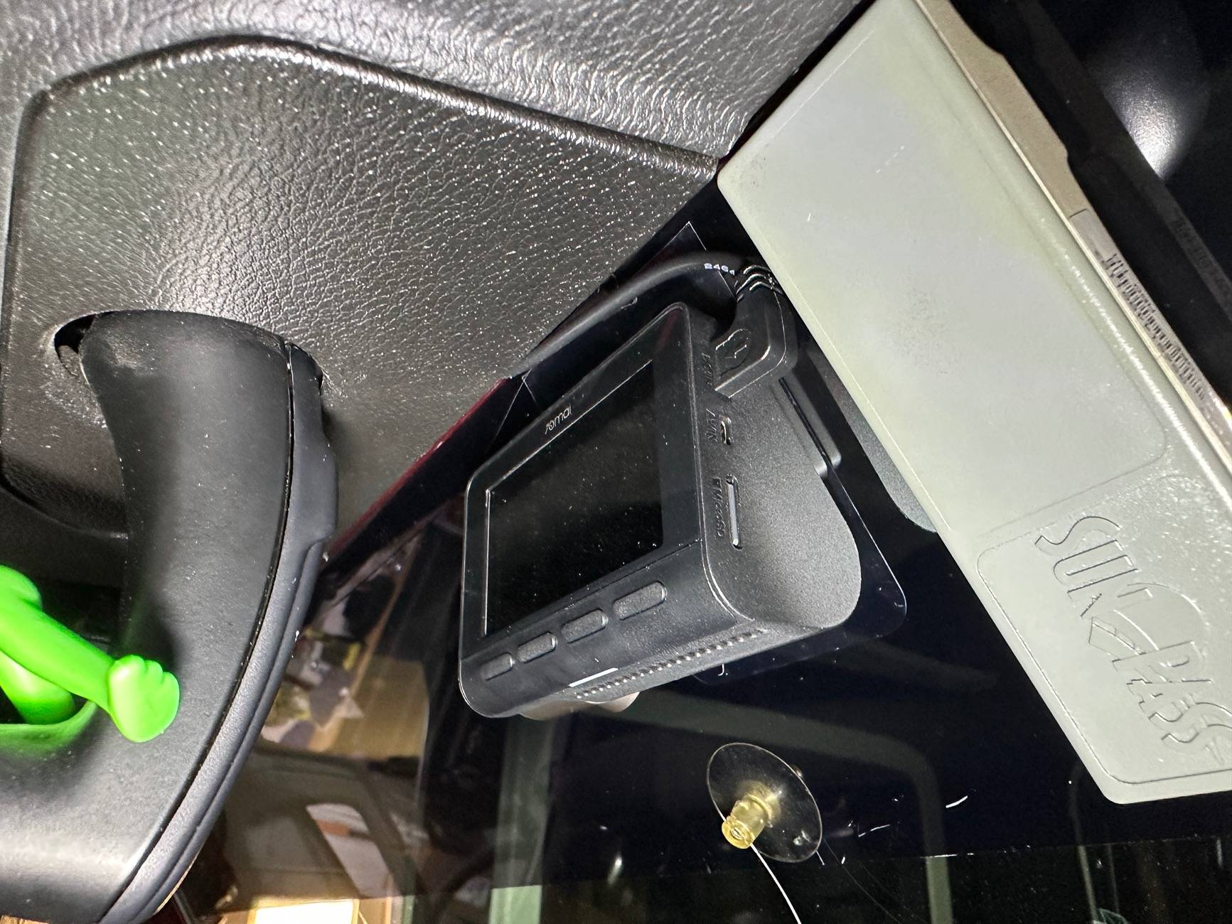

Hardwired the Dashcam today.
Had reached out to dongar and they told me they don’t have a model compatible with JL.
I don’t want to run an adapter to the battery and mess with fuses so I tapped into the power in my rearview mirror. I don’t have adaptive cruise, just a regular mirror.
Here’s what I used. It was a little tricky but it works and the wires are hidden away.
Hope this helps if you are trying to power your Dashcam.
https://a.co/d/aVYVayo

I was going to tap into that (and still might depending on if this adapter lasts) but since I need the 5 volts I didn’t want to mess with cable management of the other hardwire adapters.

Were you really able to just push the ends into a wiring harness? Any pics by chance?

Looks good - nice and clean! I'm gonna give this a shot, hopefully this weekend.
