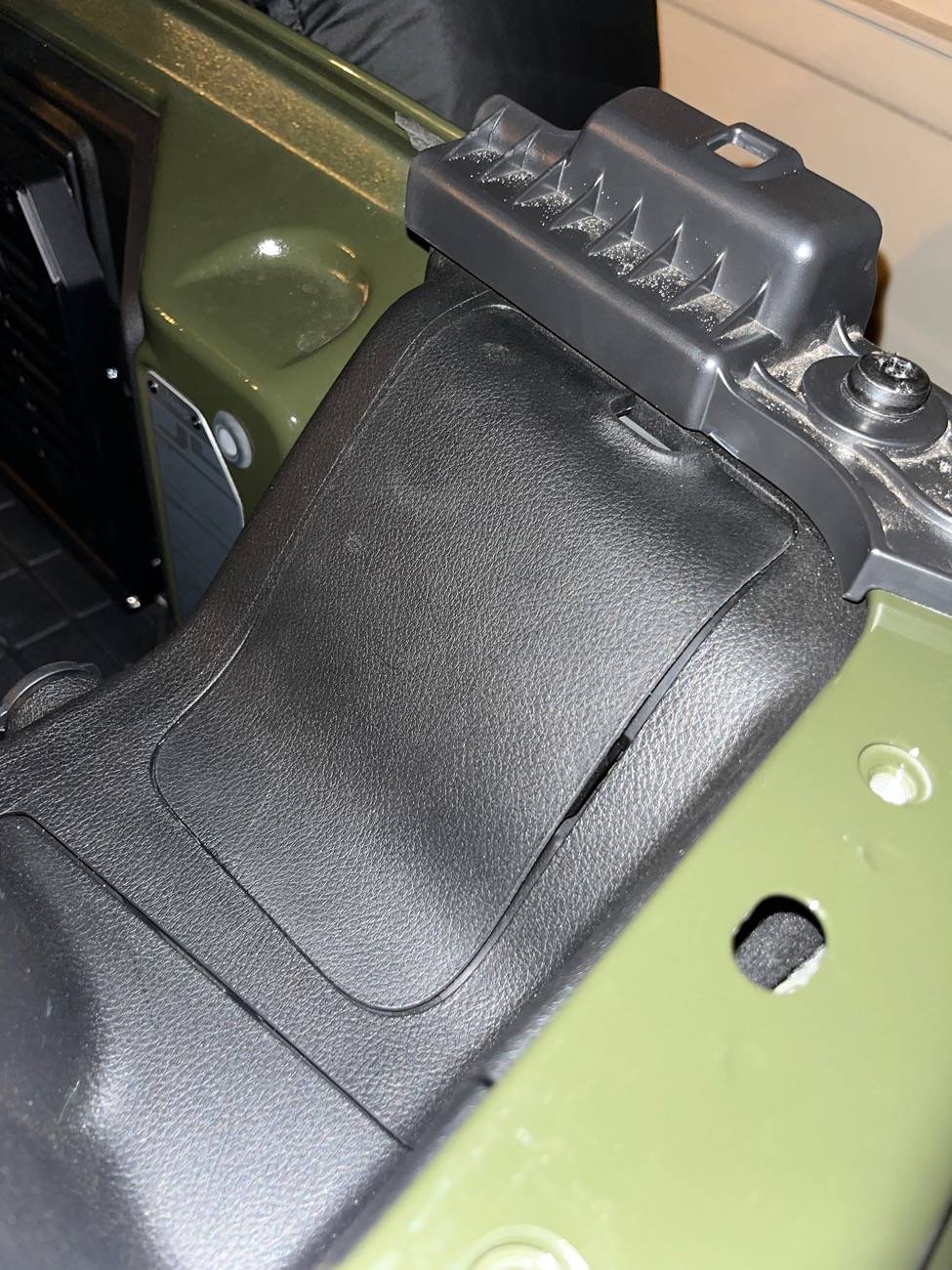

Couldn’t find much on this and maybe it’s a silly question. I took my hardtop off for the first time. I disconnected the wire harness and washer fluid supply tube. My question is storing it. I have a 2024 and there was a small acess panel where these came from. I pulled the little panel and looks like it is for storing them, but the space is tight. I had to coil the wire very tight and still could barely get the panel back on and sticks out where I couldn’t get the wire harness flat enough. Wondering if I should be doing this or just leave them above the panel loose? Just worried I have it wrapped to tight.

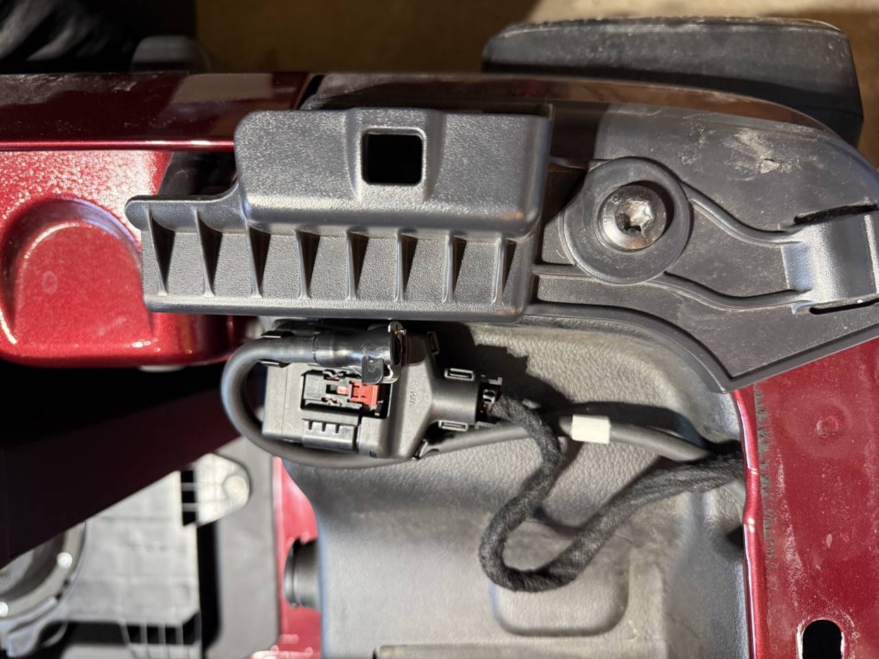

Jeep Wrangler JL Hardtop wire harness storage question IMG_5609 Lar
This is what looks like on my 21. I kinda wish it wasn't out in the open, but it is. I'm guessing that the connections are the same for you. The washer hose is "self-sealing". To hold it in place, there is that little "U-clip" about 1" from the end. Maybe there is something similar under your cover...

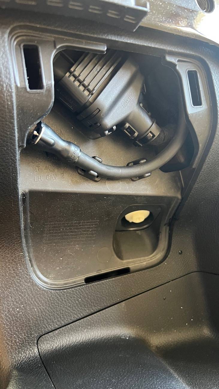

I just took my hardtop off today for the season. On my ‘24, there are retainer clips for the washer tube and a female connector for the wiring. I was able to push the cables back in a bit into the recess they are routed from, and then the ends just clipped into their retainers.
Jeep Wrangler JL Hardtop wire harness storage question IMG_7744

Thanks for the responses and pic. That looks much neater than how I shoved them in. Maybe the trick is trying to push them back in a bit as you mention. Ill give that a try to make a bit more room.

That looks to be a revision on the ‘24. I have a ‘22 with the female dummy plug too and it keeps getting knocked out when I put the soft top up unless I think about it. Like that newer option.
