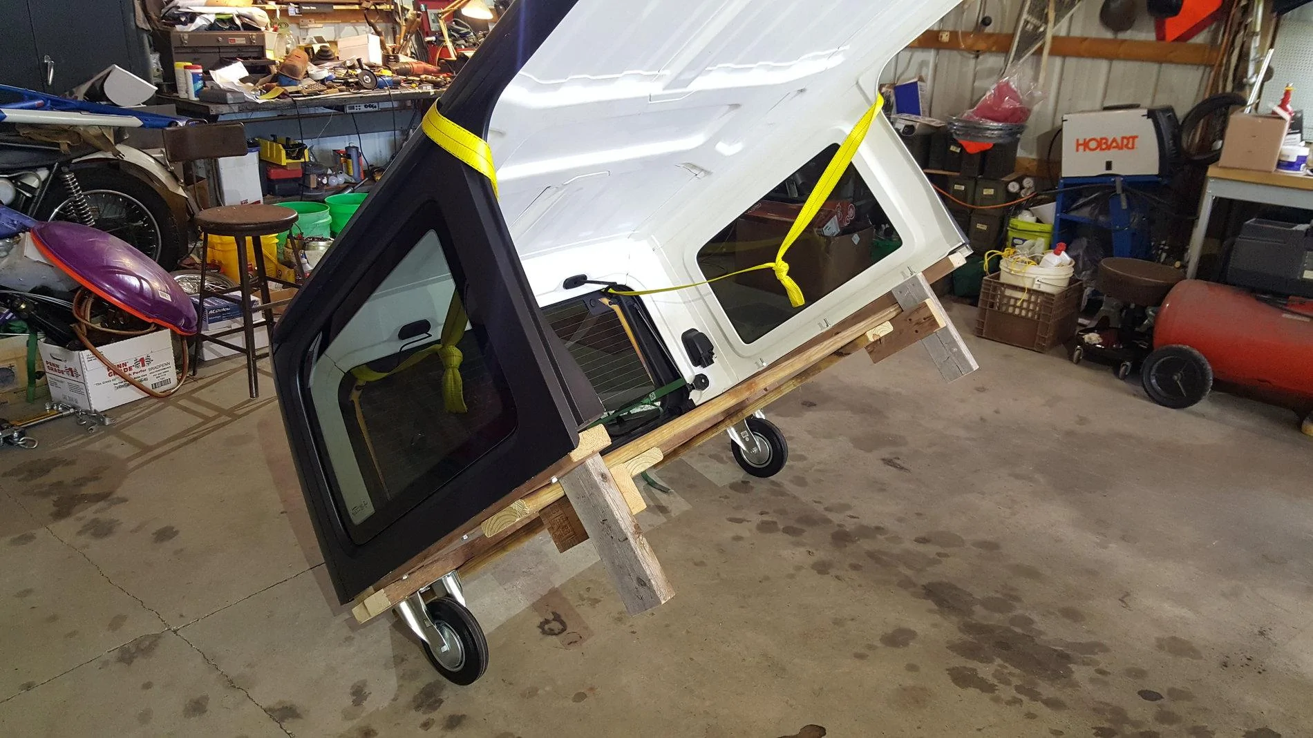

I built a wood cradle with wheels that i bolt mine to. Once on it I can wheel it around wherever. The cradle has short legs to lift it up when I stand it up. The rear window needs to be tied down to keep it closed.... Tom

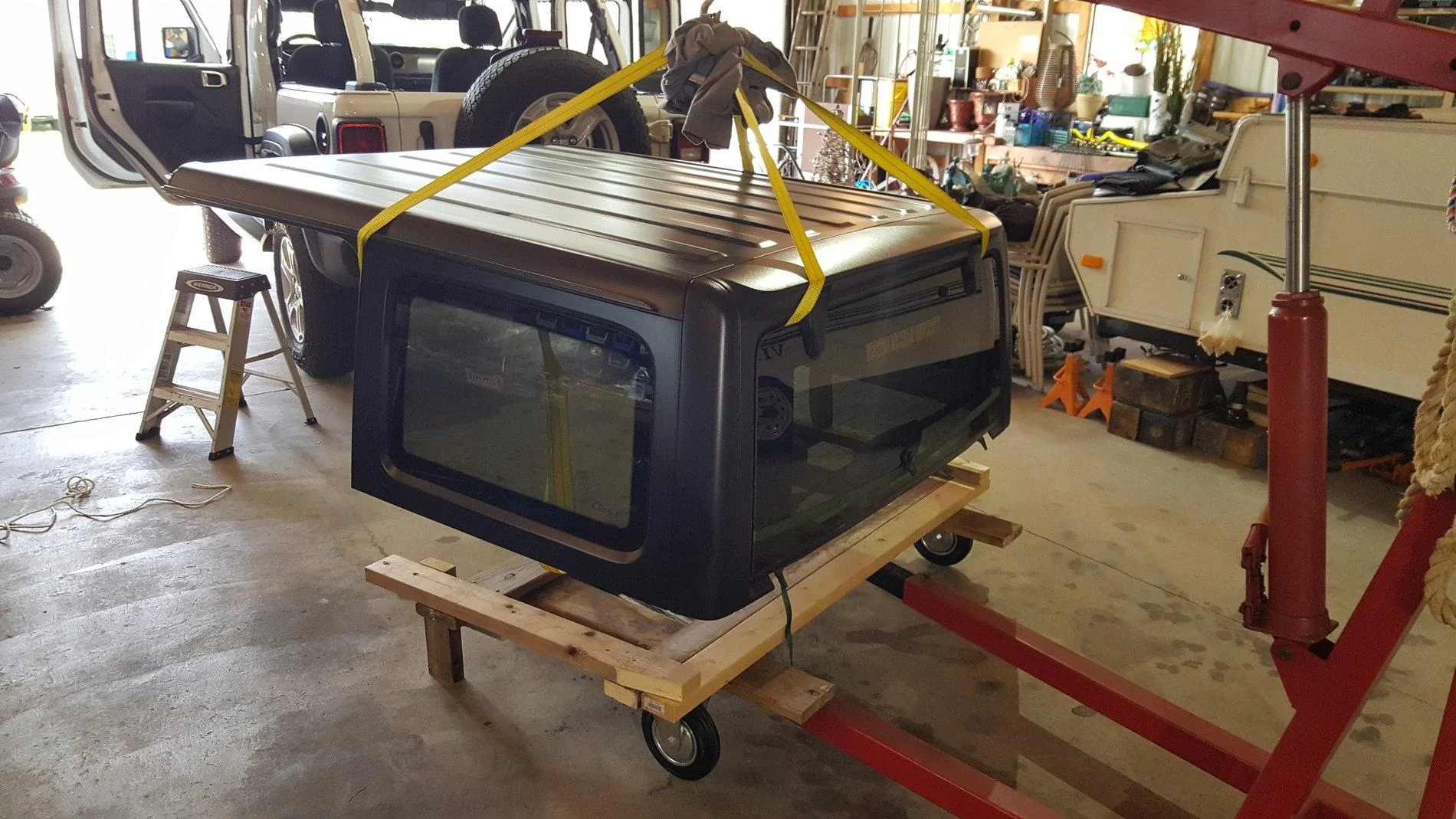

The crane is a long reach engine hoist for pulling engines from cars. It came from northern tool many years ago. I use it to pull engines from cars and boats. Fully extended its rated at 1.5 tons. Does the job...

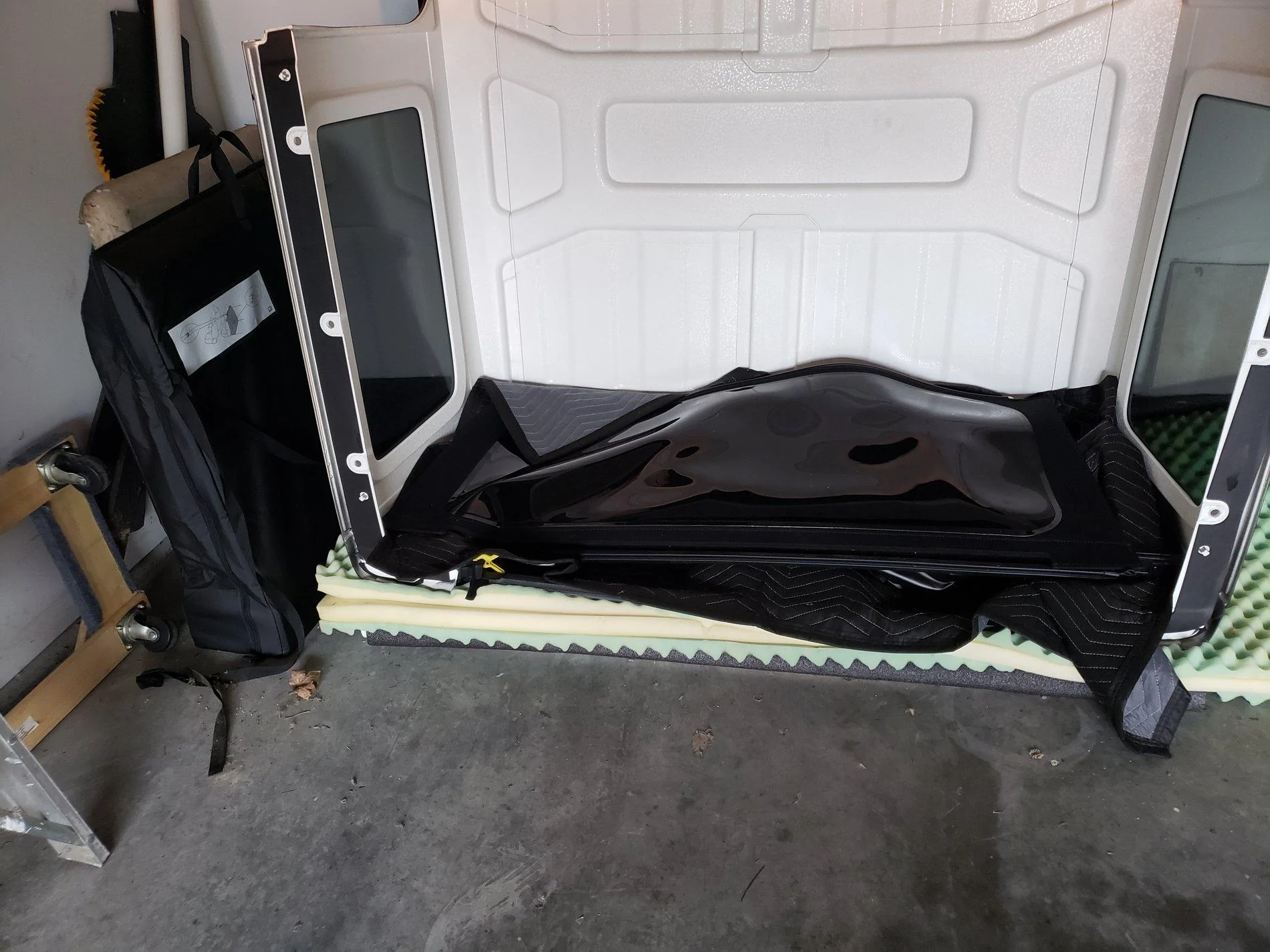

I have mine laying against the wall with the window on the ground. I built a pvc frame that it sits on, then covered the pvc pipe in foam pipe insulation. I added a big a big foam sleeping pad it sits on as well. I have a soft top that I have on during the summer, so it will only be moved twice a year. I’ve only had my Jeep for three weeks, but it seems to be working well. When I take my soft top windows off, I put the rear window inside the hard top.

It's sitting on top of a 1 1/2" pvc frame that is covered in foam(you just can't see it)plus the foam padding you can see. It's very sturdy, it's not going anywhere. My soft top rear window is sitting on top of it.
