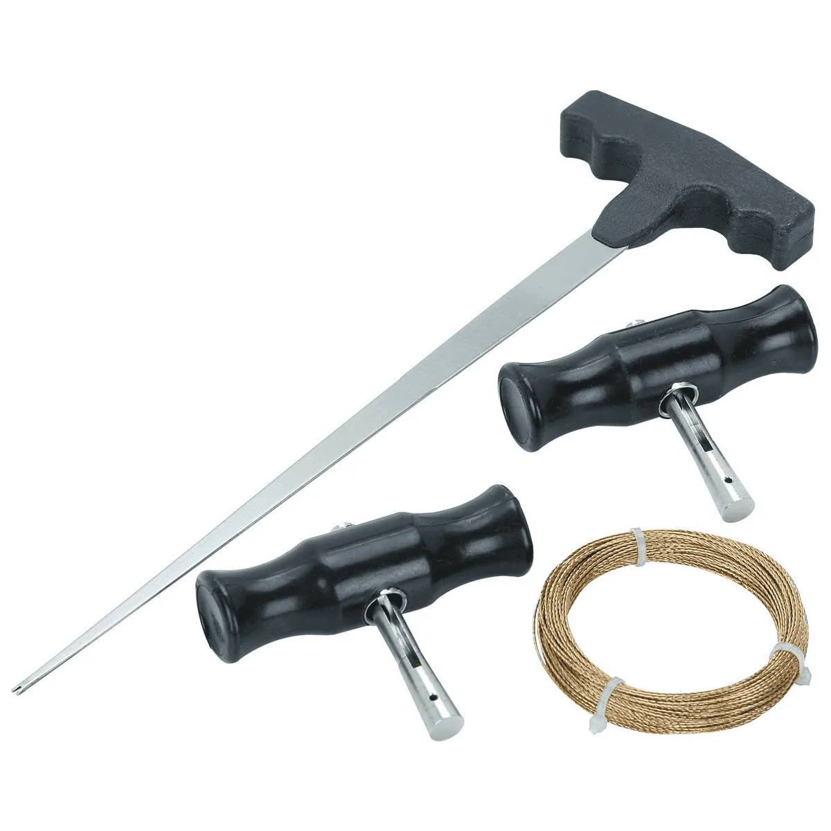

Step 1: Cut out your back glass with a windshield removal tool (harbor freight).
Jeep Wrangler JL Hardtop removable side glass!  Probably totally safe, maybe! 1710785480125-95
This is a giant pain in the ass, needs two people, and you gotta be really careful not to cut into the fiberglass on your top as you're doing it. I'm no expert and managed to do it with my 12-year-old daughter's assistance.

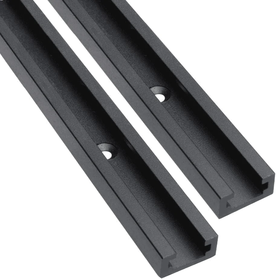

Step 3: Get some t-track (amazon) and cut to size:
Jeep Wrangler JL Hardtop removable side glass!  Probably totally safe, maybe! 1710785959707-tr

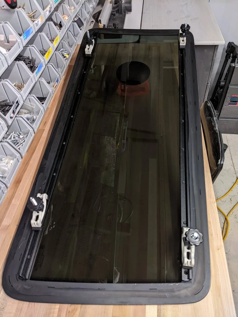

Step 4: Glue it to the glass you cut out on the inside of the glass, just inside of the blackout area.
Jeep Wrangler JL Hardtop removable side glass!  Probably totally safe, maybe! jeep_glass_hardwar

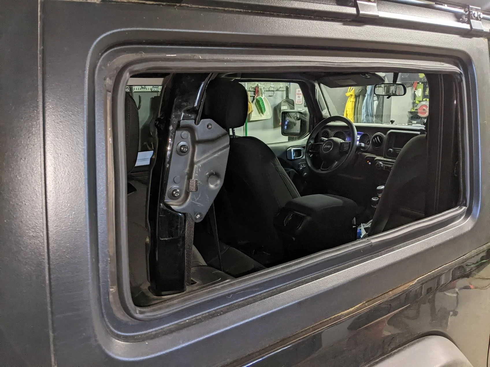

Add pinch weld gasket to your window hole:
Jeep Wrangler JL Hardtop removable side glass!  Probably totally safe, maybe! jeep_window_out_outsid
Jeep Wrangler JL Hardtop removable side glass!  Probably totally safe, maybe! jeep_window_out_insid

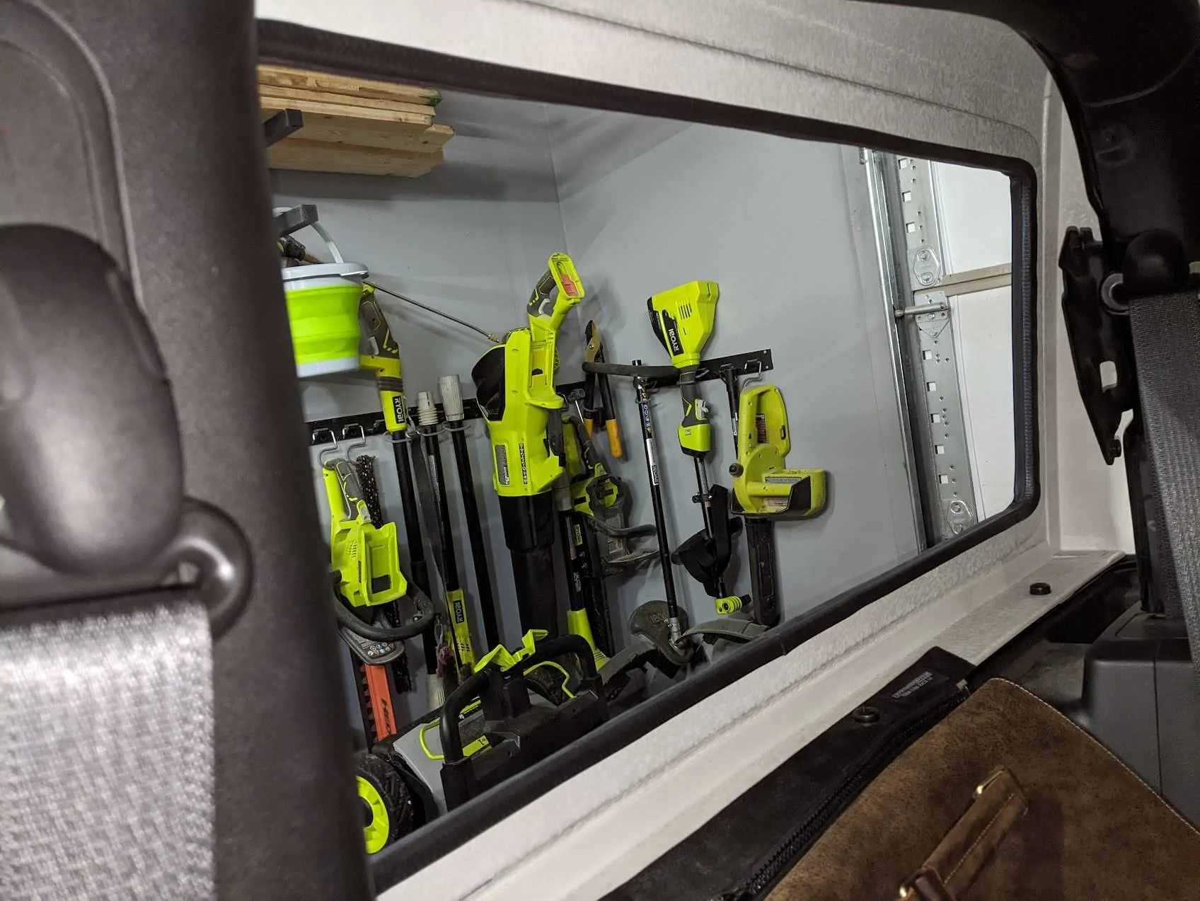

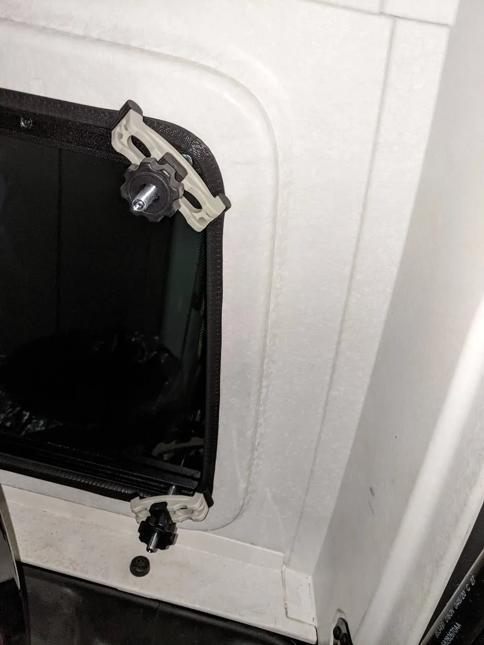

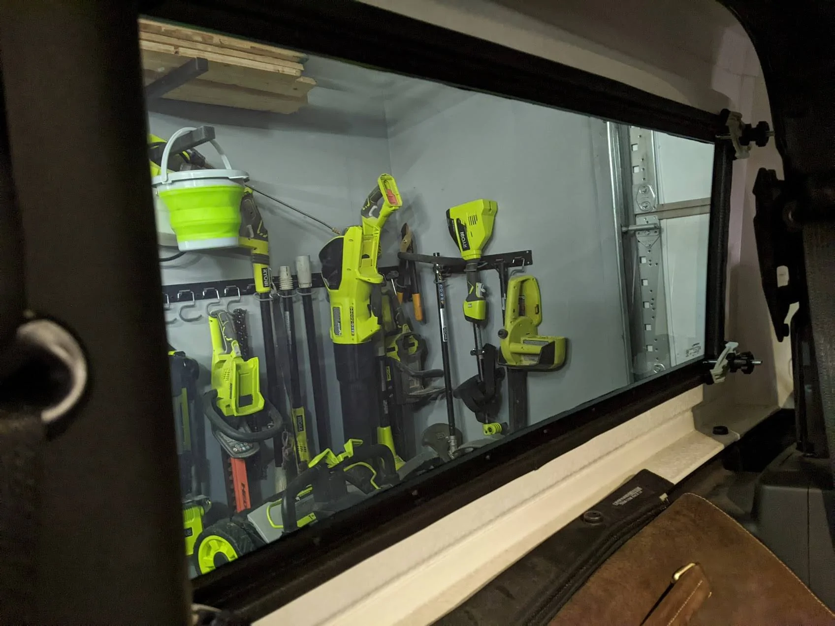

Add t-track clamps (amazon) to your t-track and clamp the window back on:
Jeep Wrangler JL Hardtop removable side glass!  Probably totally safe, maybe! jeep_glass_in_place_inside_1
Jeep Wrangler JL Hardtop removable side glass!  Probably totally safe, maybe! jeep_glass_hardware_in_place_detail2

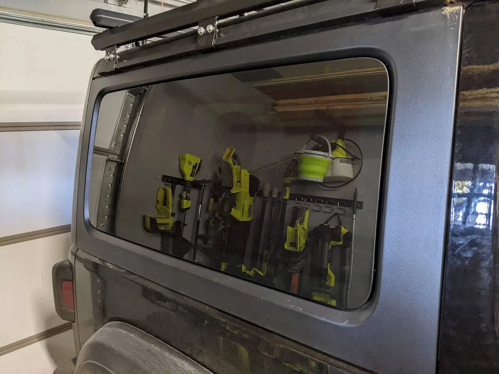

And it probably, totally, won't fall out!
Jeep Wrangler JL Hardtop removable side glass!  Probably totally safe, maybe! jeep_glass_in_place_outsid
Two people and at least one of those glass suction cup handles would be smart.

I was worried about that a bit too, but it hasn't been a problem so far. I thought about adding a bit of locktite on the bolt for added piece of mind. The gasket adds a bit of springiness and I think absorbs some of that "shake it loose" vibration. I checked it a few times in the first couple of weeks and then not again until today and it hadn't backed out at all.
I'd love to adapt some proper latch hardware, but that would likely take some actual engineering. The great thing about this setup is.... I can just scrape those t-tracks off the glass with a razor blade and glue the window back on and it's like it never happened!
