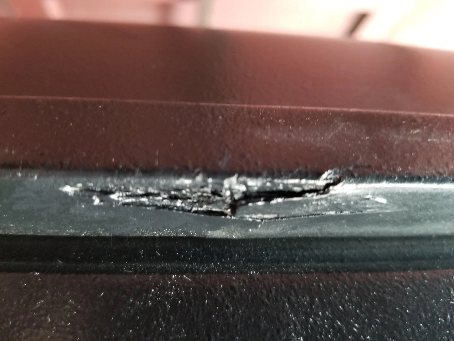

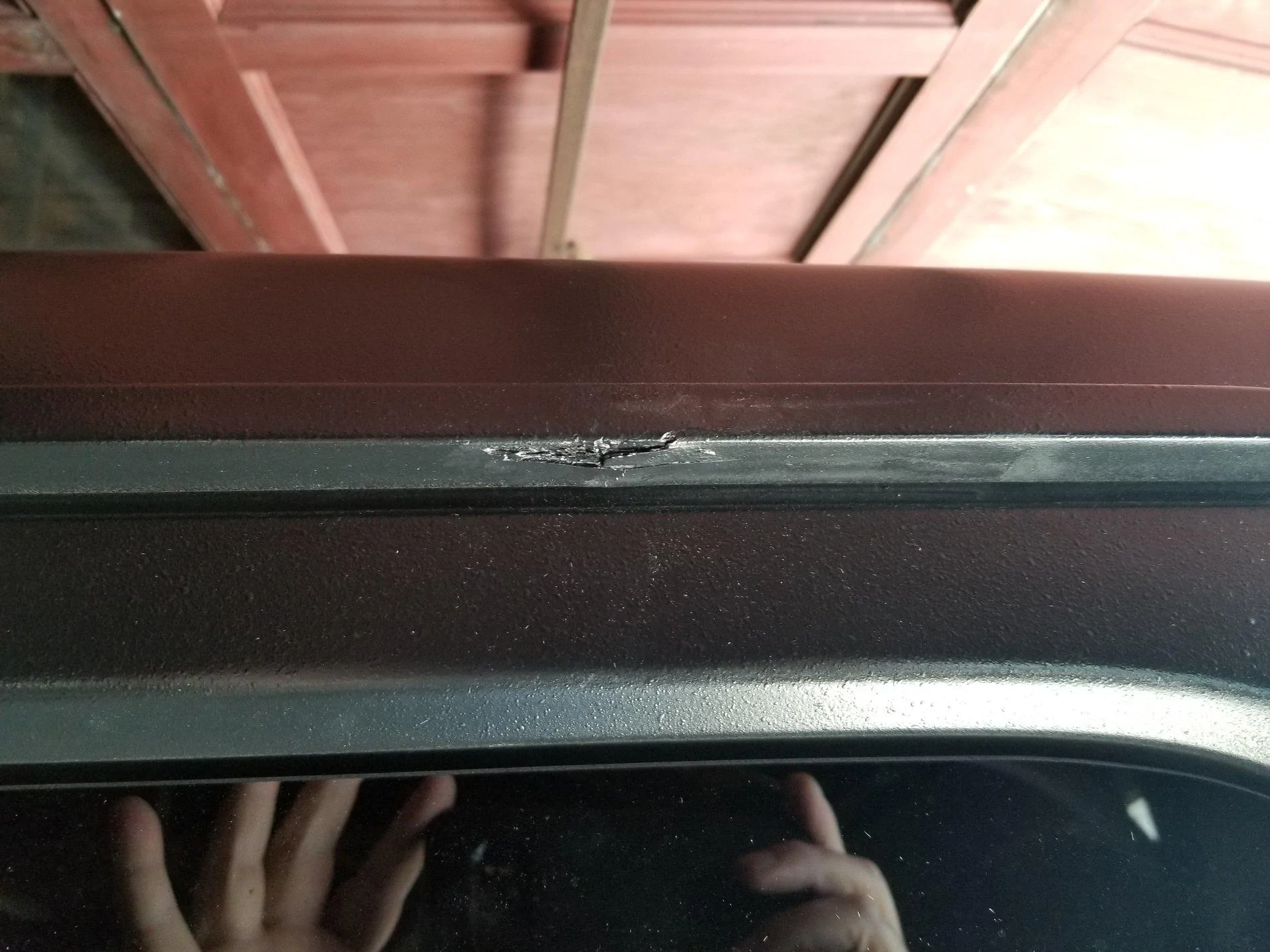

Yesterday I forgot to open my garage door far enough to clear roof cross bars and damaged my hardtop at the drip rail...it broke a small section out about a 1/4" × 1 1/2"....
Does anyone know of any way to repair this?..ie a repair kit or filler

Remove any pieces of fiberglass that are frayed or splintered. Clean the hole with rubbing alcohol, then fill it with 5 minute epoxy. It may ooze our due to gravity so you might want to use multiple applications of epoxy. You’ll want to build a little mound of epoxy that is higher than the surrounding fiberglass. Once cured, use a sharp new razor blade (not a box cutter blade - too thick) to level the epoxy. You can also sand it, just be careful to not damage the surrounding paint.
Once it’s smooth and level to the touch you can paint it with Mopar touch-up spray made for the black textured tops.

A Dremel with the right attachment works great .

The epoxy repair suggestions are good. You can also take it to a body shop if your not confident. They do repairs like that all the time. I don't think it will cost much.
