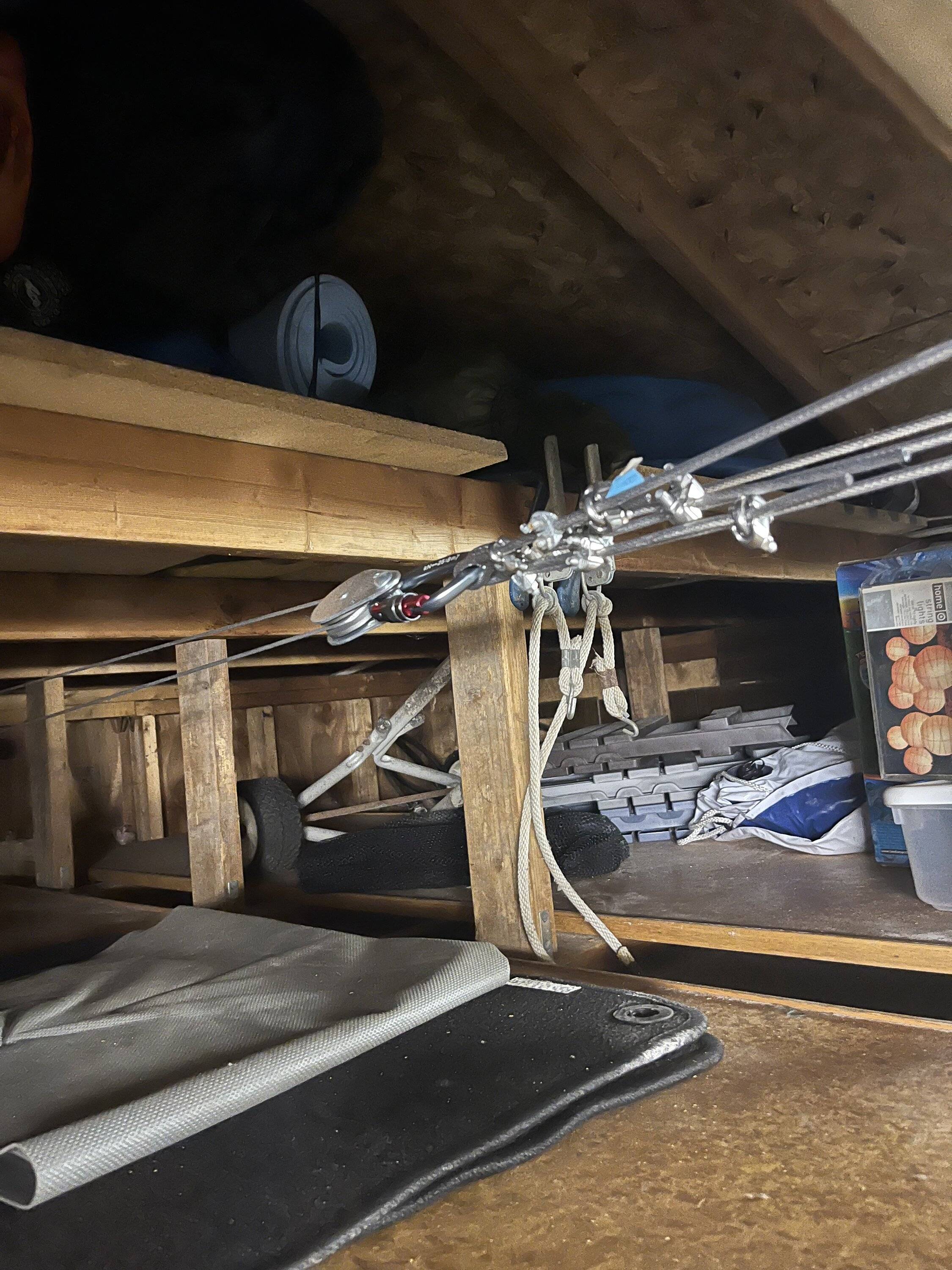

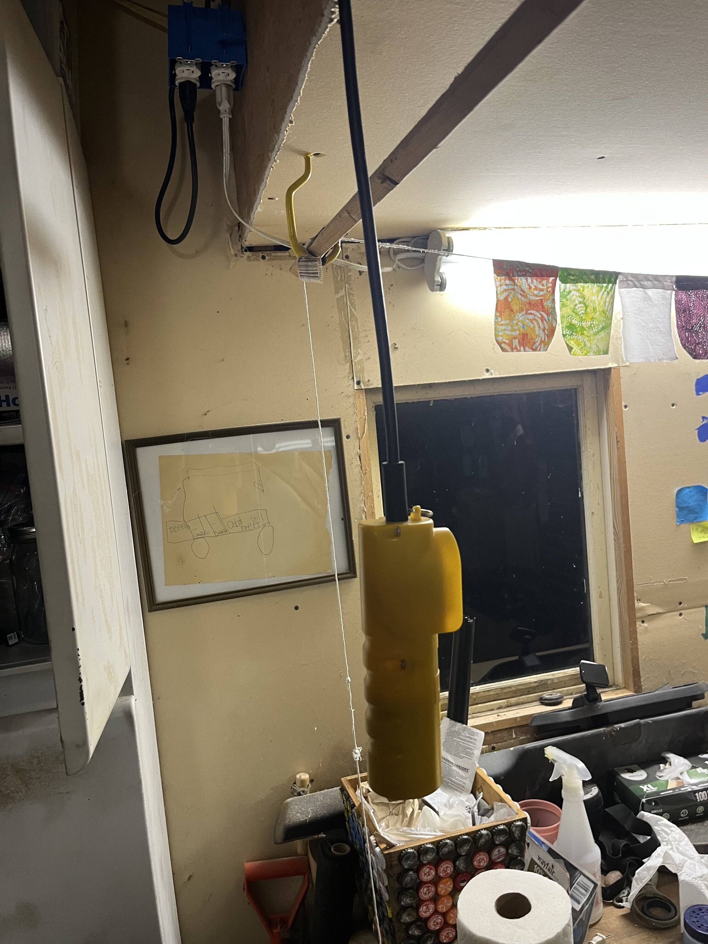

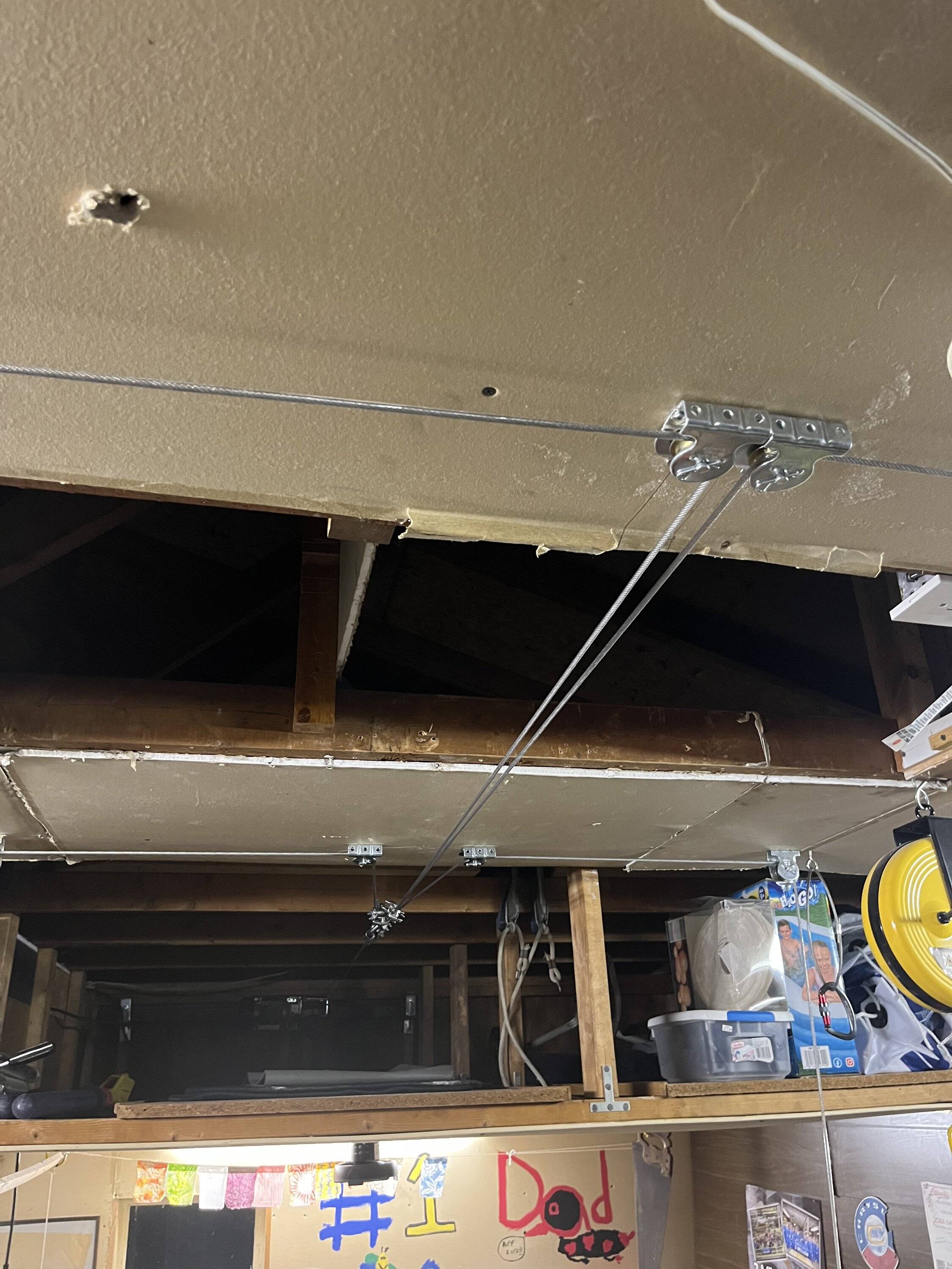

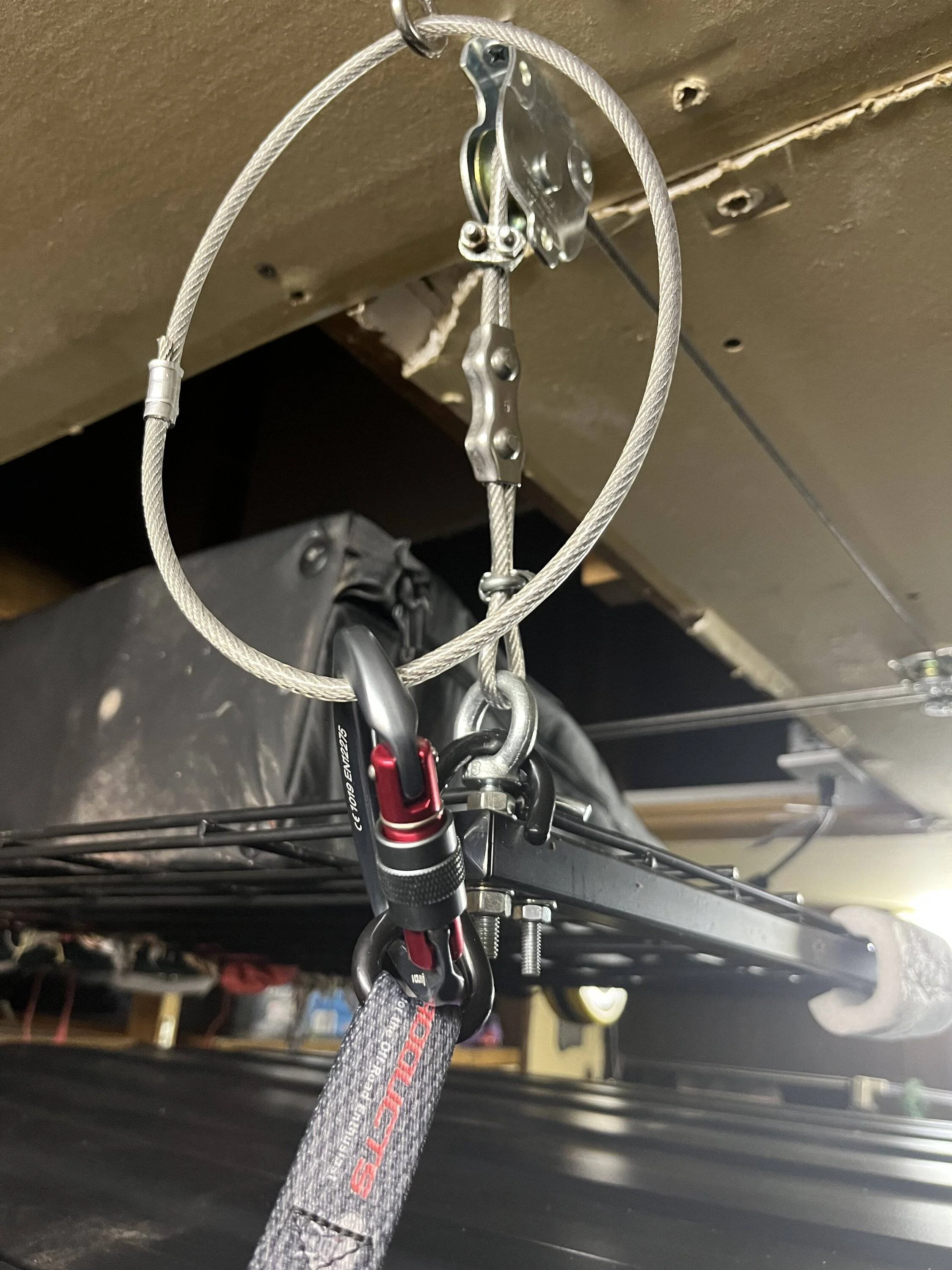

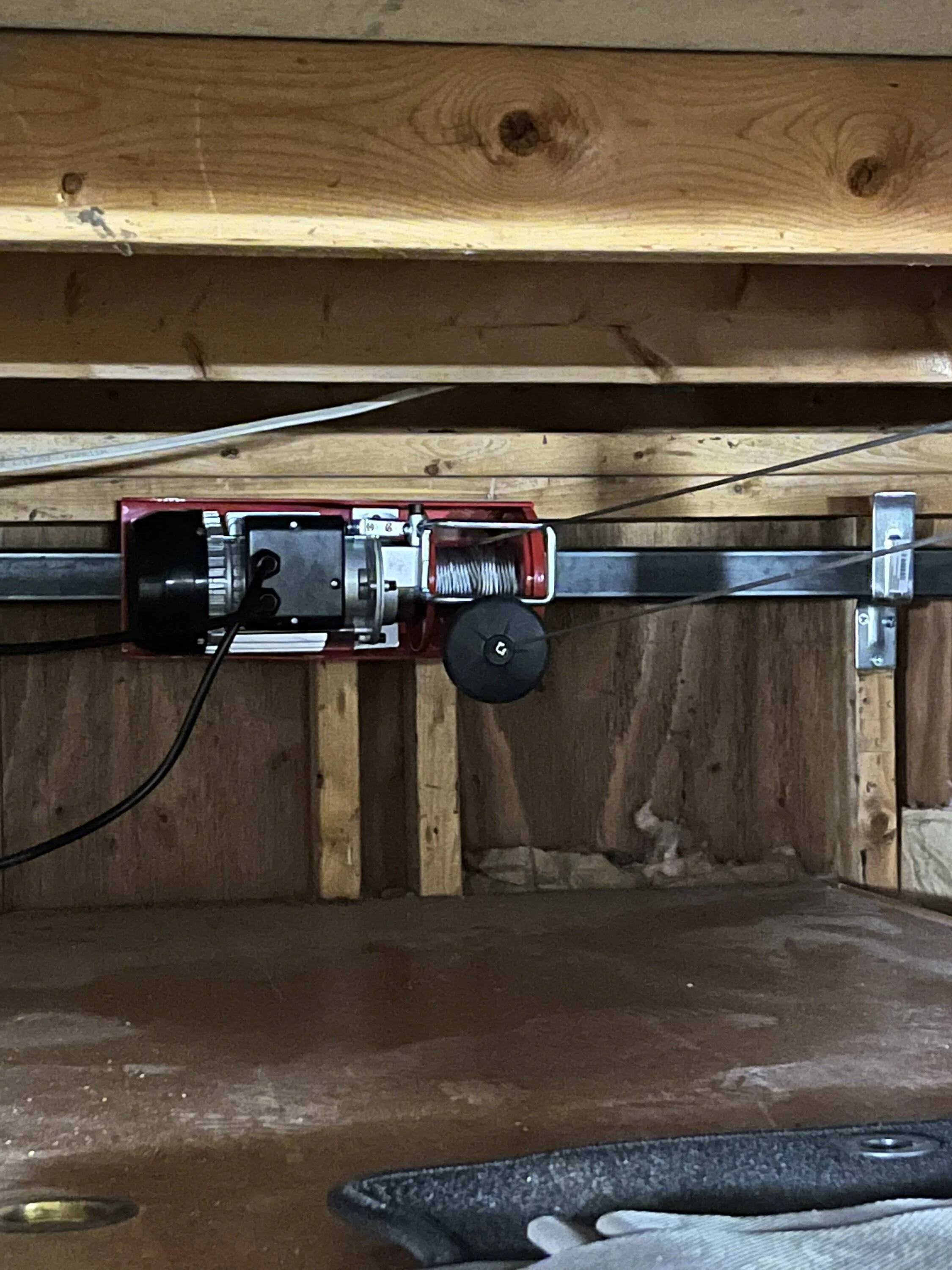

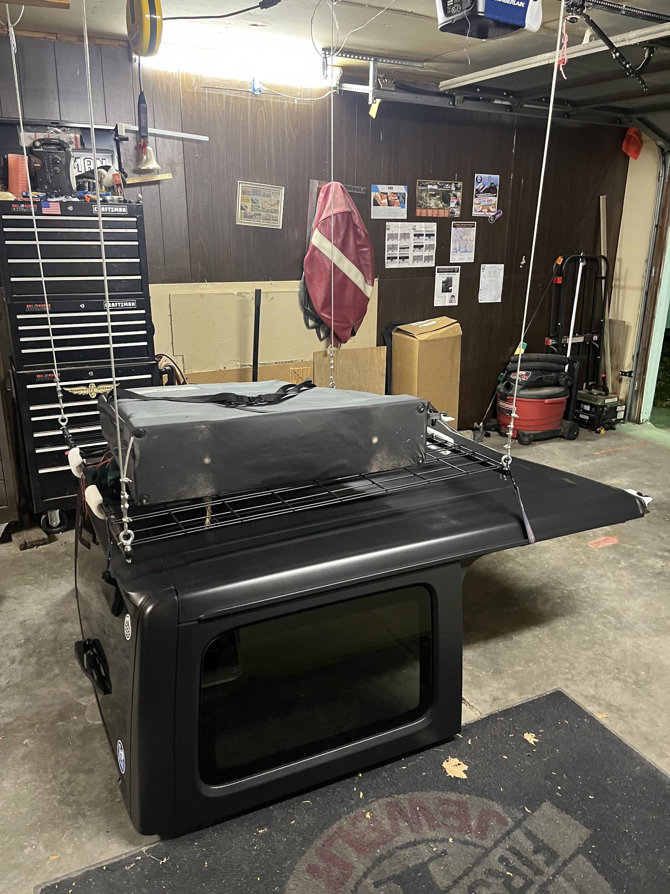

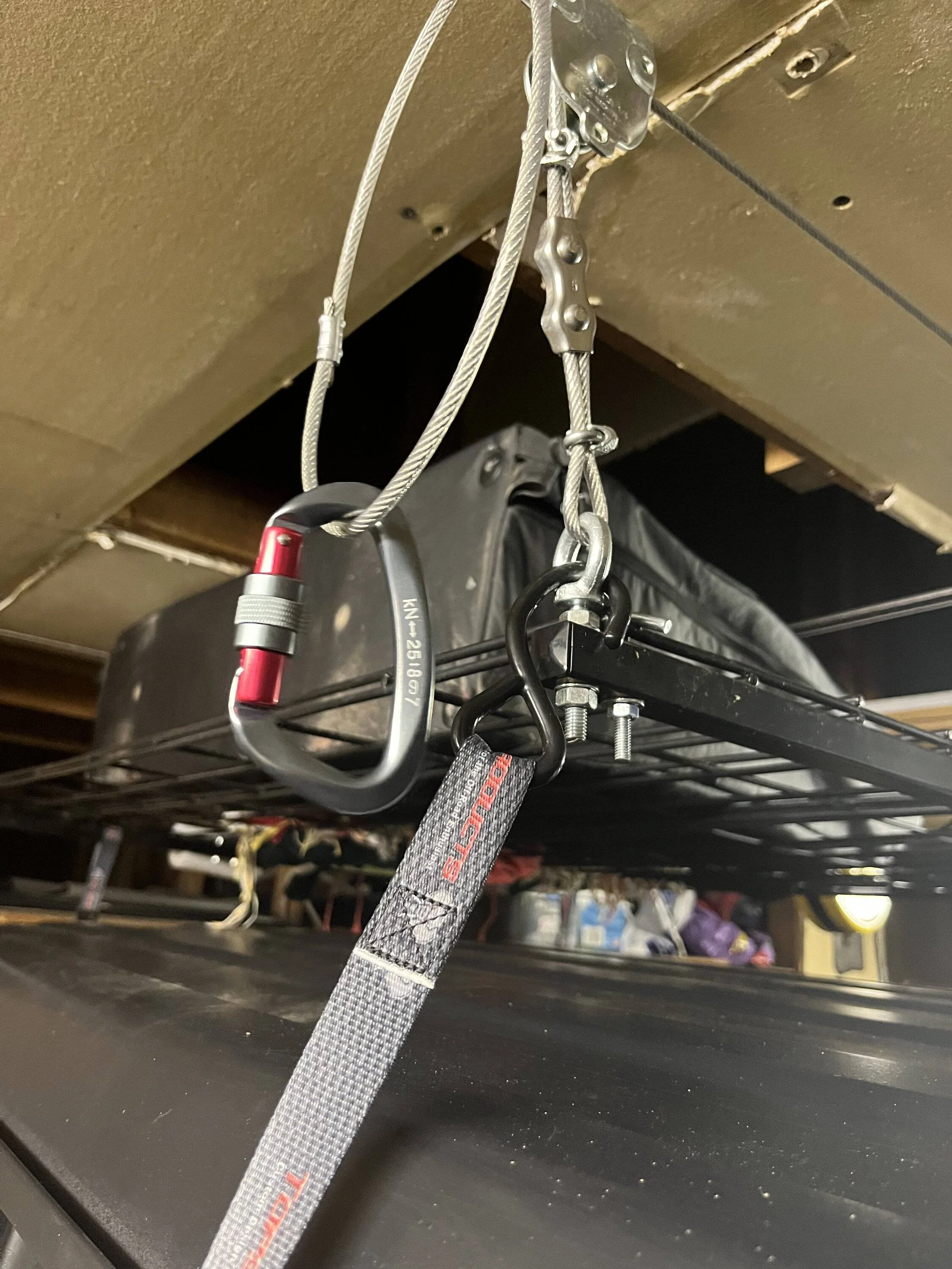

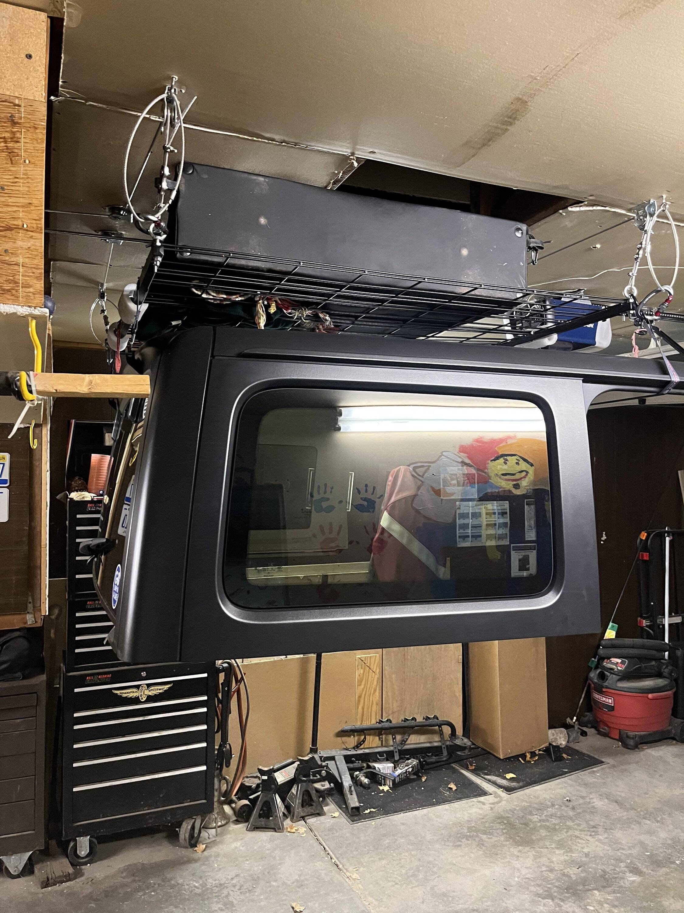

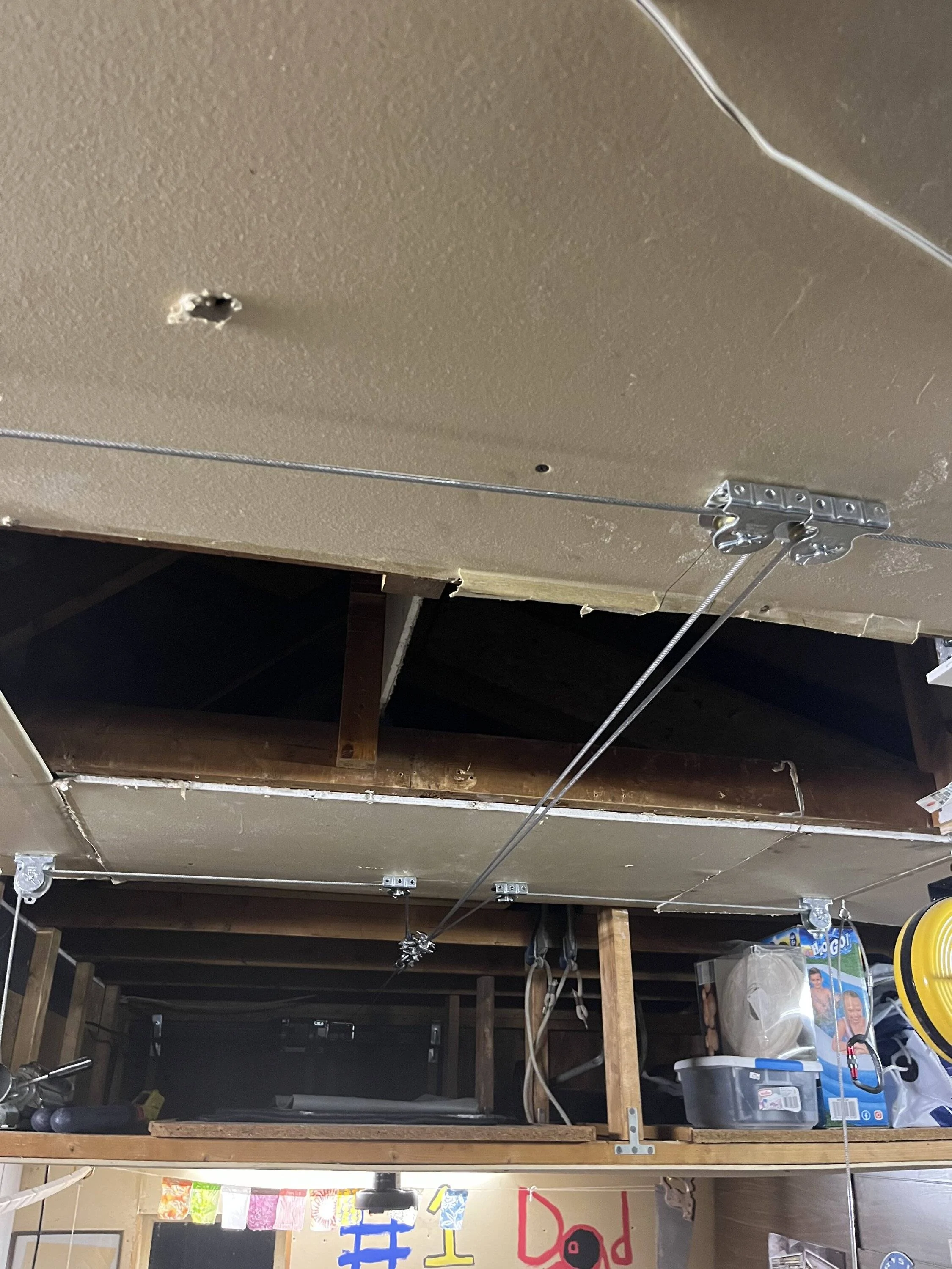

Wanted to share what I was able to do to get a hardtop hoist mounted and working. I looked for ideas all over the place as I was coming up with what worked for me. Let me know if you have suggestions or questions.
