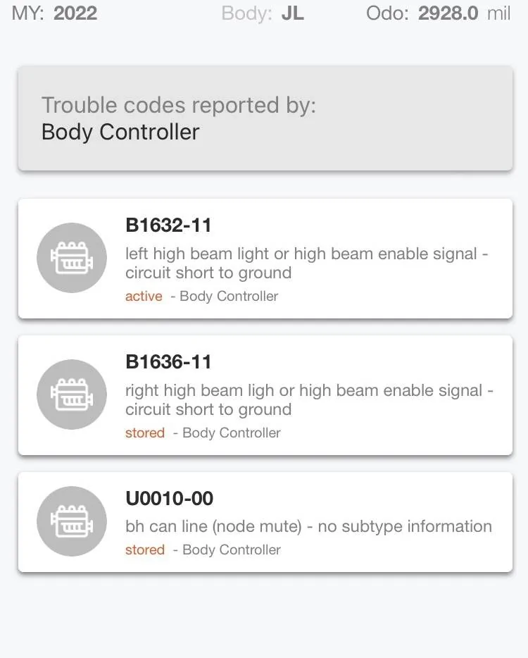

For the life of me, I can’t find how to turn on the halos for DRLs!
I just installed Mopar OEM LED headlights on my 2022 Willys Sport (came with halogens) and not only can’t I turn on the Halos but the lights are all over the place when going to high beams, turning on fog lights; at times only the right side headlight is on.
Using JScan app with a 4.0 Vgate OBD2 Reader, and a Chrysler 12+8 cable adapter. And I managed to generate these error codes while trying. Help please.

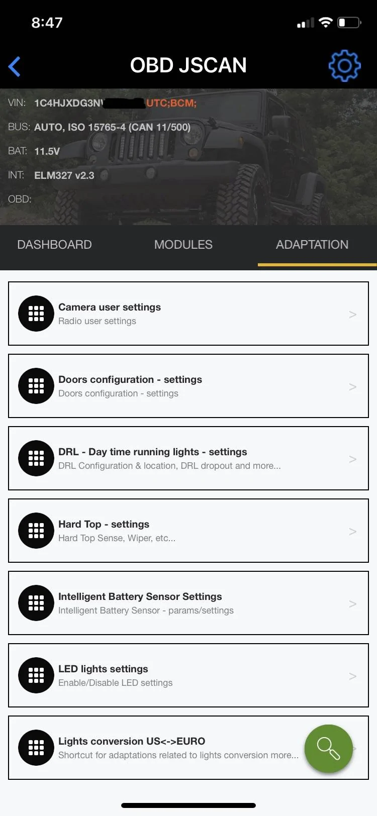

Thank you for your input! I think that from 2021 onward the fourth wire is included. I looked at the plug for the headlight wire bundle and I saw 4 pins. I may be wrong though. I also don’t have DRLs anywhere. It’s a stock Sport with the Willy’s option. All halogen.
I think I did what you´re suggesting on JScan. Let me look and I’ll add a photo of the menu option.

So I was able to activate these with JScan. This is for Mopar OEM LED headlights only. I have a 2022 Willys Sport and the 4th wire is installed. It‘s actually included in all Sport models 2021 and onward. These are the settings I activated using JScan, and in the following order:
LED Settings:
1. LED Low Beam
2. LED High Beam
DRL Settings:
3. Signature Lamps or Mirror Repeater Present - Pin A5 & Pin A7 (Halo)
4. Signature Light Present Present On/Off
Here’s the threat where I found these steps:
https://www.jlwranglerforums.com/forum/threads/mopar-led-factory-upgrade-kit.31897/page-35
No more error codes
